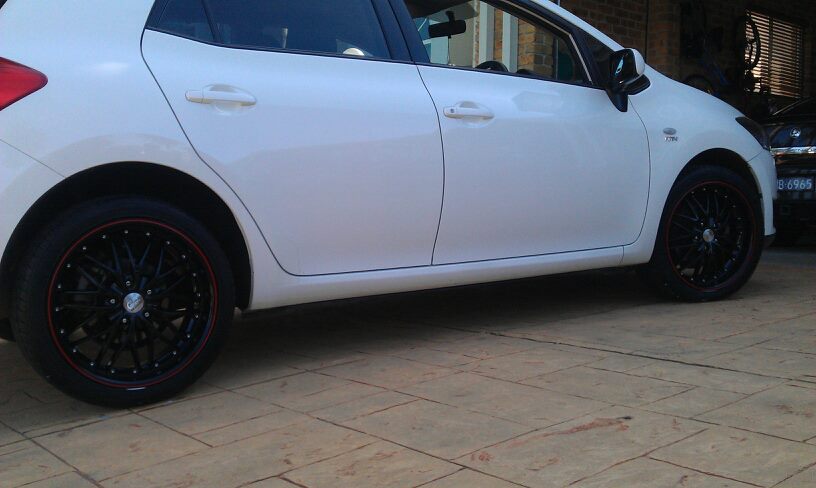

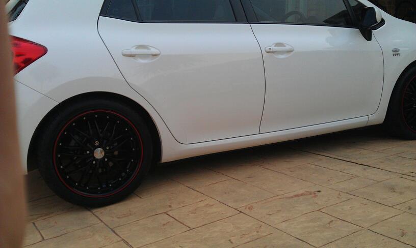

I had my rolla put on kings last monday but the problem was apparently kings don't make super lows for 09 zre152's?? and only lows.
Well I got the low which look pretty sweet B) but the back does look like it could be slightly lower!
Any suggestions on this besides coilovers?
I'll get a before & after shot of the car

yeah only lovells springs have superlows front TFL-131SL and back TFL-132SL and their version of lows that u got is front TFL-131 and back TFL-132. i had superlows before and they looked great but had too much scrubbing so i changed them to lows which is pretty much how your drop is looking.
Reset the rears or get Lovells superlow rears to have the car sitting level. :)
