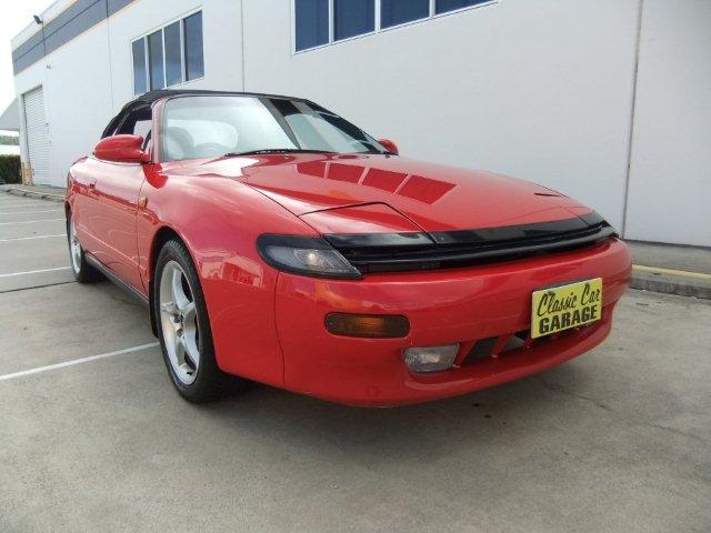

Just bought a 92 ST183c and have just replaced fron wheel bearings and CV's in the front, BUT when going round a corner with foot on accelerator, there is a very loud clunk happening. It will happen sometimes in a straight line but always happens turning corners.
My mechanic thinks the diff is shot, but I was hoping to get some info from this web site.

Are the engine mounts, ball joint and sway bar bushes all good? If not then you may have to start looking at a new box. Is it manual or auto?

Hi - Had one broken engine mount, have not checked sway bar bushes yet.....Found a used box yesterday for $259 at Calpalaba Wreckers yesterday. Its a manual box.
