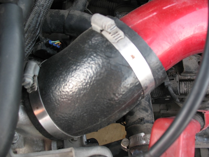

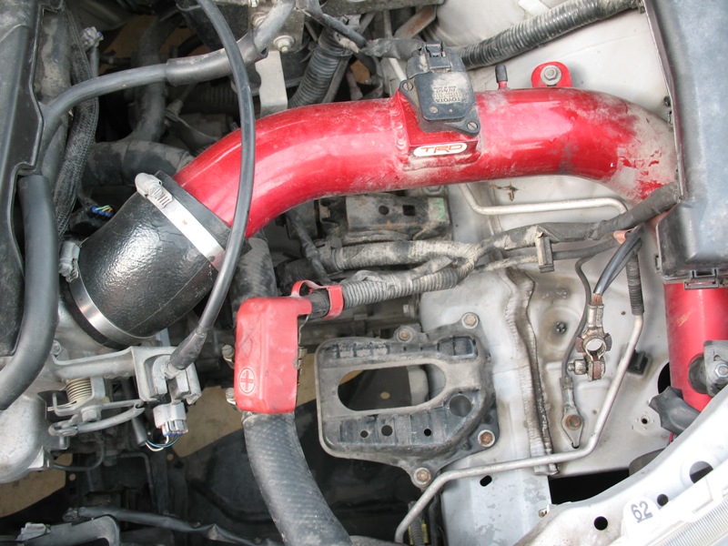

Can anyone advise me as to where I can purchase a rubber coupling for my TRD cold air intake as shown in the attached pictures. I have noticed some small surface cracks on it and I would like to replace it before they get any worse.
All help will be greatly appreciated.

Given the uniqueness of the angle on the hose, I am not able to find on the Internet any straight couplings that will be a direct fit. Additionally, I called TRD USA and they do not sell the coupling separately :(
diameter is the issue as its metric and most of the bends you can get here are imperial. 2.5' is too small and 3' is too big. if you can get something close to 2.75' it may fit you need something that is soft and pliable otherwise it wont seal. 2.75' is not a common size most companies carry in stock. remember it has to be able to be somewhat oil, fuel and heat resistant.

I purchased the Turbosmart 2.75" 45-degree hose, however it was an extremely tight fit. When I measured the outer diameter of my throttle body it was 3" however ,the outer diameter of the CAI was 2.75" so I have the Turbosmart 3" hose on order and I know it will fit much nicer this time when I get it as I did not like the stretch of the hose on the throttle body when I tried fitting the 2.75" hose.
