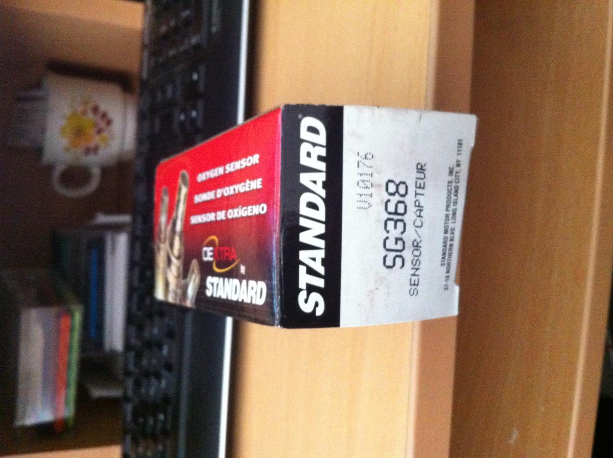

I remove the front O2 sensor and had taken note of the part number (p# 89465-33160) and visited different O2 sensor manufacturers website. I open up the website of Rockauto.com and do a part search for 1997-1999 Avalon ( American Variant of the 2000-2002 Australian MCX10R) and search under Emission and found out that Standard Motor Products O2 sensor w/ part number SG368 upstream carries the parts interchange on our Australian Avalon. By the way i had experience using the Standard Motor Products O2 sensor on my 1991 Ford Telstar which i bought here in Brisbane for $80.
I search on Ebay (US) and found $30 (discounted) a piece direct fit and bought 2 plus $15 freight. Ebay Australia and EFI supplier could only provide generic in which you have to cut the old sensor wire and make use of the connector.

hello guys i have posted the old lazy oxygen sensor picture and the box containing the new sensor .
post-27536-0-96728100-1343437030_thumb.j
