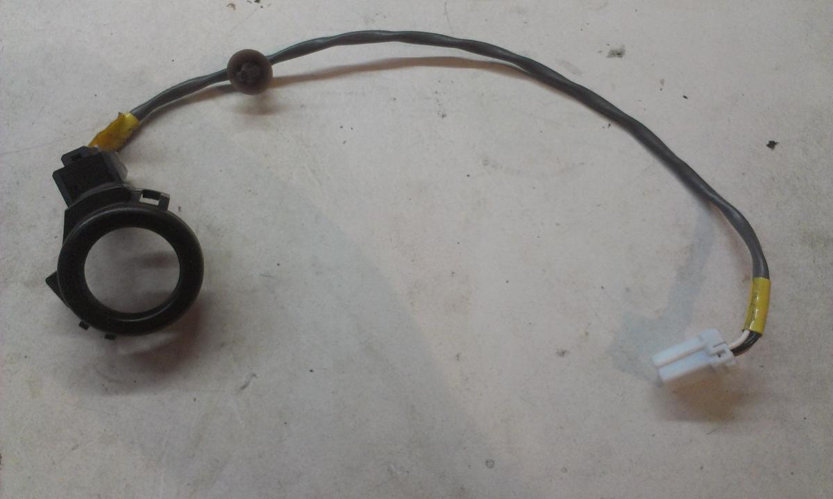

Sorry about the bad photo but you will get the idea. The one in the photo I think might even be the same as yours. These aren't coded to the car so you will have no problem with changing it over. From a wrecker you really shouldn't be paying more than $20 for it, I got this one with the immobilizer box for that.
post-2320-0-34481700-1378817875_thumb.jp
The one in my picture plugs straight into the Immo box so no amplifier.
What do you mean one that sits on the side of the barrel, there is only the one antenna. There could also be a switch on the side of the barrel which is for the buzzer when you leave the key in the ignition.
