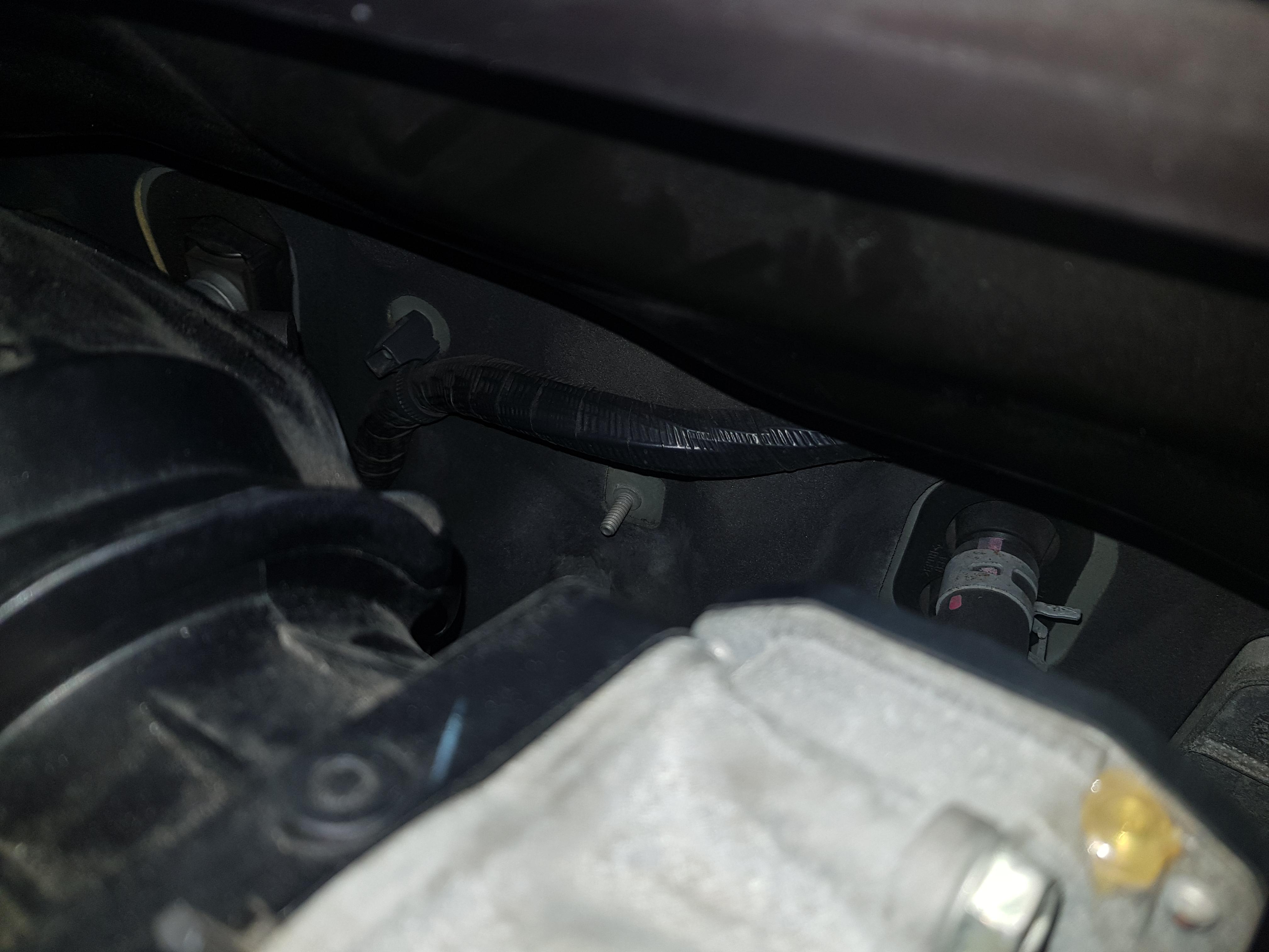

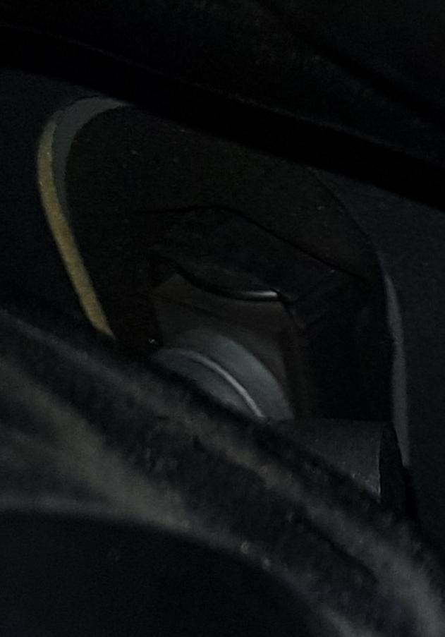

I just took it to another mechanic who seem to be a bit more knowledgeable about these things so he actually witness my fuel gauge dropping fluctuate and go back up again he said all that is it the sending unit on the way out he said it's not really much of a concern at the moment overtime obviously it will deteriorate but he said it they can last for a long time like that without causing much harm as long as I'm getting the actual fuel that's in the tank it should be fine for a little while.
As for the smell I'm getting on hard throttle coming into the cabin he said it is a common thing on the cars and it's not what you may think it is. He showed me on the back of the firewall there's foam supposed to cover the fumes coming into the cabin and he discovered that the foam in mine has shrunk and there is a hole there and all I have to do is put some foam in there
