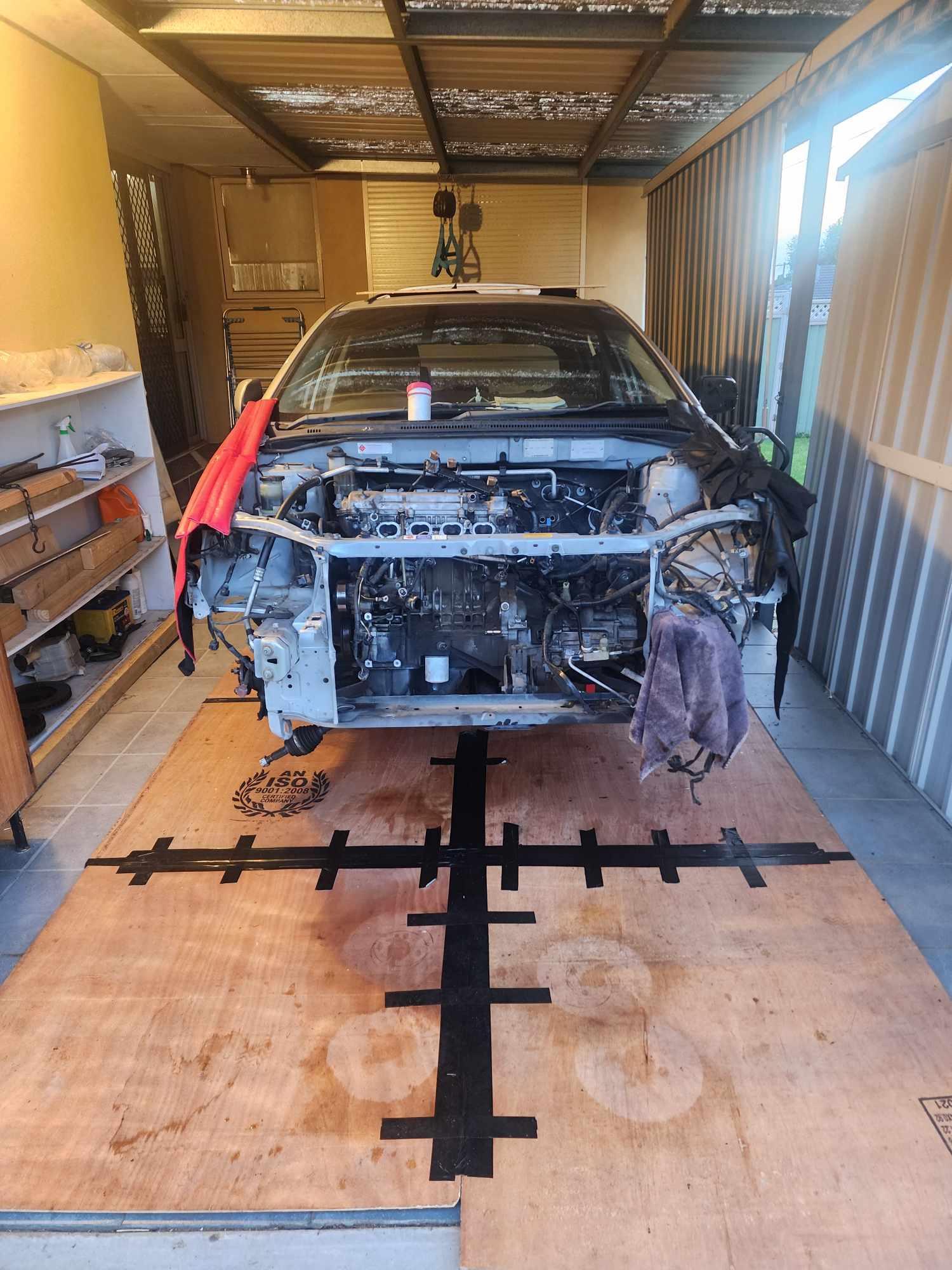

Hello all,
Working on my 2002 corolla.  It needs a engine rebuild due to burning oil out the back.  It has over 400,000 km on it and I havent looked after it. Everything is still original on the motor.  The only thing that I have replaced, was the brushes on the alternator. They were completely worn out.  I am pulling the motor/gearbox out of the car. Wont know the condition of the block or head until I strip it down.  I know the design of the piston where changed in the 2003+ models for more oil holes, which stopped the buring of oil.
1. Was there any other changes made ? 2. Does anyone know of where I can get a engine rebuild kit for 1zz-fe motor in australia ? 3. I have only found one place that I can get a new short motor built but that is in the USA and they do ship to australia but was hoping to find something in australia
Thanks for help.
Dragon
go to an jdm engine importer and buy a complete engine, much easier. You could even fit a 2zz ge into it
