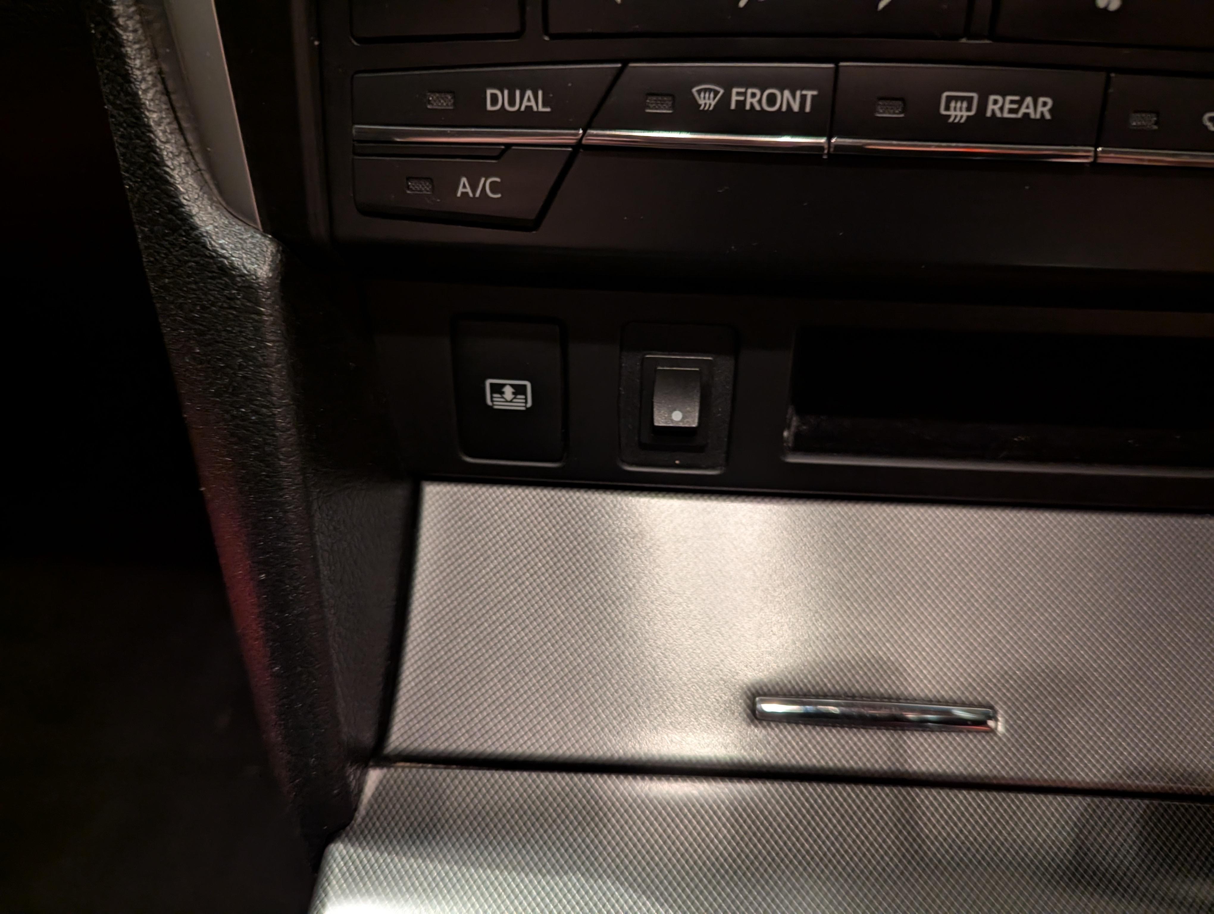

  5. Yep, I have the exact same car. It's standard from factory as attached, odd it's missing though, unless it's faulty. Have you checked if it's hiding behind the front fascia panel ? It's quite a bulky switch if memory serves me correctly. You would also wanna check the wiring loom is still there first & just get a replacement switch from either a wrecker (cheaper) or a dealer (expensive) & see if it still works. The other spot is just missing a blank. I have attached an extract "How To" from the repair manual on removing a few bits to access that area. RearSunshade - Global Service Information Center.pdf

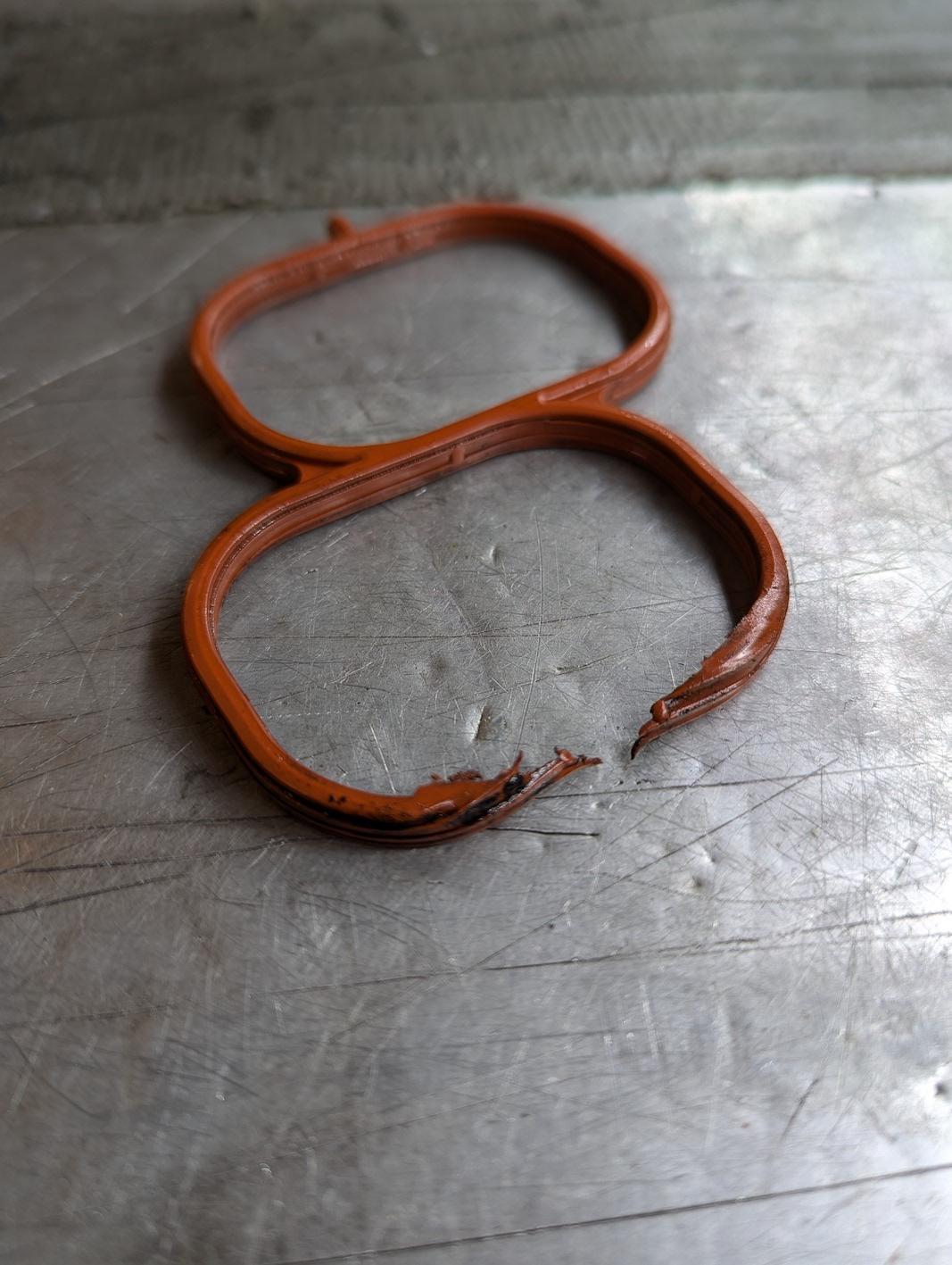

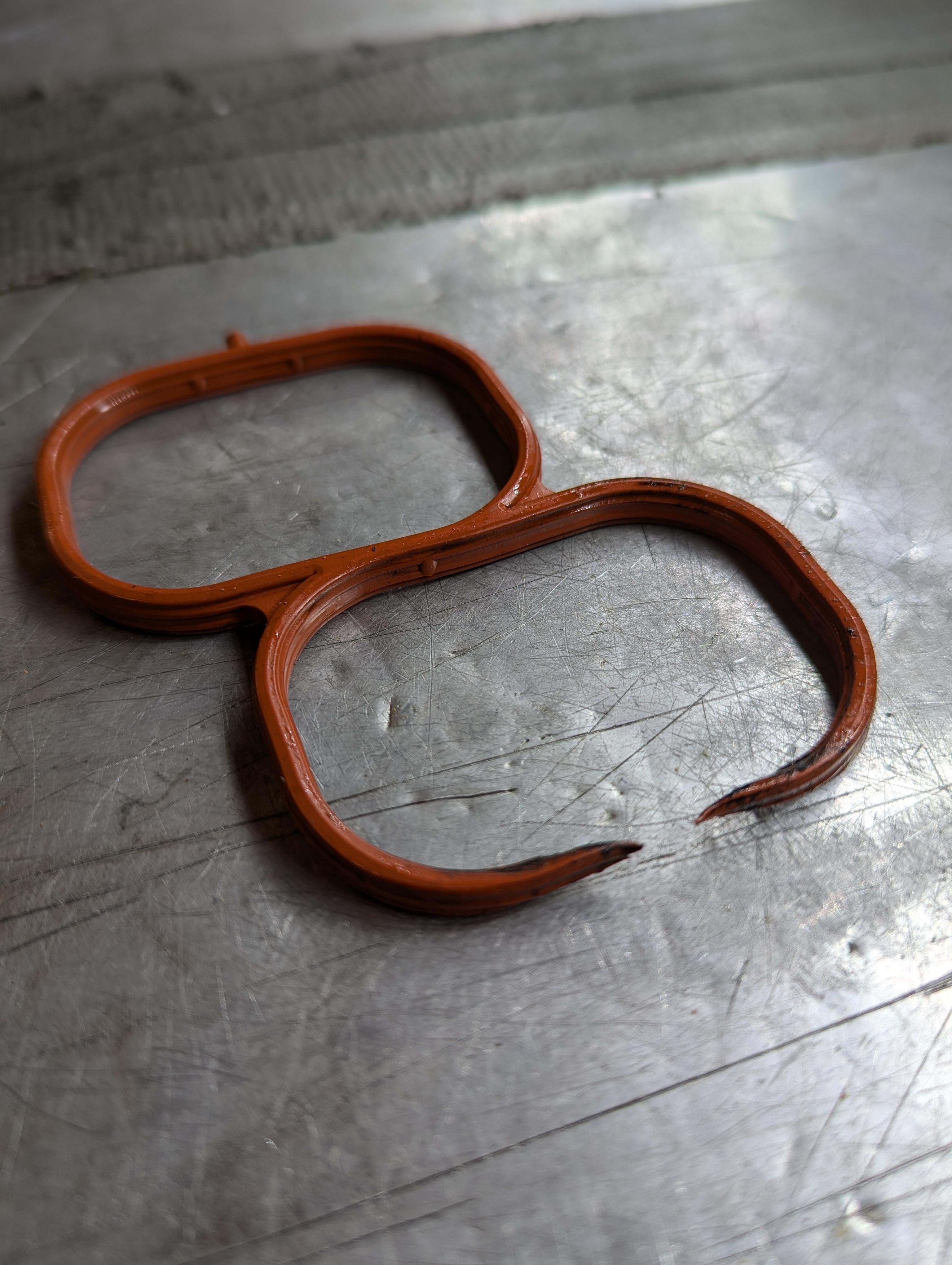

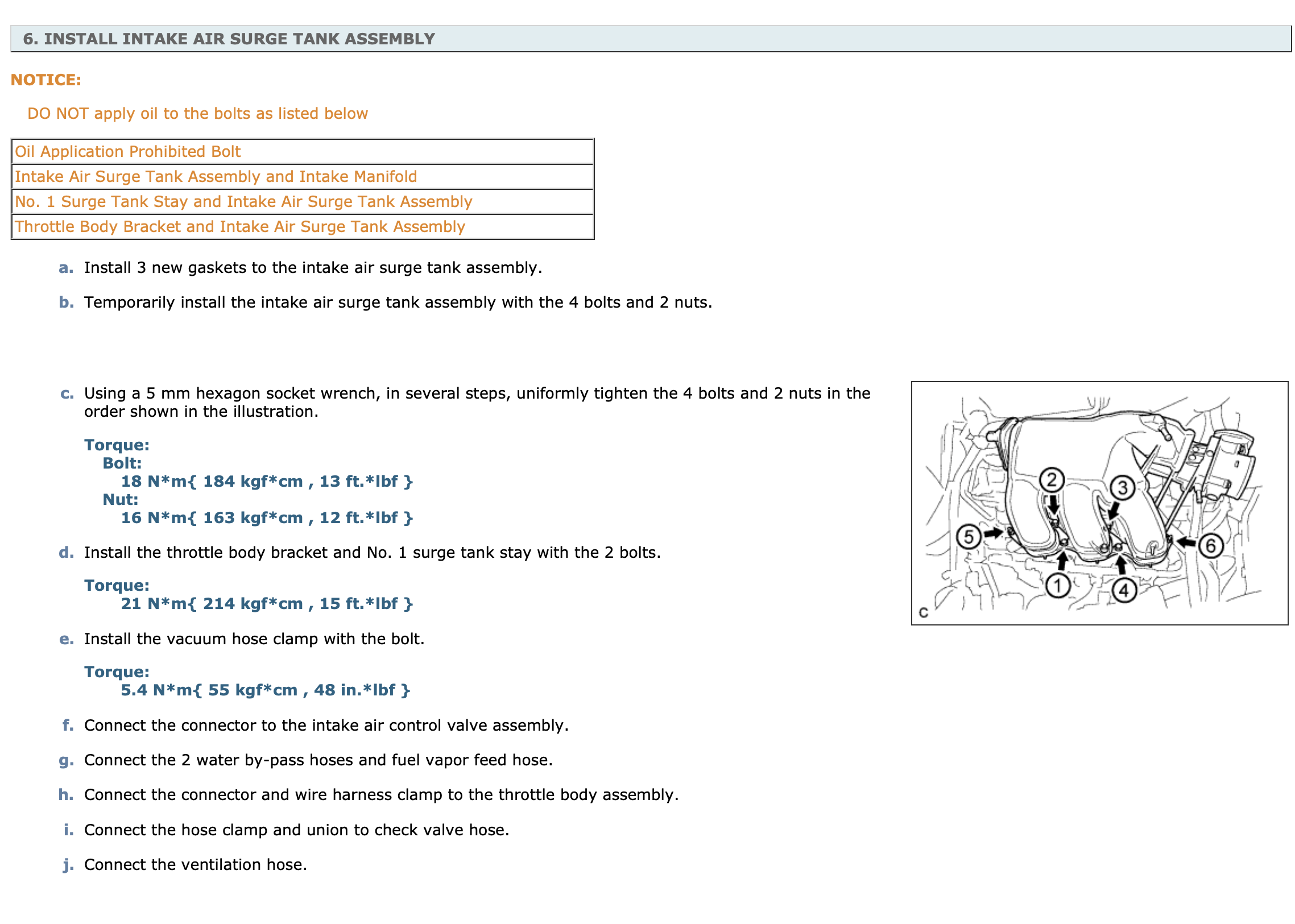

  13. Hi Ash, I did note the 120K mile comment & thought odd because the service book clearly states 90K kms. Still, I wouldn't hesitate going longer as my oem plugs prove next to no wear. Here's the pic of that screwed up gasket - ouch ! Also a screenshot of the tightening sequence. Normally I would criss-cross as I do my wheel nuts but the repair manual mentions this. Undoing would be the opposite.

  15. Thanks mate & welcome back. Sounds like the shed job you're doing is either huge or just too complicated. Yes the gasket is well and truly missing a largish chunk, amazing that really because there's heaps of room to manoeuvre the plenum up & away from intake studs to avoid nicking them. I'd hazard a guess that gasket may have fallen off away from location & then got pinched when placed onto the intake. No evidence of orange gasket near valve so it either got sucked/chewed up through the motor or fallen out when tightened. Not even Toyotas are perfect, never thought they were anyhow. I'd post a pic of it but I can't even edit my above post atm, not sure what's going on with the site there, I'll try again another day I guess. I'd get onto yours asap to avoid any DTC issues, having said that these plugs are pretty darn good. Was very difficult checking 1.1mm with feler gauge on the used plugs so guessing no wear. My car does get driven pretty sedately, as yours would.
