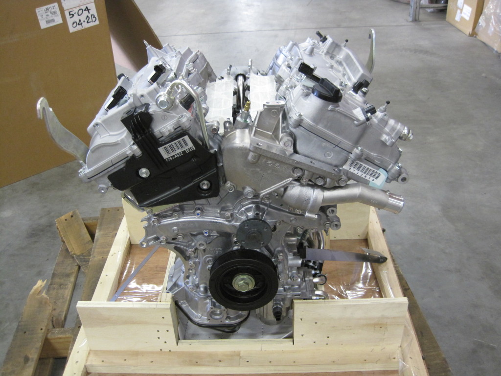

Slightly OT, but thought this pic (seen on Ebay) of 2GRFE engine may be of interest; good view of the VVT oil delivery pipe mentioned in the forum some months ago.
