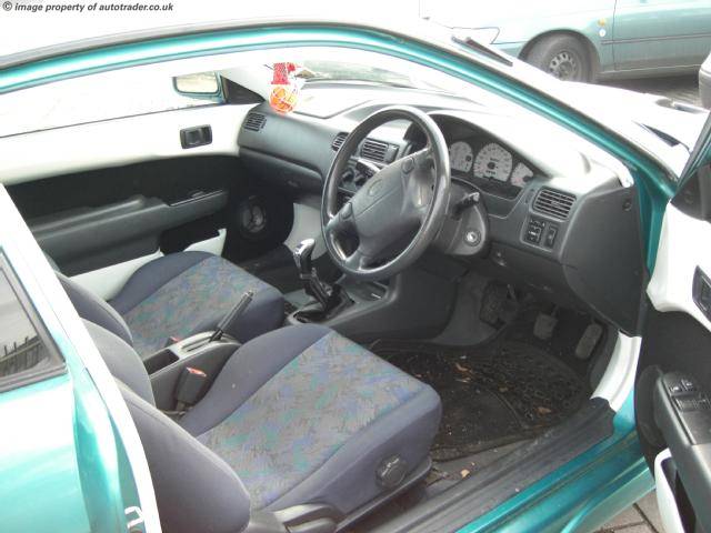

i just bought a 96-paseo 1.5 si and try to replace the old radio player. but have no idea to remove the radio player. pls do me a favour, many many thanks!!!!! if possible , may email me at davismmx@hotmail.com

Anyway, if your EL54 is anything like my EL44, it's quite easy. There's a plastic fascia around the CD player/pocket that just lifts out (might have to pry it with some hard plastic), after that four 10mm bolts to remove and the whole thing just slides out.

thank u very much indeed!
