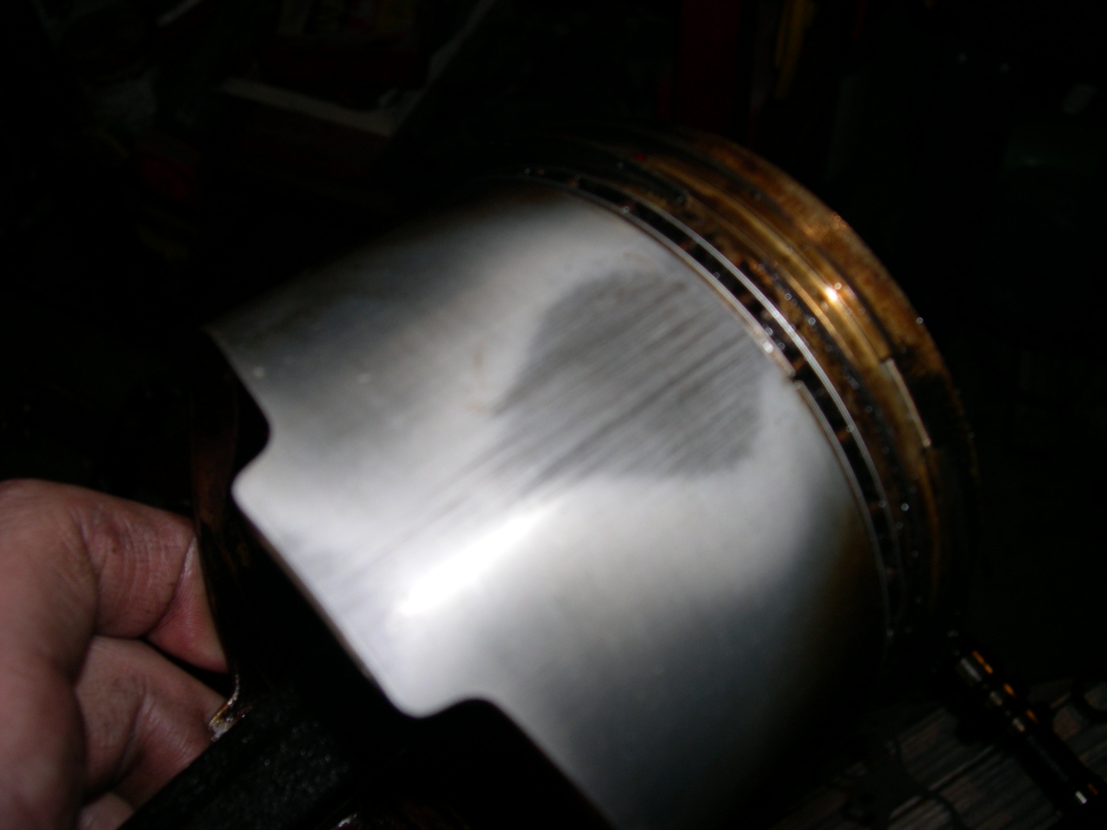

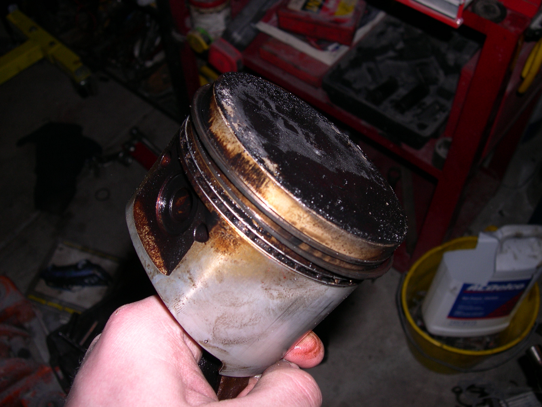

Piston slap sounds similar to bearing knock most the time, but unlike when bearings are stuffed - piston slap actually goes quiet under heavy load. Piston slap will also have noticeable effects on performance (makes the engine much slower at bringing up the revs as the pistons tend to wobble around and dig into the walls a bit), and after a few thousand K's, you will find that it will start converting the round cylinders into a oval shapes. It will also start burning a fair bit of oil and smoking a bit.
I can give some pictures of what the results of piston slap are when I am at home, but I am almost certain that the Aurion sound on startup is not piston slap. It will simply be tappets more than likely.
Just realised I had some of the pictures on this computer anyway... As you can see - piston slap is not a good thing on an an engine. It is essentially where the piston wobbles around enough to scrape against the side of the cylinder.
The scratch marks on the side of the piston in the picture are where it has scraped, and the other picture is how seriously the cylinders can allow blowby to pass by, which will cause all the baked-on oil that you see around the sides of the piston.
