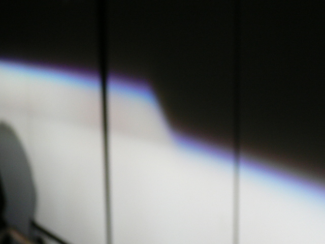

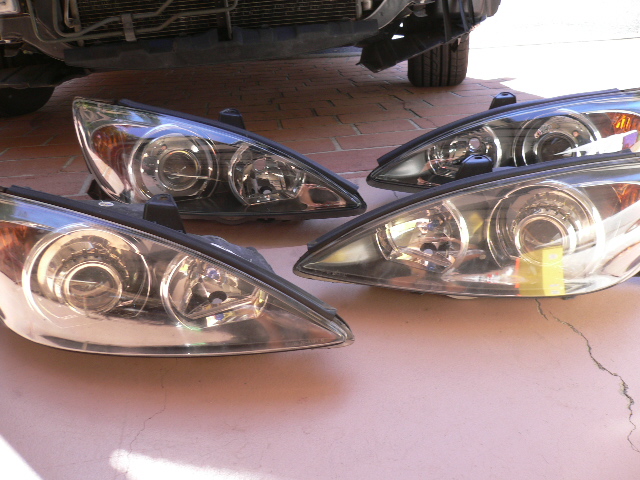

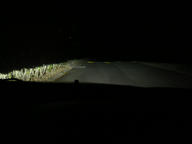

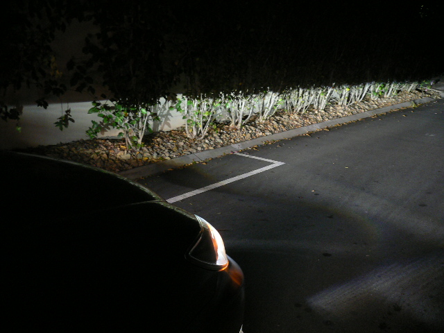

Mate, you have the skill to make these, so you are OK. :) Me... no clue lol
Can you post up some shots of your HIDs at night? I want to see the cut off and how good they light up the road.
Thanks
Edited by Modena
Thanks
Nah - mines nothing compared to the some at hidplanet. Mine's not fully perfect, but i couldn't be bothered fixing it up as it was sealed.
Attached some pics, they're not as good on the camera for some reason! The ones shown here are the s2k projectors.
The TSX ones aren't as wide in terms of output, but its still pretty good.
