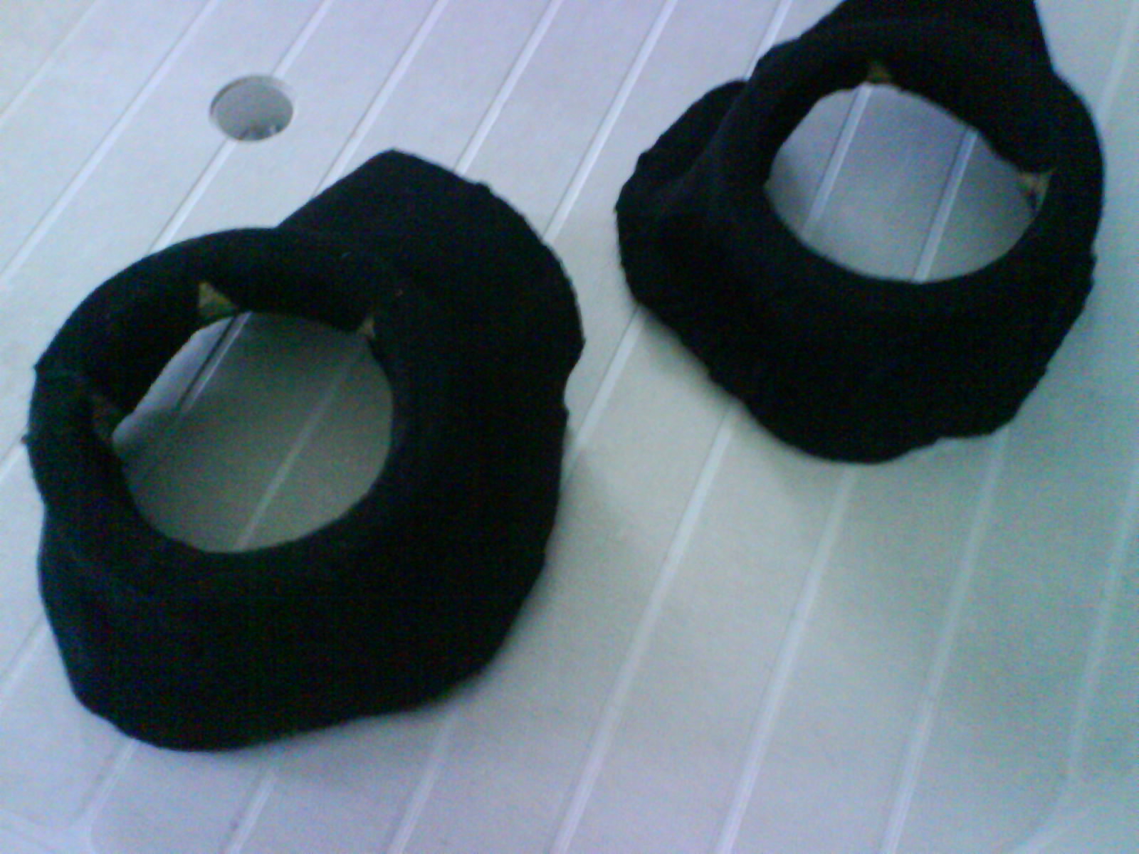

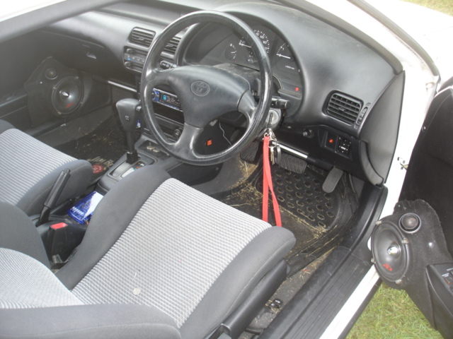

If you have some skills in fibre glassing you could do what i did and build pods to house 6.5 inch speakers, i had 4" but wernt happy with its low tones (didnt have an umf to it and is generally restricted in design, most expensive one ive found for 4" are focals and went for $400 compared to 6.5" where they can run past $1k) IMO buying cheap means you have to buy and buy again.
have a look at my front speakers, it has a tweeter (the small round thing on the door, was suppose to be on the side of the side mirrors but housing didnt fit) and the woofer (big circle thing in the door) the filter is a box which you hide somewhere (its sitting in the door in my car)
