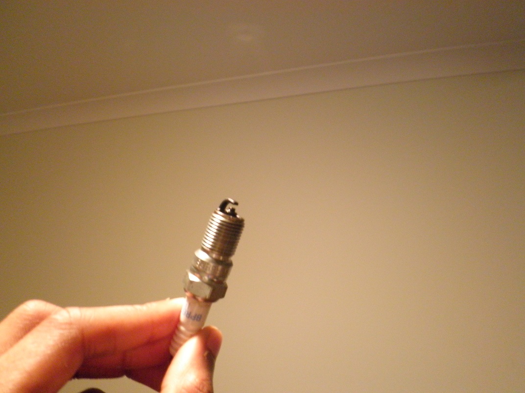

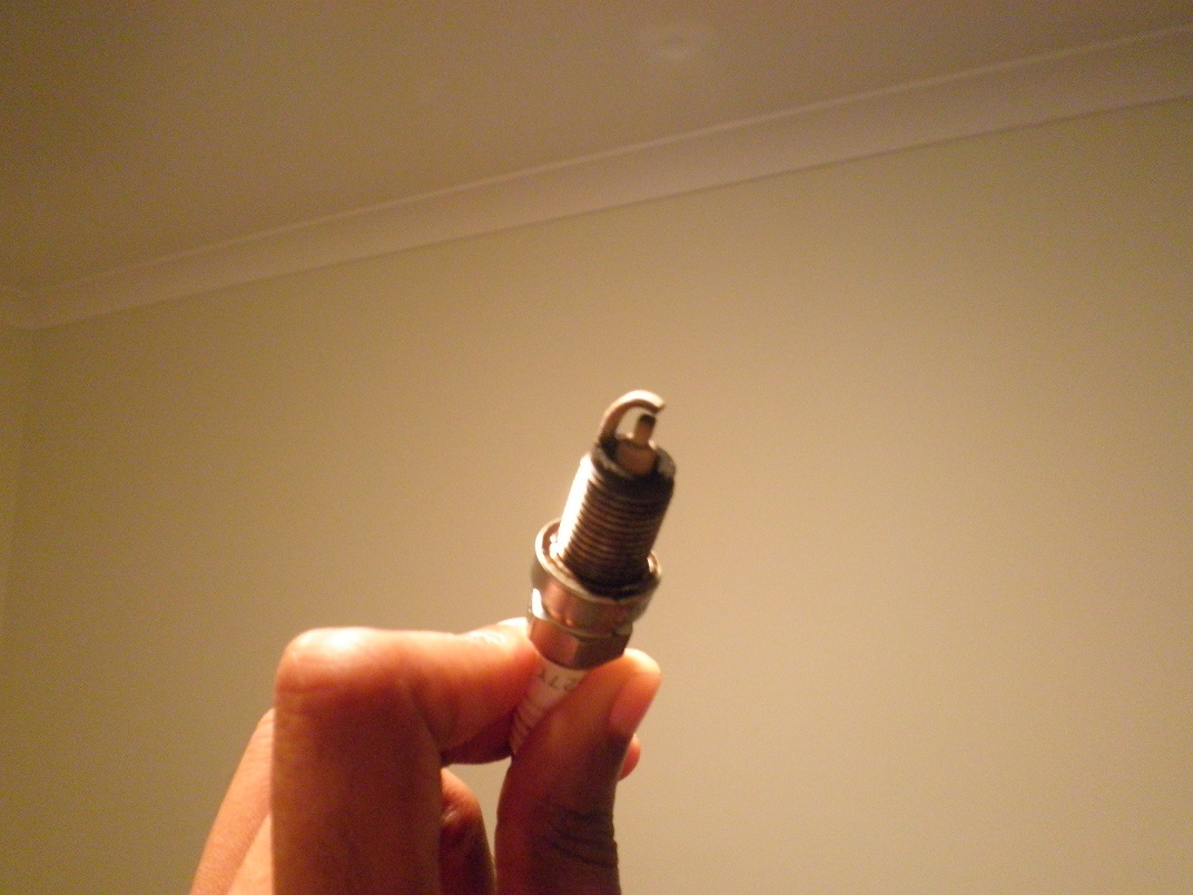

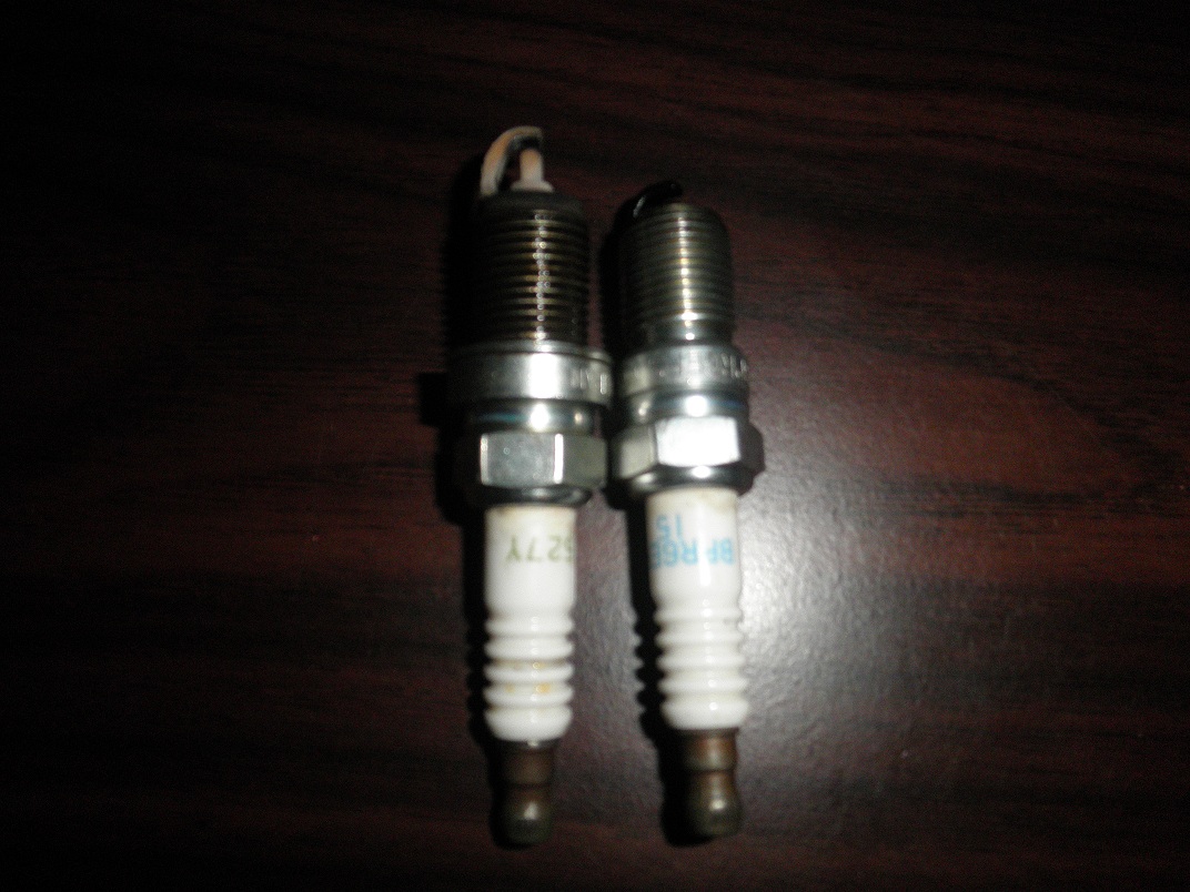

Here are the pictures, sorry I couldn't get them more detailed because the camera just blurs the picture if I try to take too close a picture.
The incorrect spark plug is on the right of the first image, and also has the part no. written in blue, as you can see it's significantly smaller than the other one.

plugs wouldn't be the cause of the oil, more likely worn rings or valve stem seals in that cylinder. Gap the plugs down and put them back in, or put in some standard plugs.

I was originally concerned that the plug may have been too long and hit the top of the piston. I hope this is not the case but if the 'wrong' plug is the long one you may need to get a good look inside to check the top of the piston.
it would be quite obvious if the plug had hit the piston, the electrode etc would be mashed.
