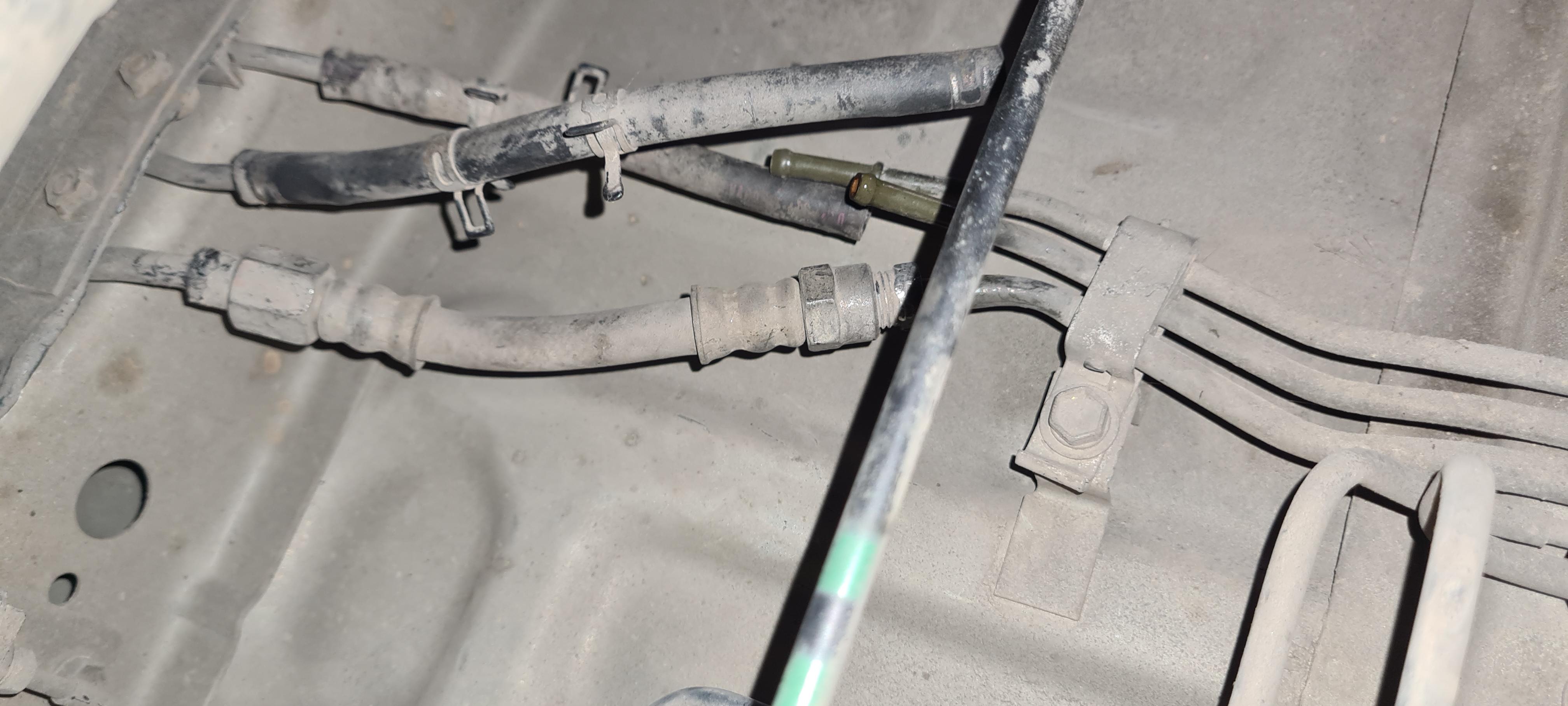

Hi Curtis1995
I am in the process of dropping the fuel tank on my 2000 HiAce van to replace the pump.
It appears you've managed to remove all 3 of the hoses to/from the pump/tank. I have managed to disconnect the 2 with simple squeeze clips but am having no joy in disconnecting the final one. I have attempted to loosen it using ring spanners with no joy.
Do you have a special technique with this or am I taking the wrong approach? I have read that some connection require special tools. I hope this isn't the case for this.
Next on the agenda will be the filter. Not looking forward to that either. 😮
