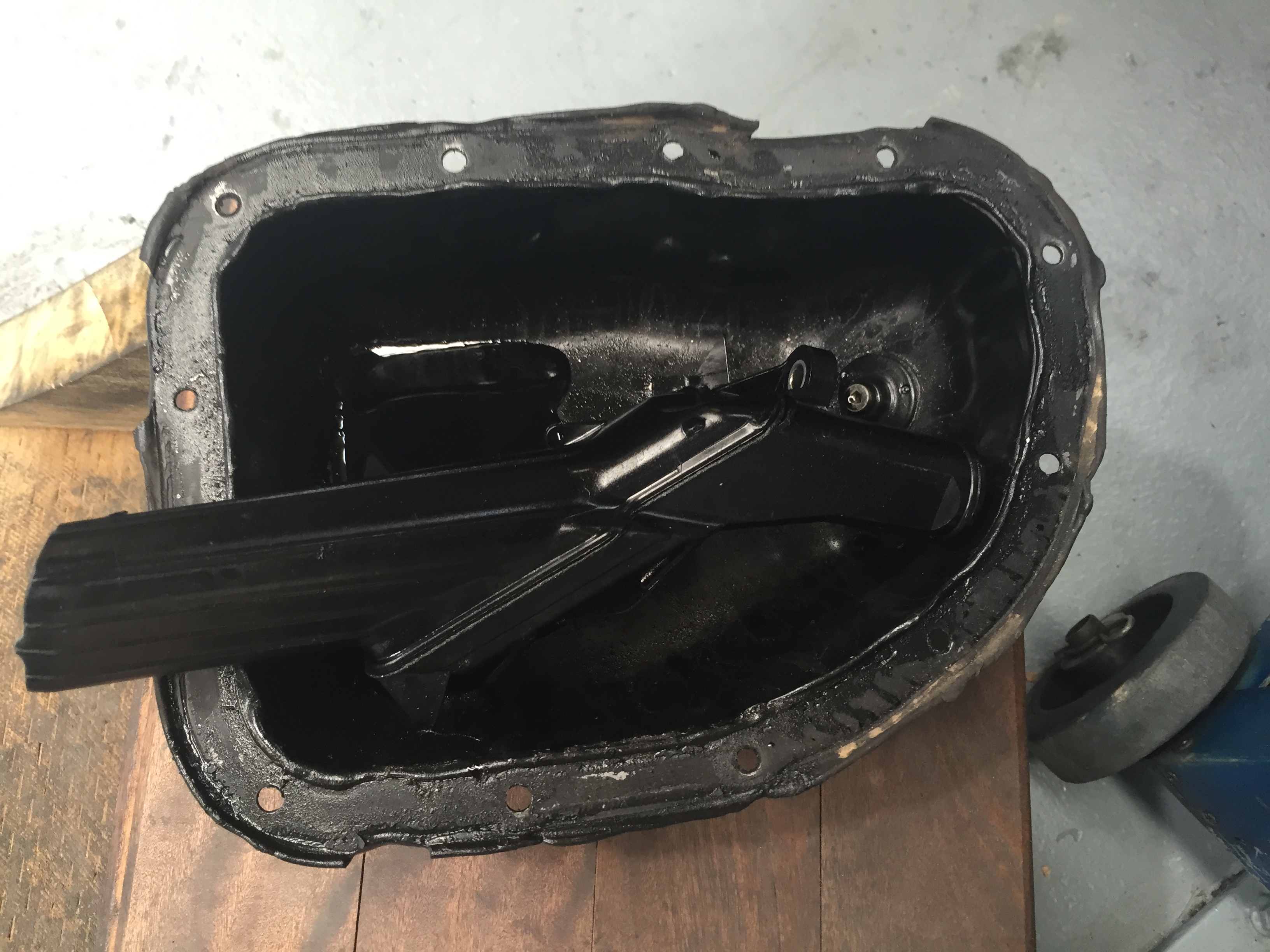

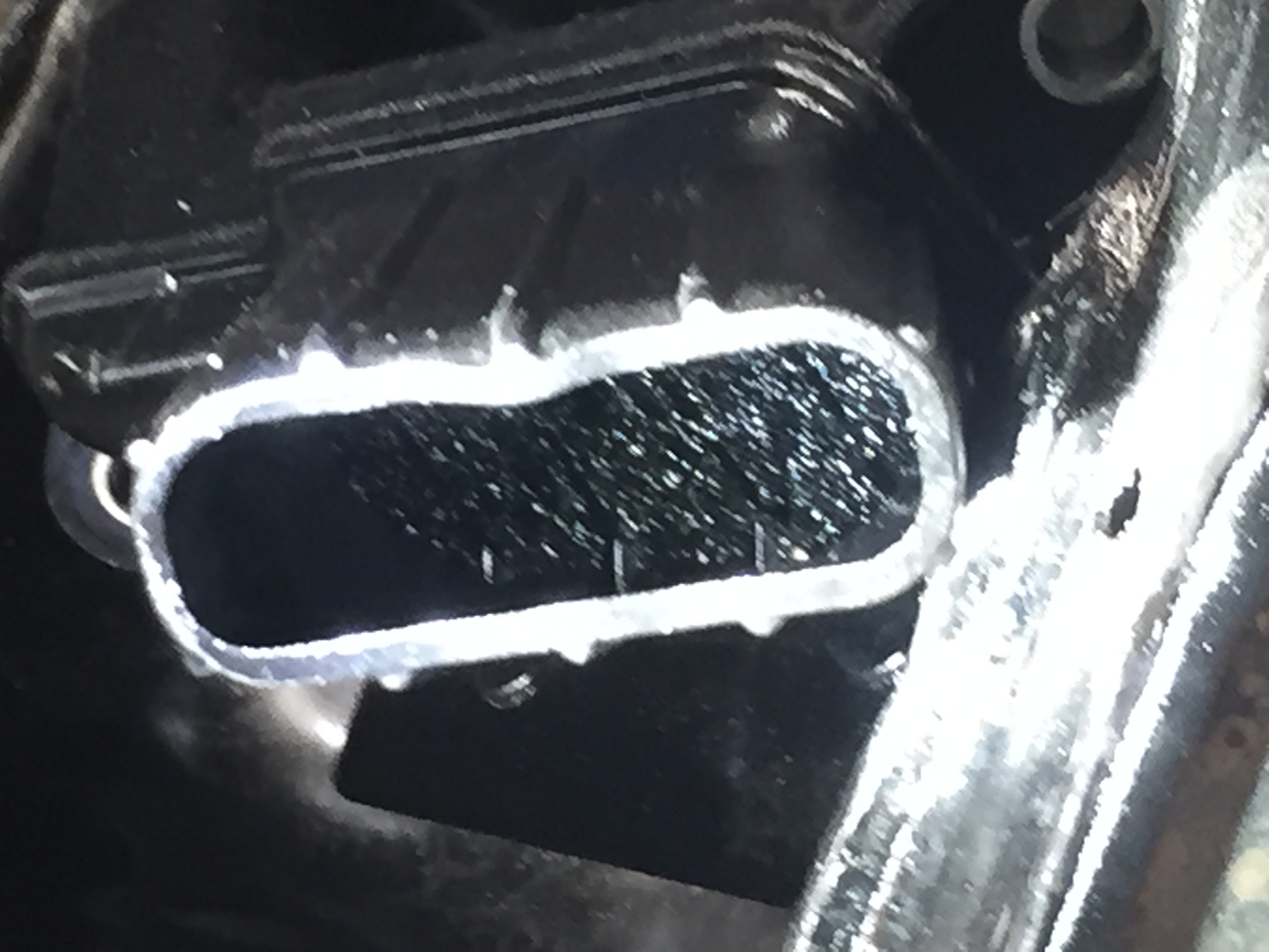

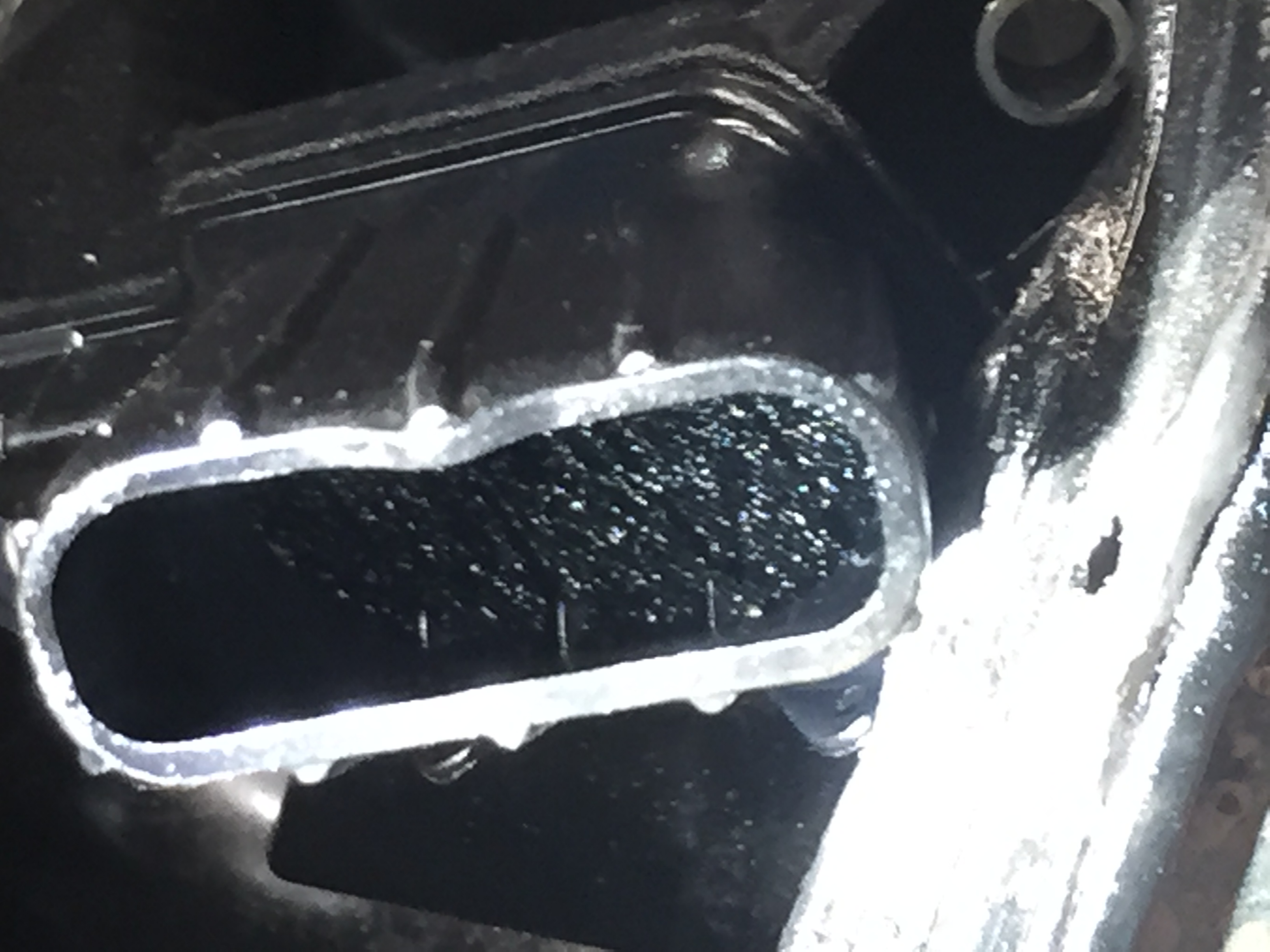

Landcruiser is 2008 twin turbo diesel with 233,000kms and has consistently had oil consumption problems even after a Toyota repair.
a couple of weeks ago the engine, which had been serviced the week before, seized.
The mechanics advised the oil pickup & strainer is clogged with sludge.
Expensive problem but why if I have followed the handbook service requirements ?
This is a very typical issue in modern diesels. A catch can and an EGR blanking plate can go a long way to preventing sludging/carbon in the oil symptoms.
