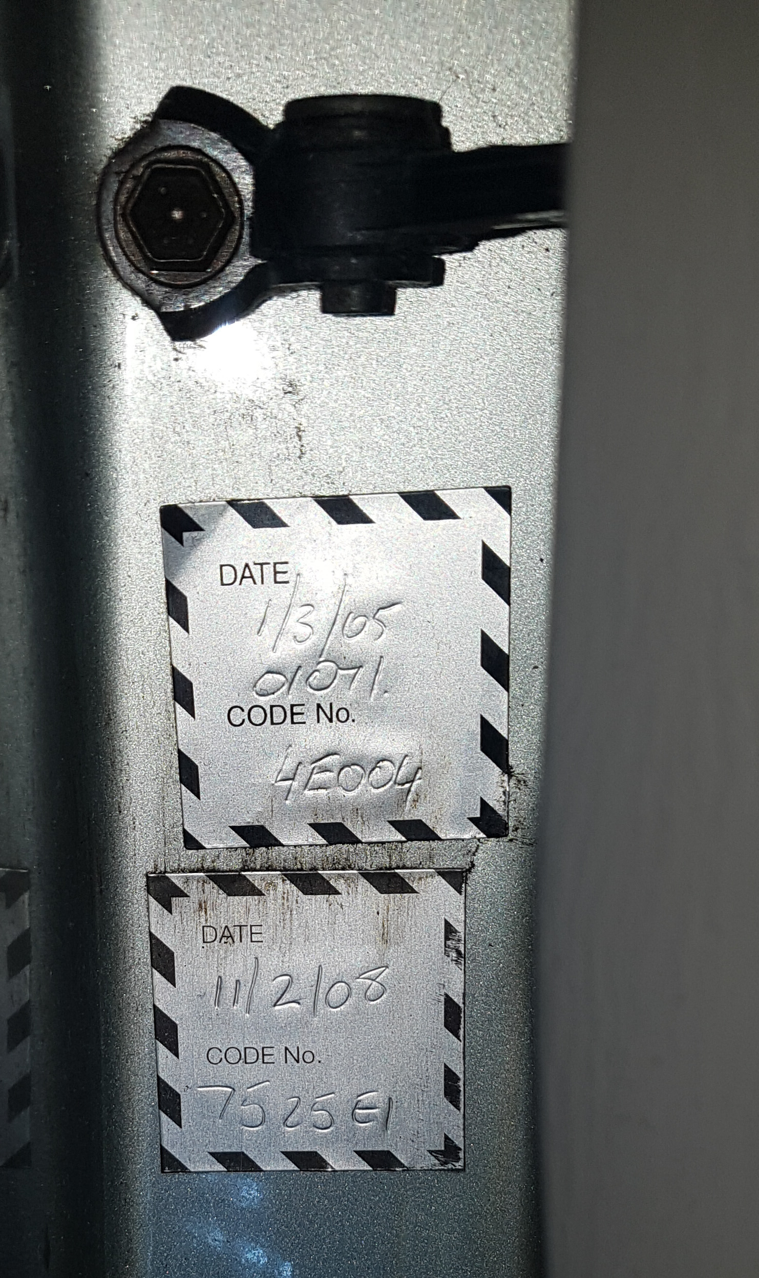

Weird stickers
daitkeo
  • 1 month later...
https://www.productsafety.gov.au/recall/toyota-camry-and-avalon 4E004 An assembly error in production may result in pinching of the charcoal canister (fuel vapour storage canister) vent hose. In this condition, high vacuum in the fuel tank may cause a crease to develop in the upper surface of the tank.
7525E headlamp switch contact points over time may oxidise (corrode) due to insufficient current flow through the switch. This oxidation may cause the headlamps (low or high beam) to flicker without warning and in the worst case may cause the headlamps to extinguish momentarily.
