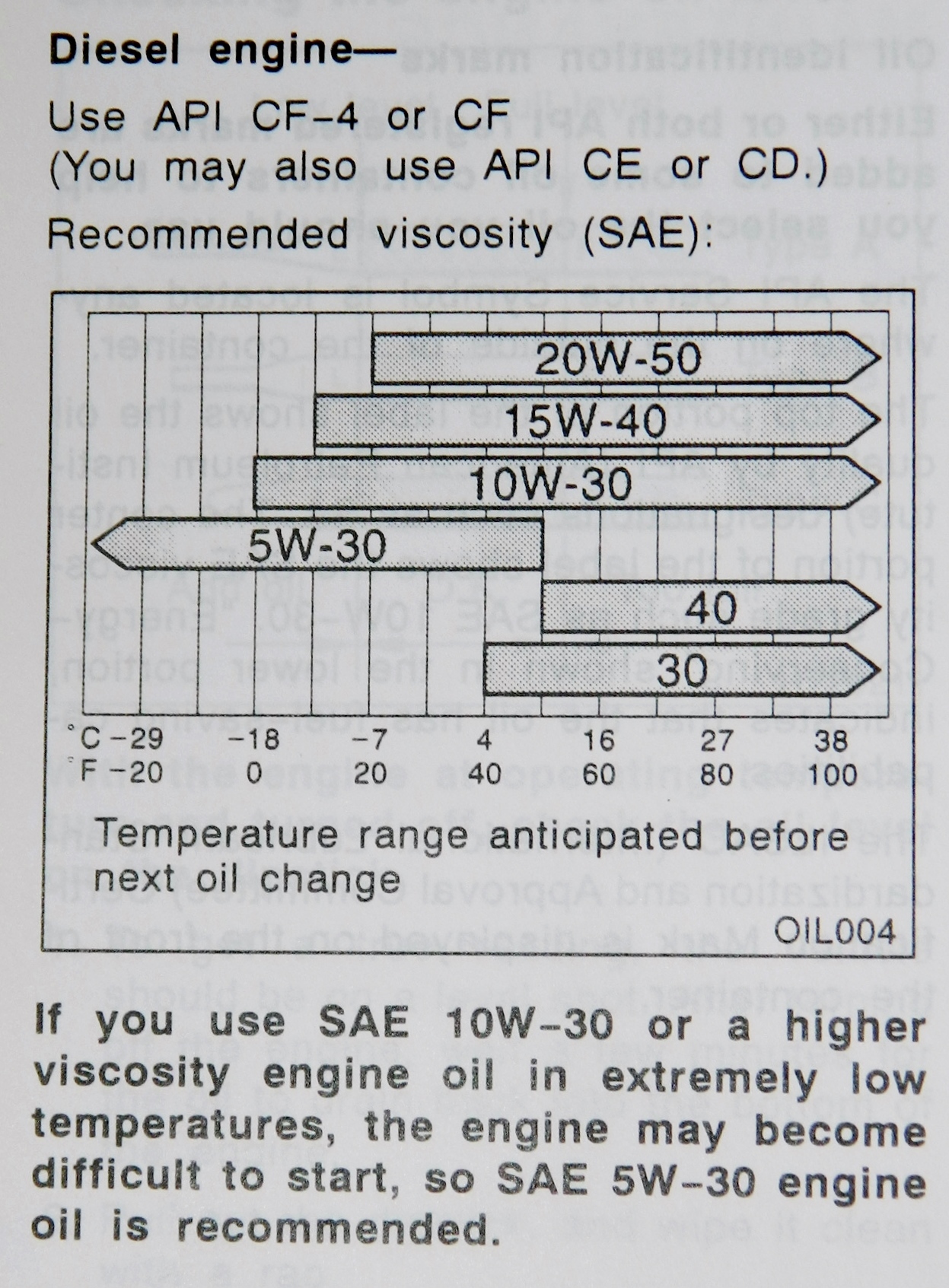

this suggests the lubrication is not up to the top of the engine yet. Your location says "Non Aust" - is it possible the oil you have is too thick on cold start up? - IE: if you are in EU then winter so you might need to go to a slightly lighter oil for this engine - recommended by mr Toyota is in the image attached below for you.
A lot of workshops will just put in what oil they have so come back to what you know - does the engine definitely have the correct grade of oil etc.

On 1/2/2018 at 10:27 PM, GC_AUS said:
"It ticks for about 1-2mins might be a lil more then goes normal for the rest of the day. "
