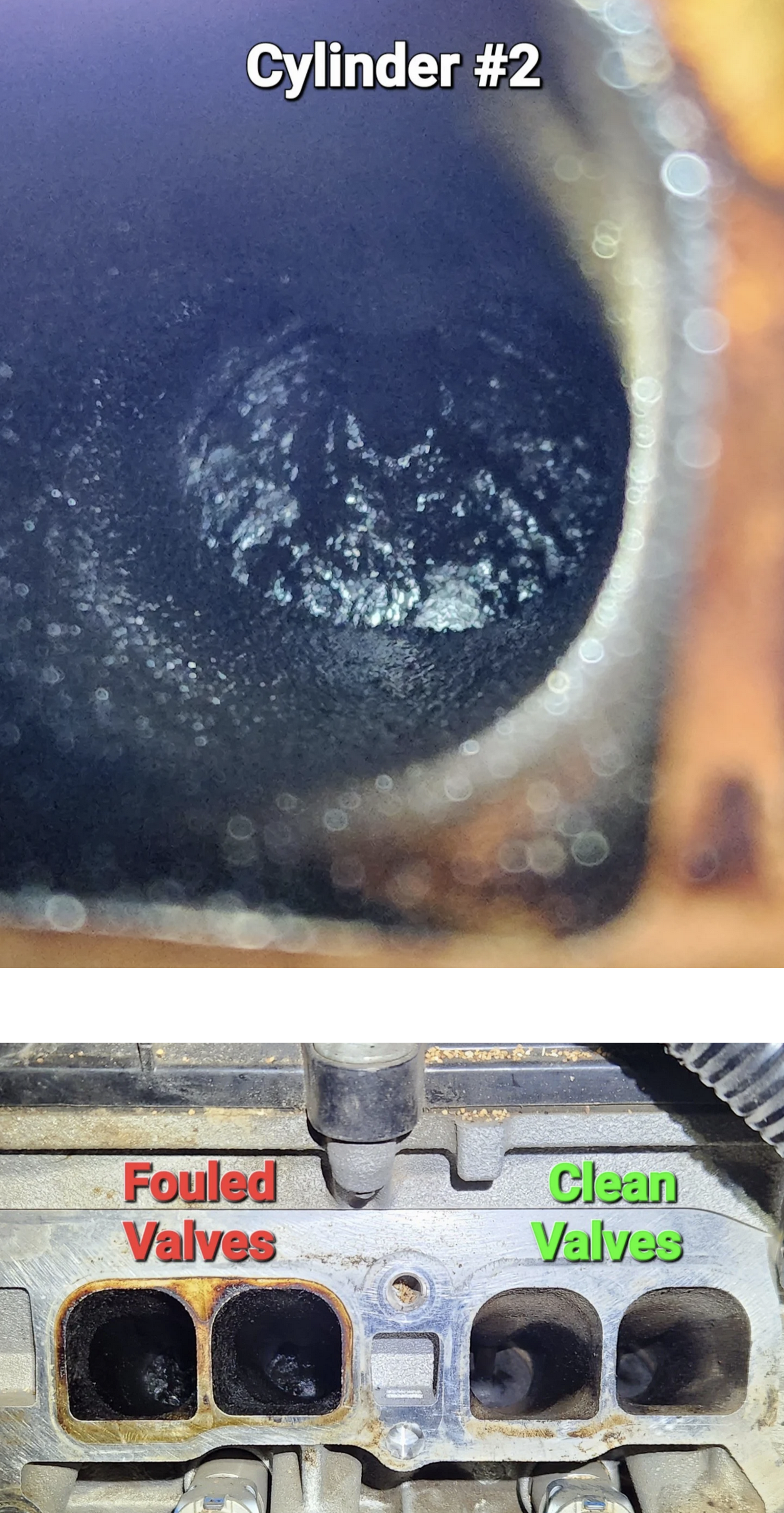

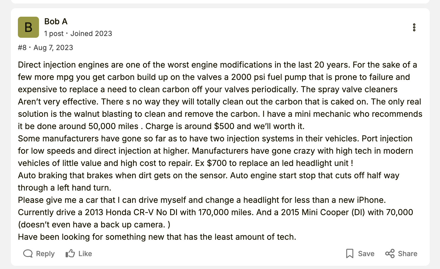

Just browsing through a Mazda forum & noticed this - these PY-VPS engines are reliable but they come with caveats they won't tell you about when signing on the dotted line - walnut blasting of the intake runners, done very often as a periodic preventative maintenance, especially for those that do routine stop/start short distance driving . . . . . 😳  . . . . ouch !
The twin injection system this bloke infers to is Toyotas genius D4S in their Dynamic Force engines now common on the latest Corolla, Camry 4 & 6pot cars after introducing it to Lexus cars about a decade ago, not to mention my own humble HachiRoku 🙂 They work really good, the DI kicks in on the Hachi at about 4K that sort of feels VTEC like - an instant surge of power & smoothness, especially on E85 😉 The beauty is that it requires no special maintenance, especially on E85 😆
