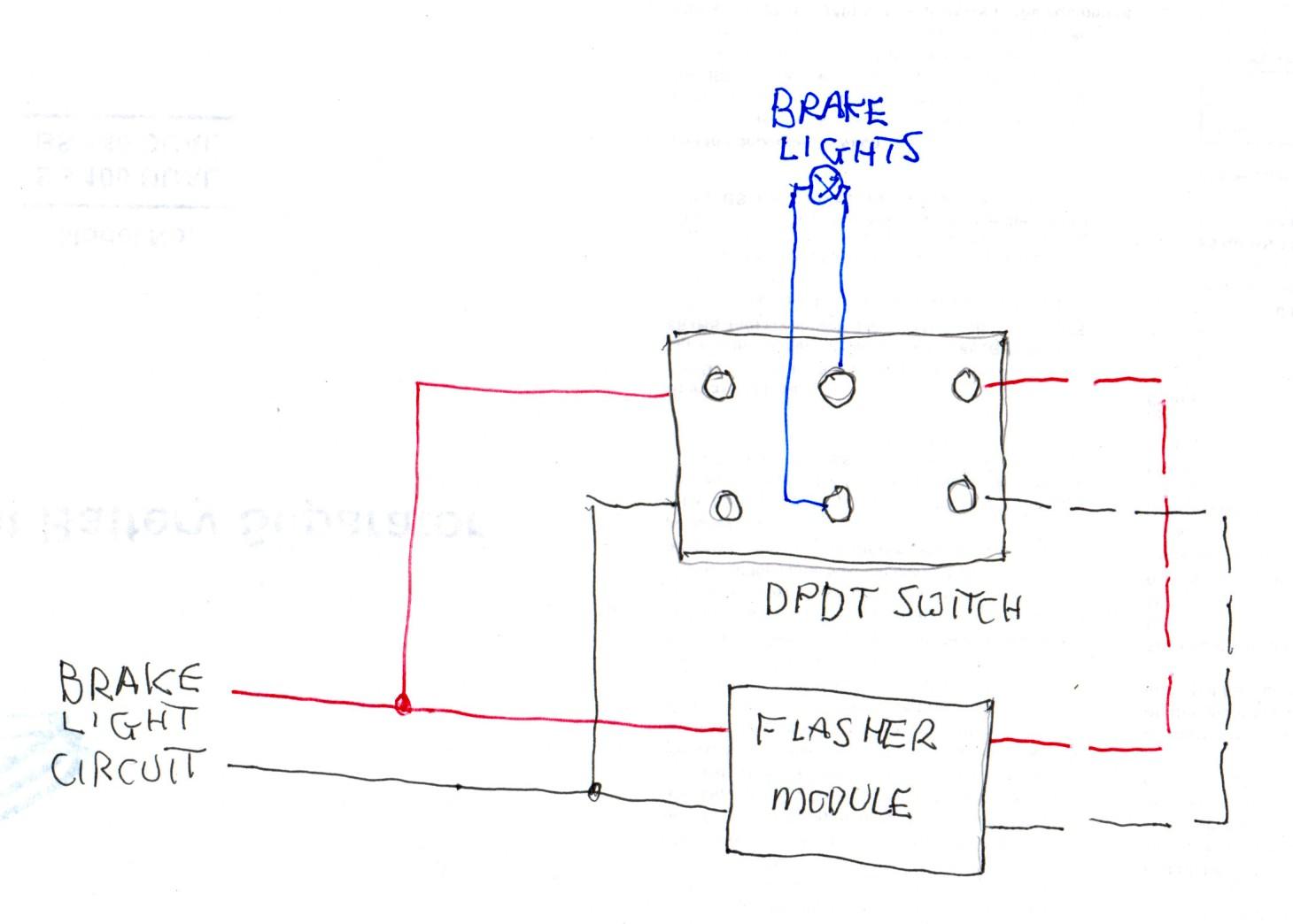

Hi friends,
My Aurion is used in a security role on various government sites.
I have upcoming work where I will be escorting vehicles on a large site.
I can't go into great detail but I need the high mounted stop light to flash before going solid when I apply the brakes.
It is easy to splice a strobe module into the circuit but when I leave the site it will be illegal on public roads.
I could switch the active off but of course the high mounted brake light won't illuminate.
I know it's a weird question but is there any way to bypass the strobe module when I'm on public roads so that the high mounted brake light illuminates normally?
I'll need a diagram 😂
