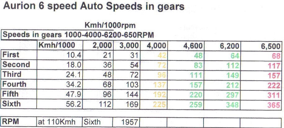

Just in case someone is interested in the moonshot gearing we have.
Aurion 6 speed Auto Speeds in gears
Kmh/1000rpm
Speeds in gears 1000-4000-6200-650RPM
Kmh/1000 2,000 3,000 4,000 4,600 6,200 6,500
First 10.4 21 31 42 48 64 68
Second 18.0 36 54 72 83 112 117
Third 24.1 48 72 96 111 149 157
Fourth 34.2 68 103 137 157 212 222
Fifth 47.9 96 144 192 220 297 311
Sixth 56.2 112 169 225 259 348 365
RPM at 110Kmh Sixth 1957

The gearing isn't set up for top speed though. The first four are fine but the jump from fourth to fifth is a bit big. Sure it takes you from 6500redline to 4600 max torque at 225kmh but you need more revs and power at this speed to overcome the aero drag and it could do much better with a 5th designed to run to 260kmh at 6200 rather then the hopeful 297kmh at 6200rpm.
Stock it gets to 220 fast enough and my guess is in fith it will struggle on to about 250kmh. With the right gearing and attention to detailed areodynamic triiming of spoliers and underbody i reckon stock engine would see 260kmh on salt flat.
