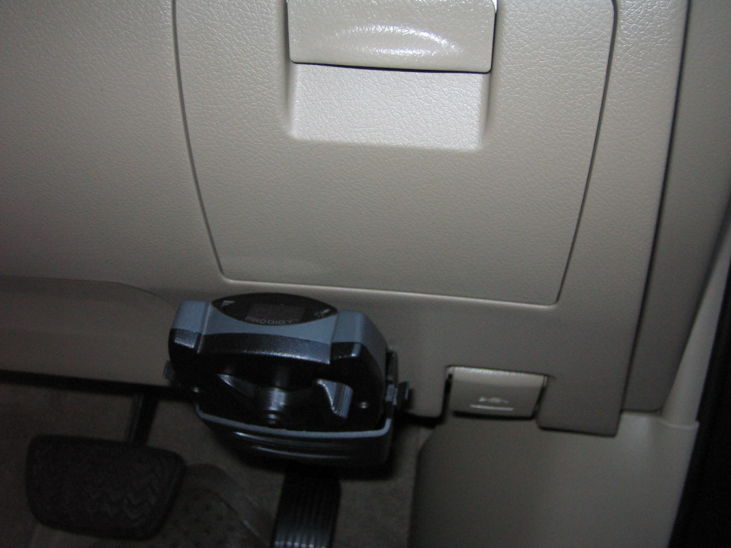

Has anyone fitted one and where did you locate the controller, my thoughts are under the steering column or somehow utilising the small storage compartment on the right of the dash or the open storage in the centre above the console?

I am about to install one and I am mounting mine attached to the bottom of the dashboard panel below the small compartment you are suggesting.

Thanks for the feedback let me know how it goes, my concern is knocking it with your knee when entering and getting out of the seat, also the manual lever if you ever have to use it will require you to reach and take your eyes off the road,
the idea of having it under the steering column if a special standoff bracket is made the units screen can be viewed through the bottom spoke of the steering wheel and the manual lever could be operated without taking your eyes off the road.

Hi Don, Just finished installing the Prodigy Electric Brake controller, all working well. Attached is a picture of the mounted Prodigy unit. No problem with hitting with my knee as it is to far away.
thanks SAMF looks good, does it comply with the angle allowed in the instructions, what are you going to tow and what load, I have a Van which will be all up close to the 2 tonne, but I have no doubt the Kluger will do it easily as I have towed a similiar van with a series 2 Commodore ute 5 sp manual and it was pretty damn good and economical, its a pity that Toyota have put a 2tonne towing limit on the Kluger I believe it could handle 2.5tonne easily.
Hi Don, I have static tested it and works, this model Prodigy because it is all electronic, can be mounted up to 70 degrees from the horizontal. The way it is mounted on the Kluger it is about 45 degrees. I have bought a new Jayco Pop-top caravan (17 foot) the GMT is 1365 Kg ATM will be about 1575Kg, so well within the Kluger's specs of 2000 Kg. Have not towed it yet, but am leaving for Queensland for 6-8 weeks in mid July.

4. The US forum Toyotanation has a good rundown on prodigy install but the writer does not touch on this subject and appears that he may not have had this pre wired harness in his Highlander and therefore wired directly to the plug. He also suggested that the brake switch was difficult to access(I agree) and he patched into a grey wire on the converter? Box under the dash in his case LHS, the Kluger does have a similair box under the RHS “Converter”? I am a bit uncertain of this ?
The wiring of the Prodigy is a very simple exercise on paper but on the Kluger is made very difficult by lack of access and options to patch in wires.
I have successfully routed the wires through the bonnet release cable grommet and into the wheel arch (also a bit tricky and tight going).
If anyone has any feedback on the above it would be appreciated.
Cheers
