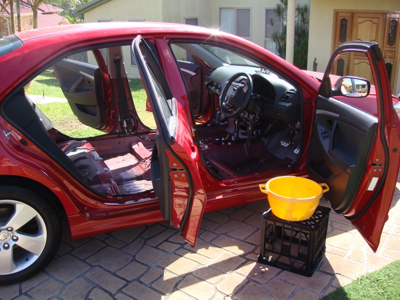

I'm new to this forum, but have been reading through the Aurion topic for the past few weeks while I've been waiting to get my Aurion on the road. I thought I would just make a post to express my satisfaction for my new purchase. This will probably turn out to be a bit of writing, but it has been a rather long journey to get where it is today (felt really long due to my impatience).
Back on the 18th of March, ManheimFowles here in Brisbane were auctioning off some flood damaged vehicles. There was a Wildfire 2007 Sportivo SX6 there that had travelled only 24,000 kms and barely had signs of water damage. The engine bay was completely clean with no signs of water getting past the guards at the bottom, and the inside had only the faintest smell of dampness. What was even more surprising is that when it came time for bidding, towards the end there was barely anyone around and I was able to snap it up at just under $20k including administration fees and whatnot.

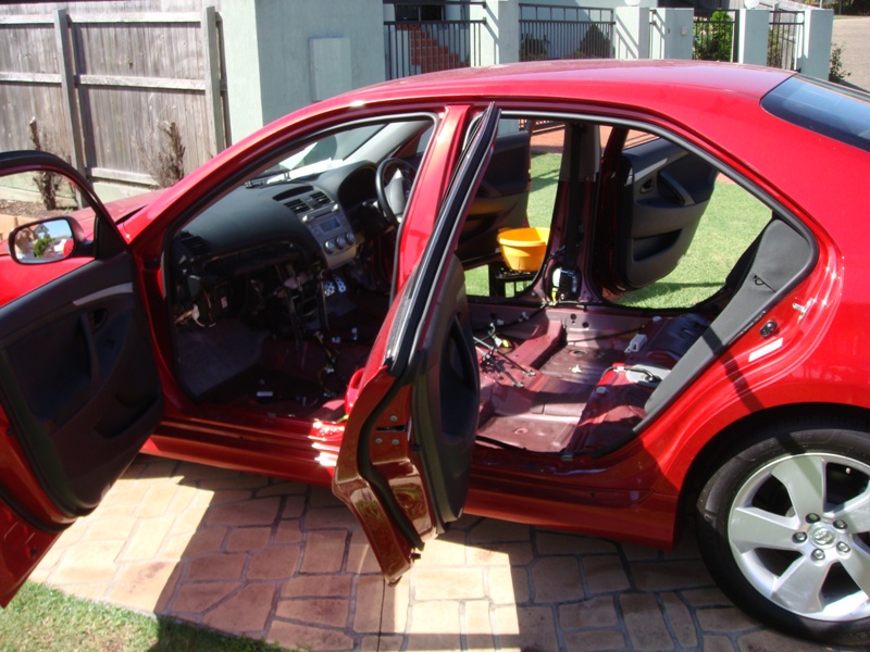

So now came the fun part of taking it all apart to clean it up. With a little help of the service diagrams, the interior came out pretty easily and the carpet was then taken out and given a good wash. The car was given a good clean inside then left out to air for a few days which completely got rid of any smells (photos included of it with the interior out). Also, since the air bag light didn't turn off after the car was turned on, the air bag module was checked. It appeared to have some corrosion on the terminals, so that was replaced. Quite surprising as well, the air bag control module only cost $137 which was 1/4 of the cost that I was expecting. It even surprised the guys at Southside Toyota when they had to look the part up. I swapped it over and the system self tested fine after that.
While the interior was in pieces, I also took the chance to run cables for my sub/amp which I was to put in once I put it all back together. So once all that was done and the carpet was clean, I layed down some new under-felt (which I was able to obtain free of charge), put the carpet back in and re-assembled the interior. It was just like a new car again. I got a safety certificate on it and then booked it in for a Written-Off Vehicle Inspection; and what a wait that was. There were so many cars that they had to inspect so I had to wait 1 and half weeks just to get it inspected, followed by the 48 hour minimum inspection time. It was so hard having it in the garage and not being able to drive it.
