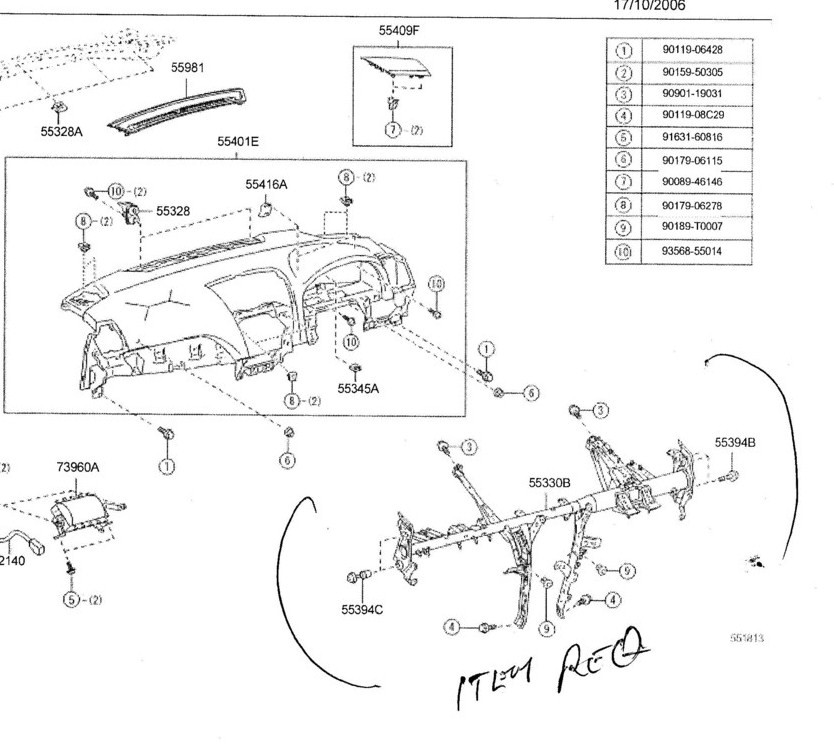

Apart from the creaks and squeaks, I had a sound that came on during higher interior temperatures that sounded like a bolt bobbying around in a plastic mug. Turned out to be a faulty beam that everything under the dash is bolted to. It has a telescopic section where the inner rattled against outer wall. What is your rattle sound like?

My noise was metalic but muffled by all the things attached to the main beam, that's why I say it's like a bolt in plastic mug. Also, because the beam is hollow, the sound travels all the way through it. The rattle was actually starting behind the instument panel but I thought it was more closer to behind the radio towards passenger side. I could always reproduce the sound by leaving my car out in the sun,(help expand the outer part of telescopic beam) then driving on grass at say 15kmph. The grass is bumpy and you don't hear road noise. Try a vacant block of land or a park/oval, it's great for rattles!

a ) The beam behind the dash - causing metallic rattle in a plastic mug sound

I have attached a copy of the beam they replaced in my Prodigy, the rattle was in the section just to the right of the radio mount. I've also had two kits installed for the general squeaks and creaks plus a new centre vent to stop the a/c "leaf" sound. I reckon I now have the quietest Aurion dash in Australia! Your dealership would know of the dash rattle kits and centre vent replacement as they are both very common. To my knowledge no one else has had the same problem with the beam that was replaced on mine.
