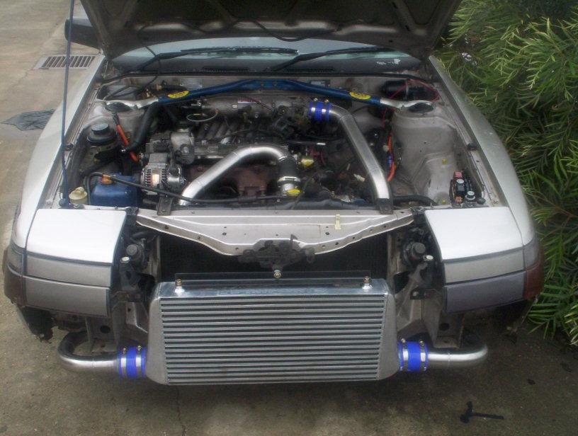

dont turbo the stock engine youll pay for it lol... buy a gen 2 3sgte there cheaper.. depending on ur budget.. it will cost u 7500 for the conversion , aftermarket ecu , big front mount , intercooler piping , 3inch mandrel bent system , double dump , etc etc etc... if ur gunna use a front mount use the 3sge intake manifold find one stops heat soak
and yep the starter hole is on the other side u can re drill it on the opposite side of buy a sv21 camry gearbox.. youll need to buy the sv21 camry starter motor if u do that... ive just finished the conversion if u run into ne problems send me a email or something..
the 3sge computer will handle stock positive pressure not sure about the 3sfe one..
