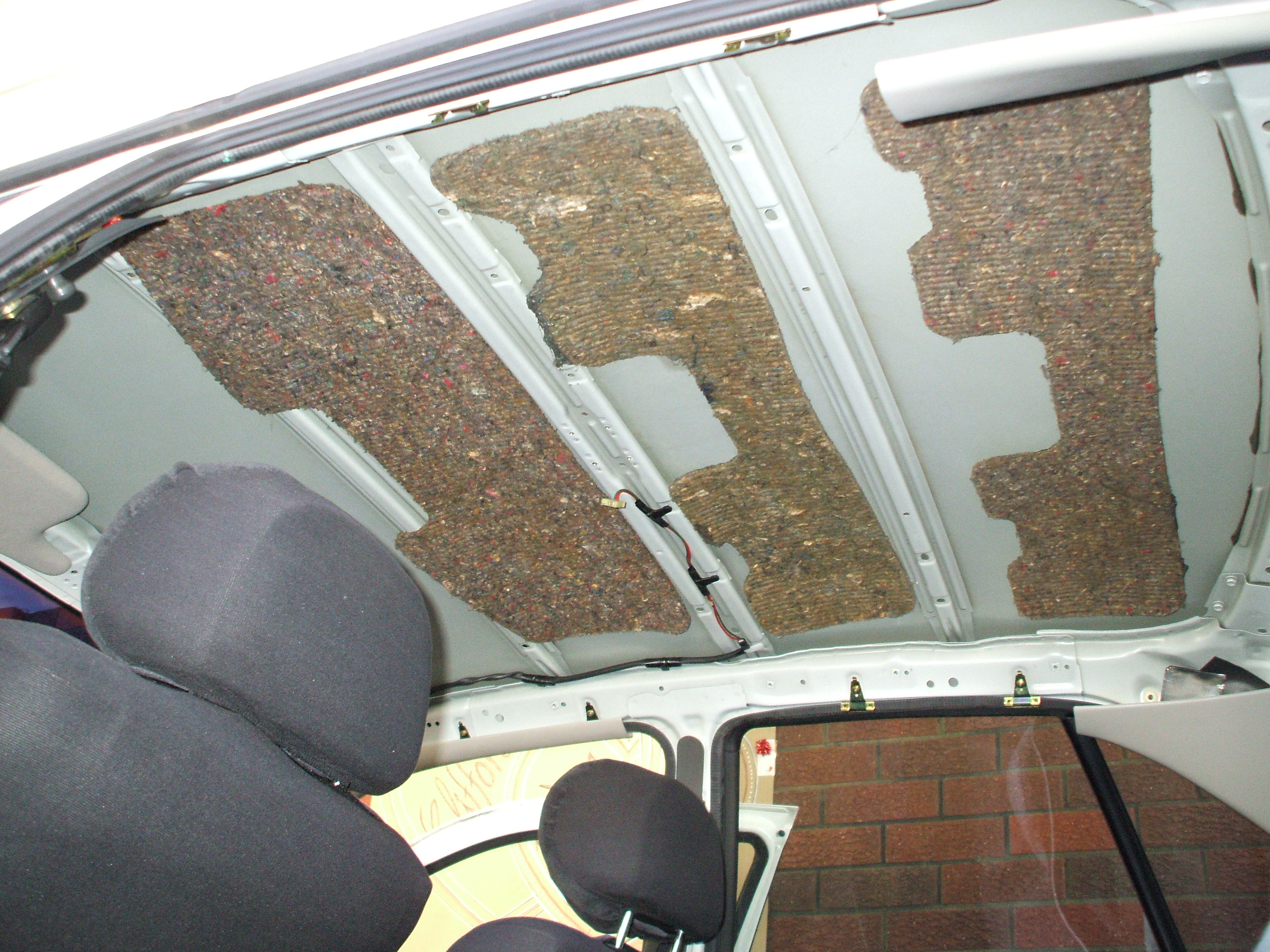

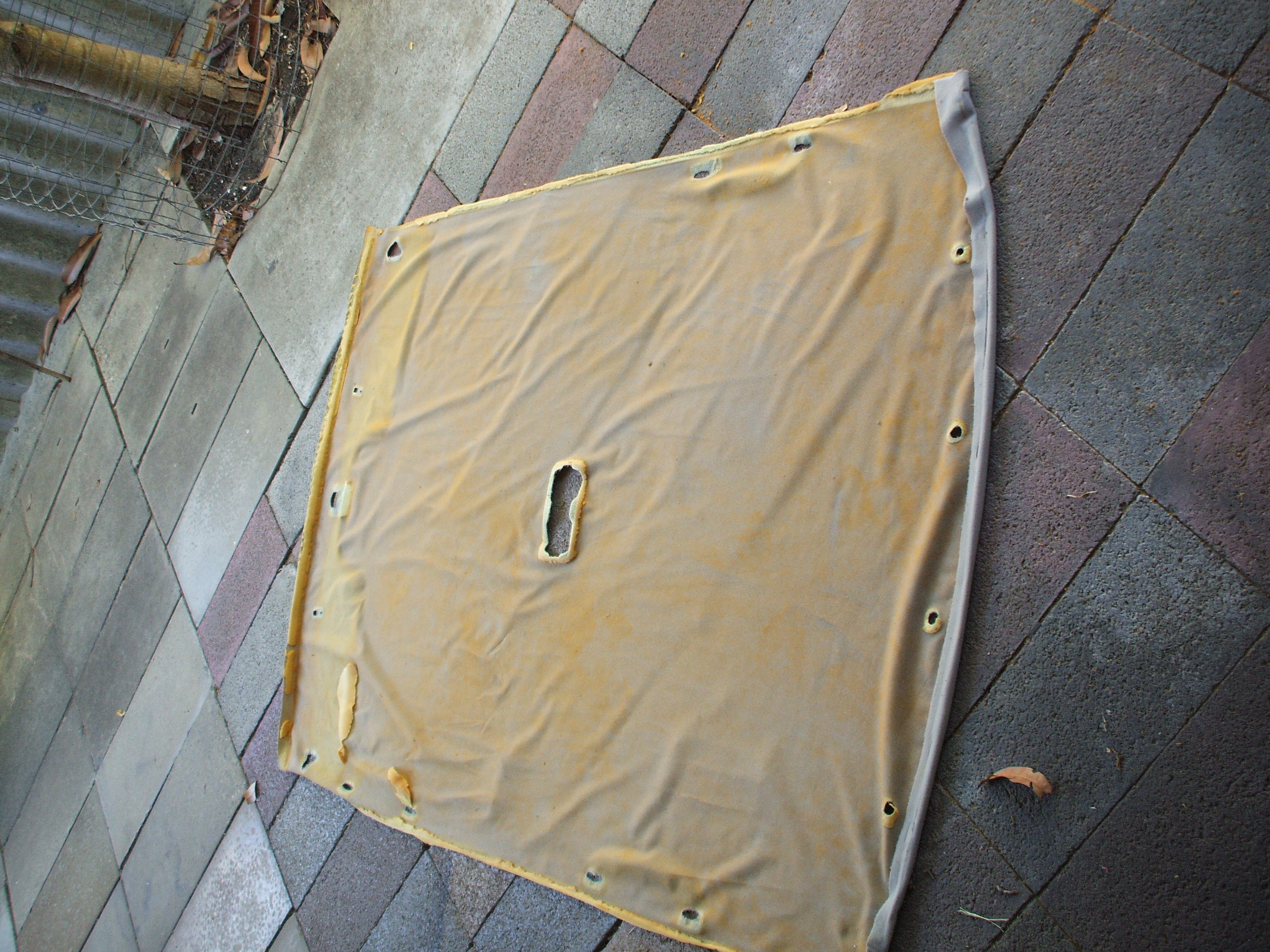

post-11119-1235115877_thumb.jpg ok this is the old headliner that i ripped off the board..oops forgot to take a pic of the board..anyway the headliner was quite dirty and had foam stuck to it wud've have been quite a long procedure to get it all off so i just bought fleece material from spotlight and yea once the old material is off the board will have quite a bit of foam stuck to it so make sure u take as much off just by rubbing with the palm of ur hand

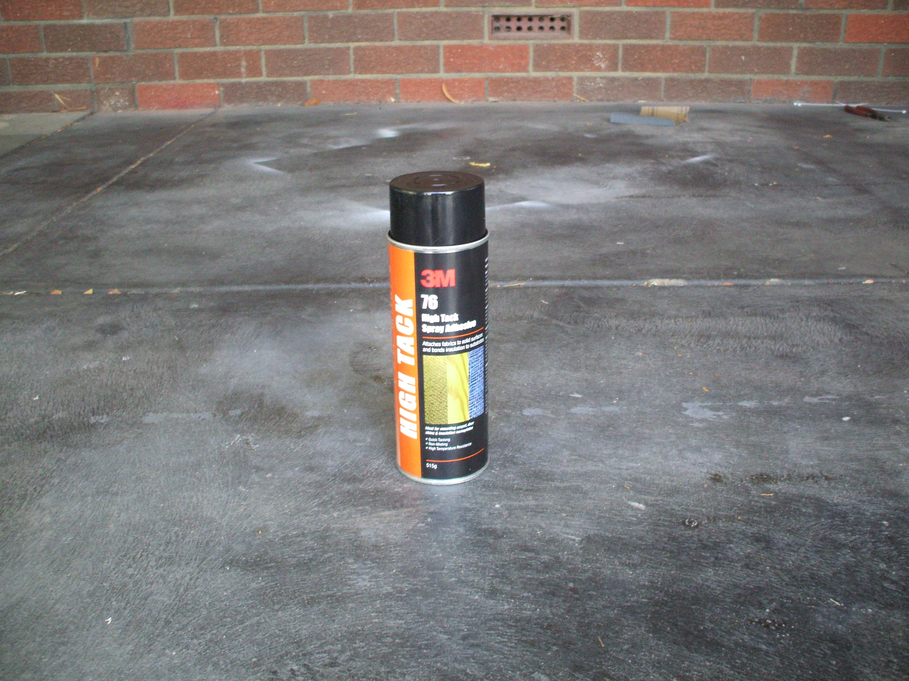

post-11119-1235115969_thumb.jpg ok this is the spray glue i bought from a upholstery place because i couldnt find anything in the auto stores that would stand the heat

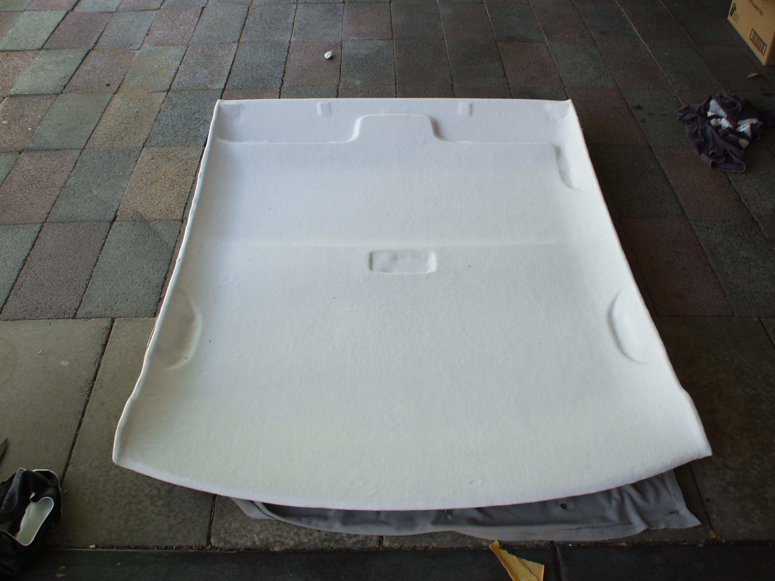

post-11119-1235116004_thumb.jpg ok here i am sticking the new fleece material to the board..make sure u do it in steps and not stick the whole lot at once meaning spray quarter of the board with glue then stick wait about 10 mins and do another quarter and so on

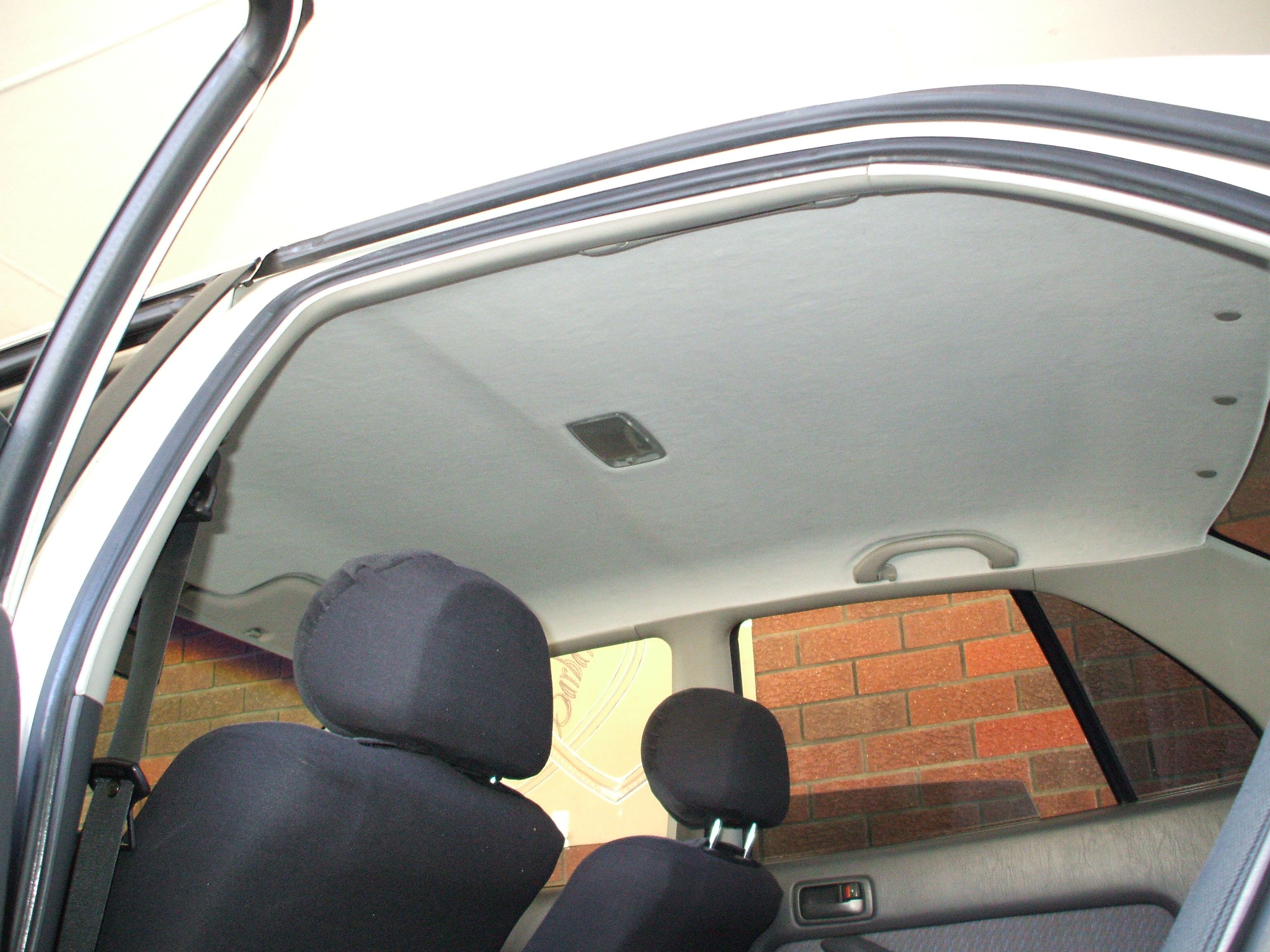

post-11119-1235116045_thumb.jpg here i have fixed it back in the car and all done!! make sure to be careful cause it can break
ok all up costed me 30 bucks for glue and 25 bucks for 2 metres of fleece material....not bad huh compared to the $220 i was quoted for by a pro upholster.
