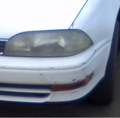

That's not the first step. First step is to confirm what his headlights look like. I say this because the local Camry from around that year had headlights that will be incompatible with projectors. There is the possibility that his import may be the same. My headlights looked like the one below. The front surface is glass meaning that it's not like Perspex where you can carefully sand those ridges down yourself.
Well if it is plastic but still has those ridges on it (used to aim the light), then you will need to have that made clear before you should consider putting projectors in. The process for this involves sanding the ridges down till the surface is flat, then using finer and finer sandpaper and then working to a light cutting paste, you make the surface clear and smooth. This will make the lens surface thinner, but at least it will enable the projectors to do their job.
Have a plastic shop cut and plastic weld a clear panel in there (may have to put a certain grade to withstand heat and rocks - maybe lexan). Easiest but will not be cheap.
