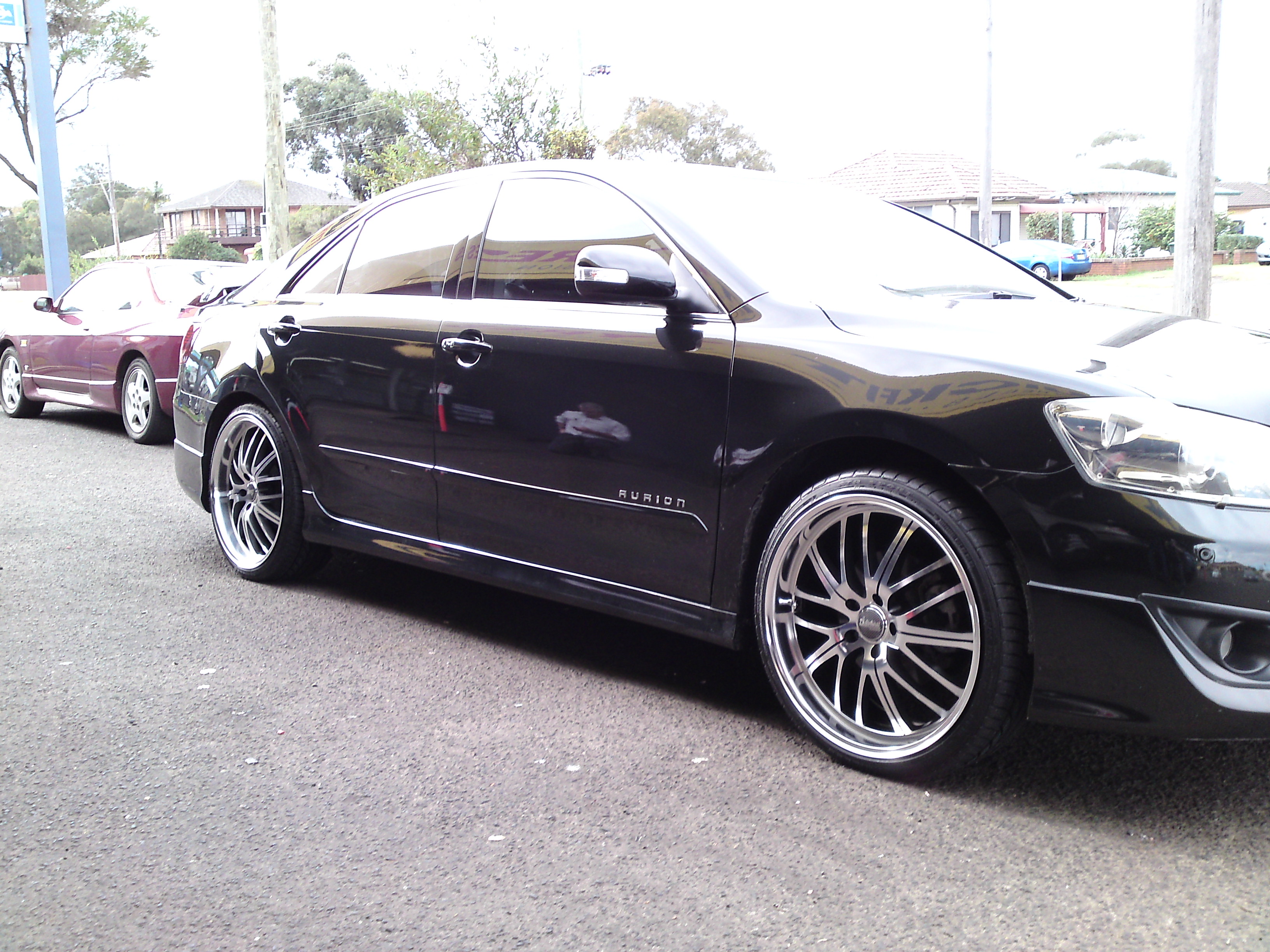

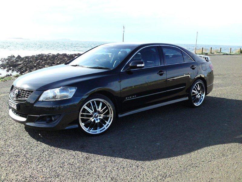

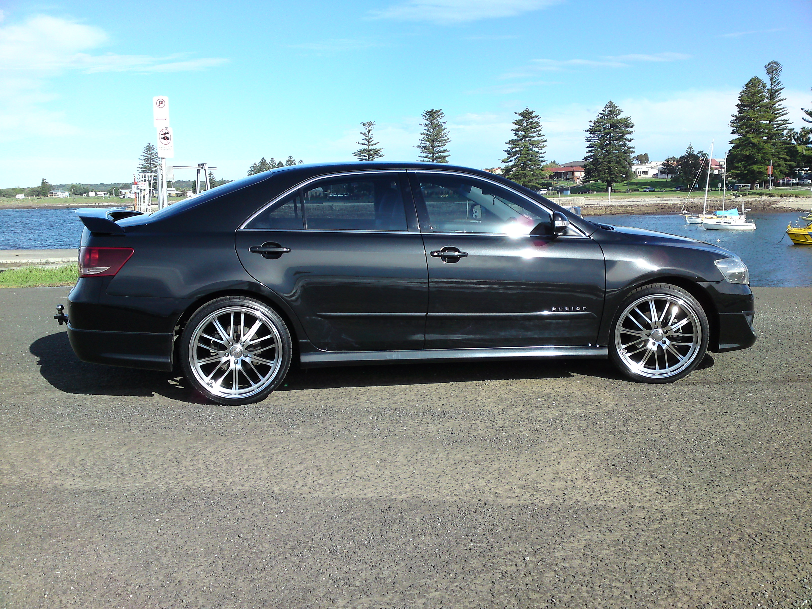

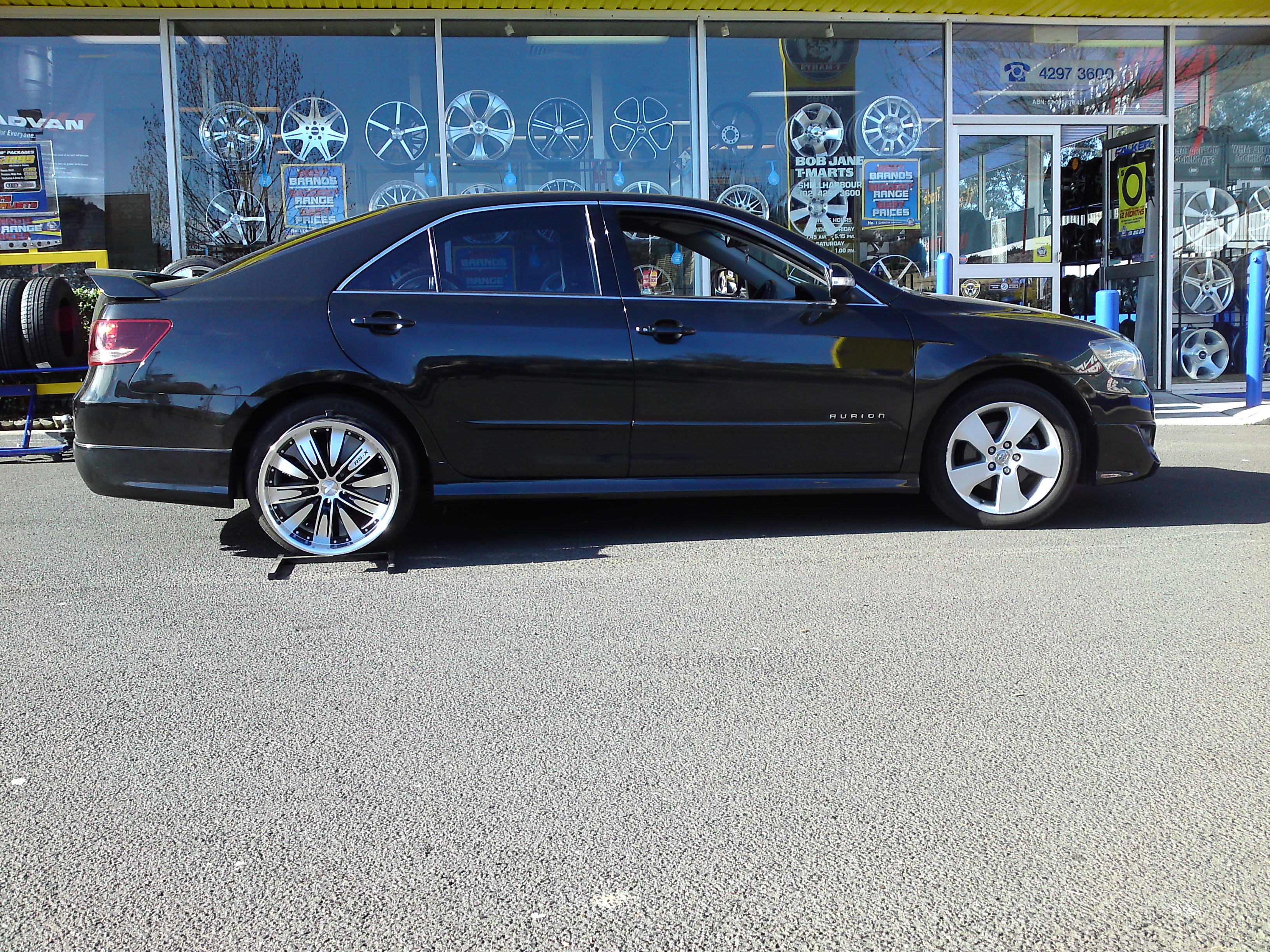

for anyone who is interested 20x8.5 fit, just. tyres are 225/35/20 you could go 245 on the rear and still be inside the guard.
insurance are ok with it, all they are concerned about is getting a higher premium. anyway glad that's over with, found it very hard choosing wheels I liked. ended up with advanti's, added a few pics.

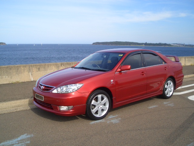

I have the the 17 Inch Toyota Vortex wheels on the Camry.(See below)
