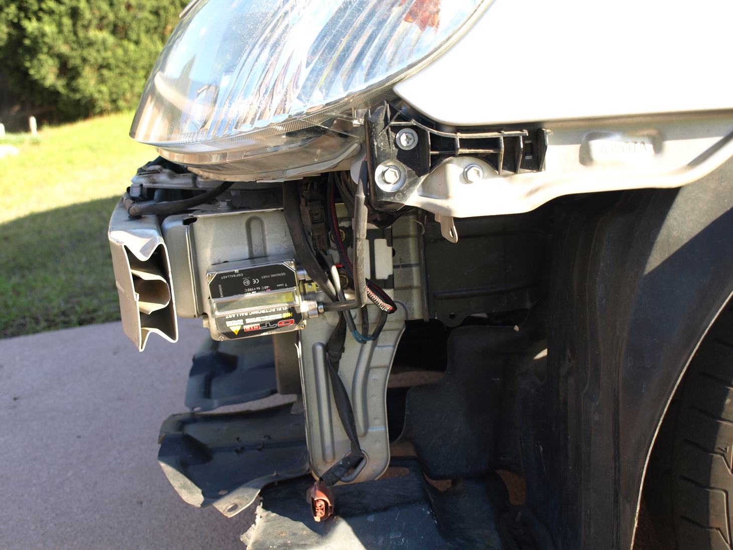

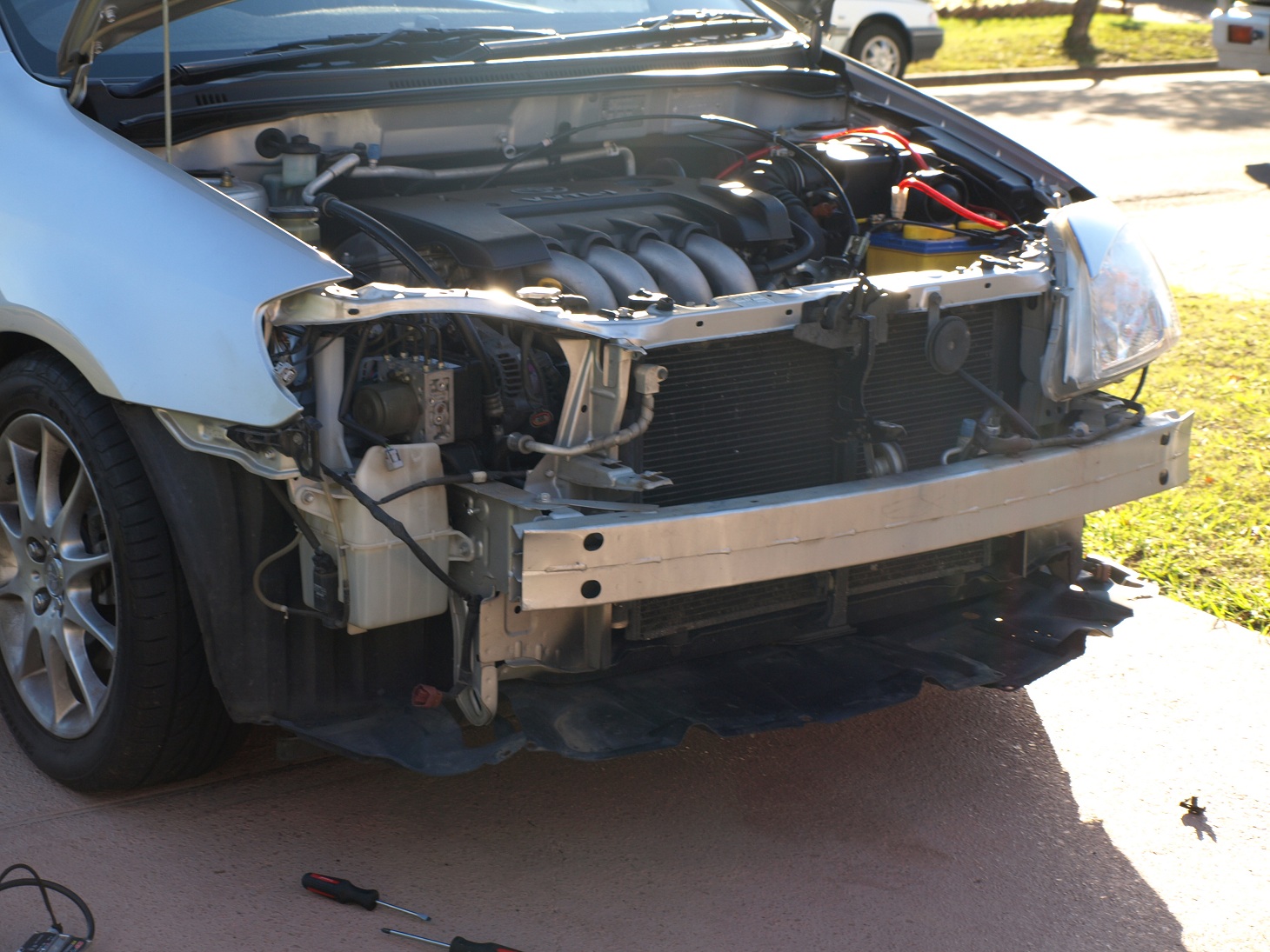

I went all out and removed the Bumper and both the lights to install the HIDS .
I mounted the Ballasts on the side of the Bumper reinforcement bar , this is where most of the straight surface was.
If you have the time remove the bumper and both the lights (saves you from trying to fit your hands in small places).This will inturn save you more time at the end.

Its your bad boy right there , PS i didnt drill holes in my Headlight surrounds ..
Let me know if you want to see pics of where i mounted my Ballasts.

Yeah 03 Model doesnt have the plastic cover .Instead it has a Rubber surround which covers/conceals the clip that holds the globe.
I'm not going to say the cover it not important as it will keep water and dust away but the light will work without it ..
post-9489-128279395138_thumb.jpg Passengers side mount
post-9489-128279400499_thumb.jpg Drivers Light removed
