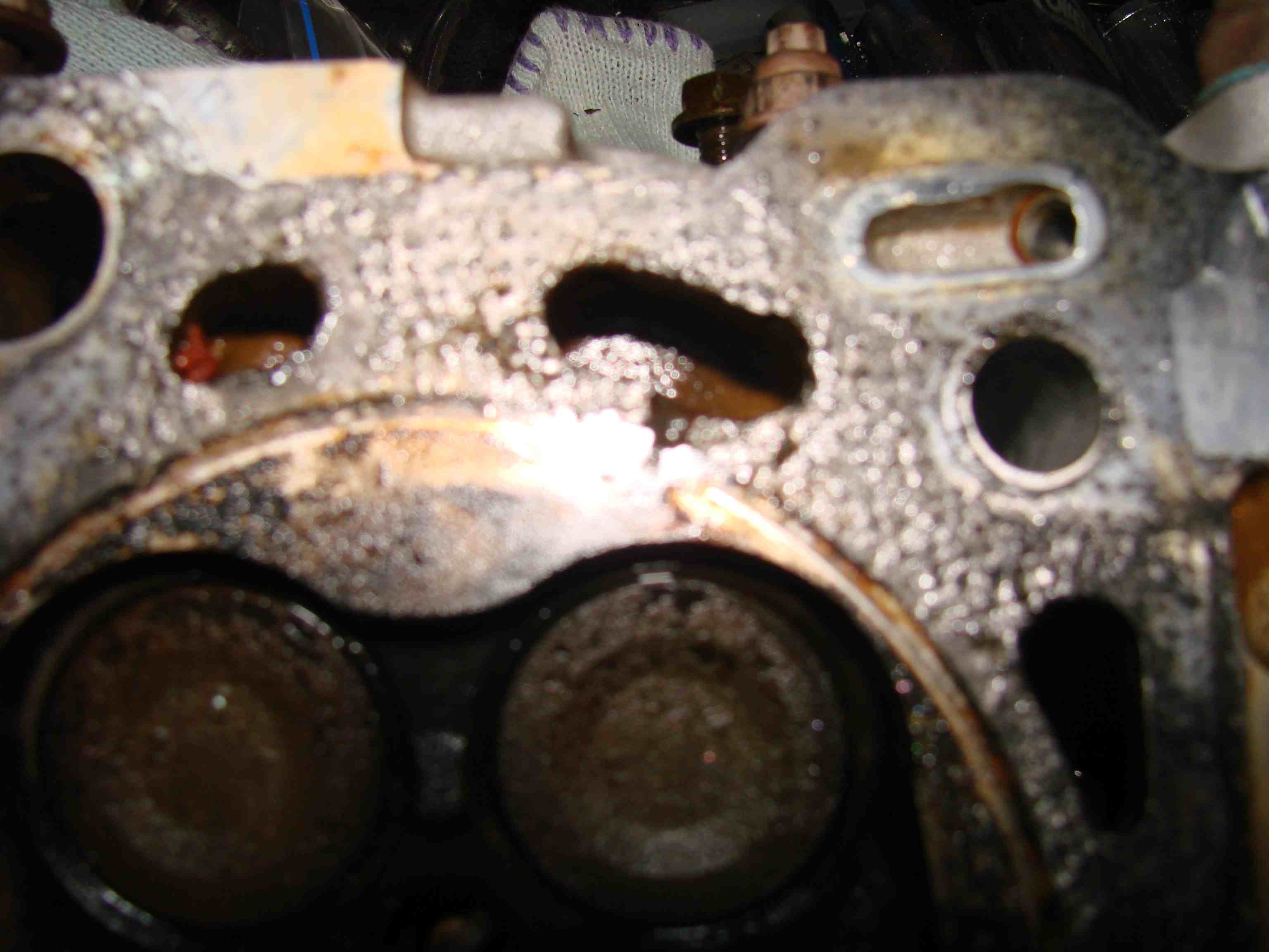

We have a 1996 Tarago that has suffered a complete engine meldown due to a split (plastic top tank) radiator.
