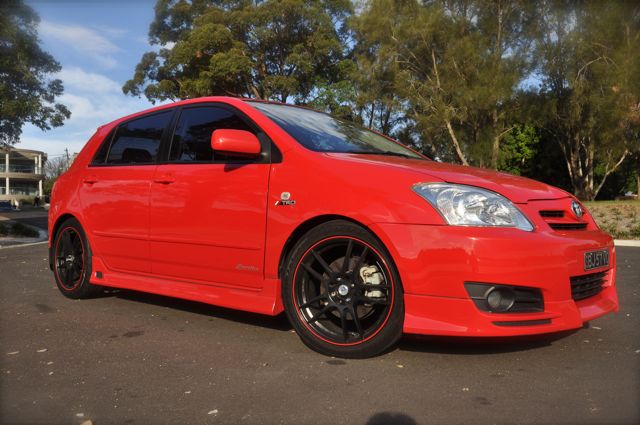

I chucked in a photo of what my car looked like on Pedders Sportsryder springs, bearing in mind that its also on 17s and therefore the gap to the guards is slightly smaller than on stockies (215/45 R17s with rolling diameter of 626 rather than 620). Hope this helps.
