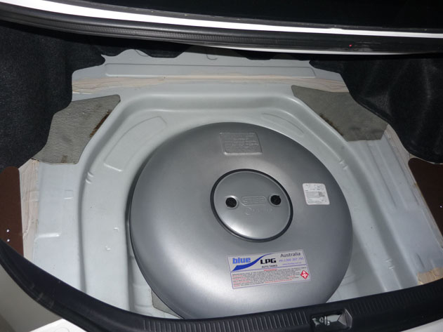

The system being installed is a vapour injection system with a toroidal (donut tank) in the spare wheel well. The usable litres in the tank will be 52lt. The car will start on petrol and once the engine reaches operating temperature automatically switch to gas, if the gas tank is empty it will automatically switch to petrol and of cause I will have the option of manually switching to gas or petrol. When running on gas the lt/100km dash display will not work nor will the distance to empty. Once switched back to petrol the gauges will operate as usual.
I previously had a 2001 V6 Camry converted to gas with a donut tank, virtually no loss of boot space. I say virtually because the donut tank does sit a bit higher than a spare wheel so it does take up a little space

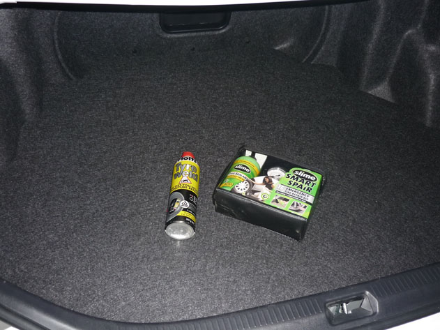

Concerned about punctured tyres and no spare? In the eight years I had my last car without a spare tyre I didn’t have a flat, I always carry two cans of inflate and seal stuff so the only time I would be in trouble is with side wall damage. I have had to use the inflate and seal cans but it was for a mates car when he managed to puncture two tyres at the same time, he had one spare tyre and I donated a repair can for the second puncture and he was on his way.

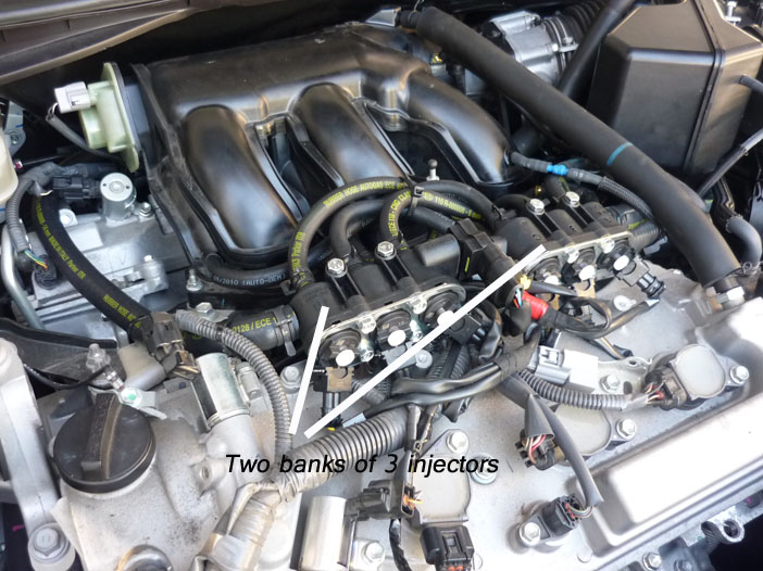

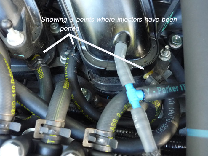

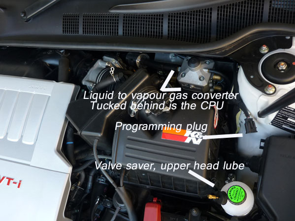

No change to engine for my conversion nor my 2001 Camry. The vapour injection requires a second set of injectors in the head, a converter to change the liquid gas to vapour and a CPU to interface with the Toyota CPU. New engines that are designed to run on unleaded should not require changes in head gaskets or valves. Unleaded fuel does not have the lubrication that lead used to offer in leaded fuel.

Picked up the car today, the people at LPGAS Lilyday are really good. Nice and tidy install they also threw in a puncture repair kit consisting of green slim and a small compressor.
The donut tank does not sit up as high as I thought it would, sits 2cm maybe 3cm higher than the spare tyre would so there is almost no noticeable loss of boot space.
However I was informed the Injection system uses higher pressure than the older systems and I would only get about 48lt usable gas out of the 60lt tank not the 52lt I used to get in my older Camry.

Once I have time will upload some photos of gas cylinder and engine bay.
OK, added some photos.

Now for the install: You will see in the photos a valve saver installed, this is a
upper head lube and was an option I asked for and is not fitted as standard, this helps lubricate the valves and maybe help the engine run a little cooler, fill once every 10,000km or so with valve saver available at nearly all auto parts outlets. Cost about $15 for 1 litre and one bottle should get you about 15,000km. It’s not fitted as standard as installers don’t believe it is necessary in modern engines.
I have only just reinstalled the boot floor board holding the tyre tools and the boot carpet and it sits so flat no one would know there was a gas tank there. I have to revise my previous guess that the donut tank sits 2cm to 3cm higher than a spare tyre, it only sits about 1cm higher.

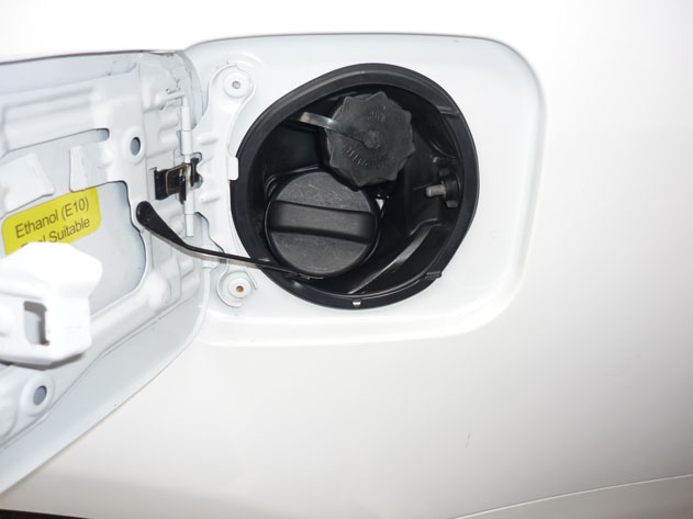

The gas filler sits in nice and snug with the petrol filler. Only notice it is in there when you open it up.

Where is you filler for the gas? Thank you.
Just as SirNed said, it is in with the petrol filler.
Added a photo of filler
