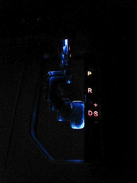

I upgraded to LEDs and changed the colour as shown in the above vid, both of them, allthought the T5 & T10 LEDs are bright they have a narrow beam, that is how LEDs are, the higher the intensity/brightness the narrower the beam, the lower the intensity/brightness the wider the beam of light. My shifter slot/gate whatever you want to call it is blue now, I changed the P,R,N,D-S,+ & -, to red, the 'N' doesn't light up much, infact you can hardly see it and the '-' symbol for the 'S' mode is the dullest compared to the rest but still lights up unlike the 'N'. Still, looks good and you have dash letters to make sure but it's a shame that the 'N' is dull, spoils the whole affect. The pic doesn't do it justice, the 'P' & the 'R' are more red than they appear. Not sure how the bulbs would go changing the silicone covers but LED seems all the go now and they do draw less power and last longer but at the cost of less area being lit depending on the angle of the bulb.
