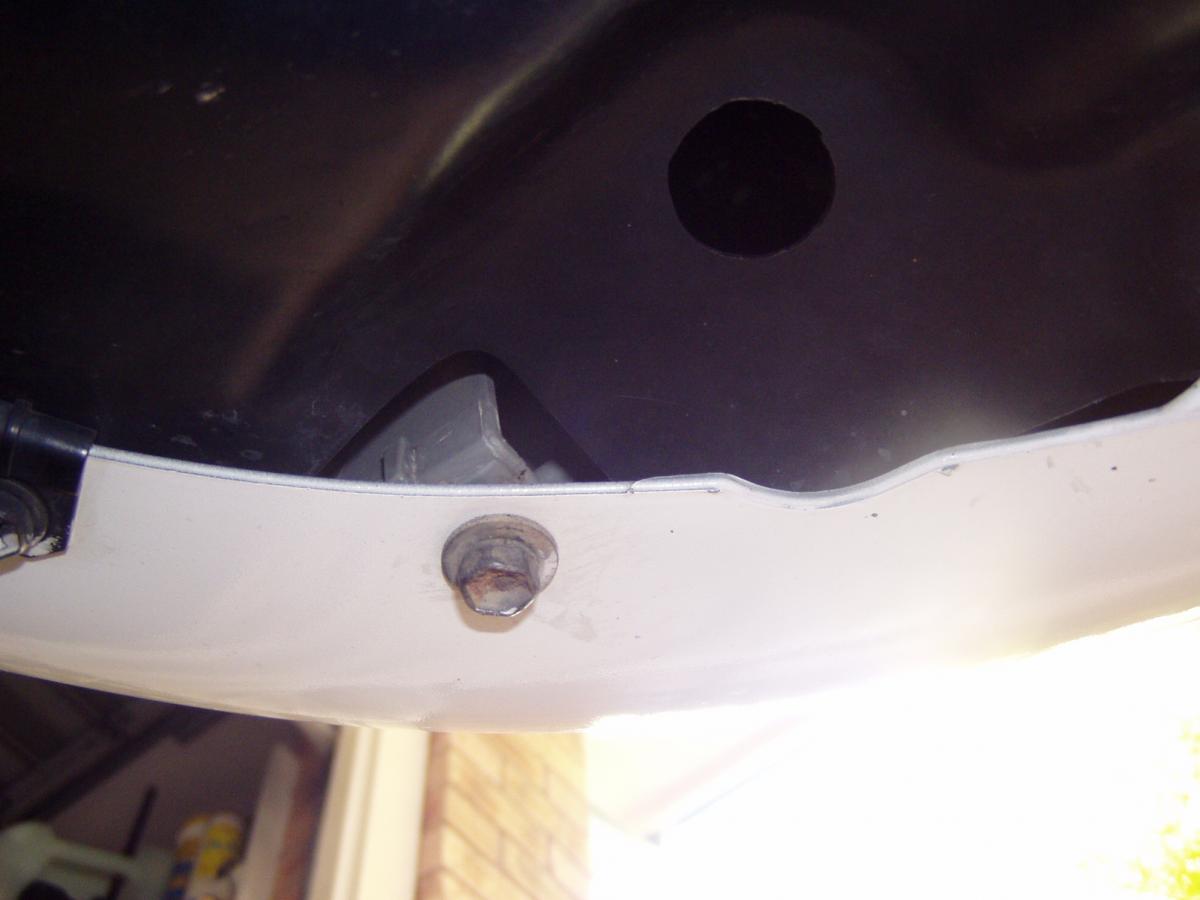

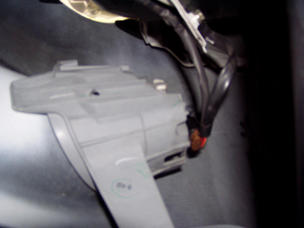

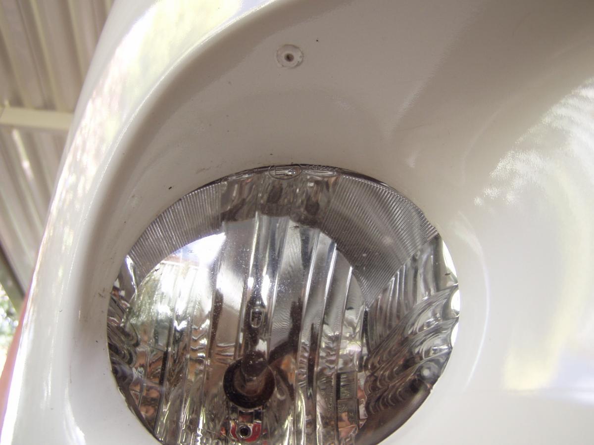

Easy as mate,put the front up on stands,To cut the blank out of the bar use a new blade in a stanley knife and remove it then using the same new blade very CAREFULLY trim it /clean the opening taking care not to go outside the opening,Then position the light in place and you will see where you have to drill a 1/8"-3mm hole on the TOP to rivet the light bracket on,MEASURE-CHECK TWICE & DRILL ONCE and the bottom uses a 10mm small bolt.I got mine from my neigbours front bar after he replaced it with a bull bar

Hi mate,from memory once I had the light in position with the bottom bolt in but only finger tight I held the light in firm against the back of the hole and then used the 1/8"-3mm drill bit in my fingers and working from inside where the light mounts against the top of bar I twisted the drill bit so it left a good impression in the plastic bar,removed the light and continued to make the hole for the rivet as the hole needs to be exactly straight up and down (verticle to the top bracket hole )otherwise if its on an angle once you pop the rivet so to speak the light will not be against the hole and it will be loose and look sh*t.
Take your time once you start the drill bit will go through easy,its a bit of a pain,your fingers will cramp up,if you had like a little dremel easier still.Here is a couple of snaps hope it helps mate,cheers

I tried getting a shot of the top edge of the foggy from inside the cavity but camera was too big to go right up
