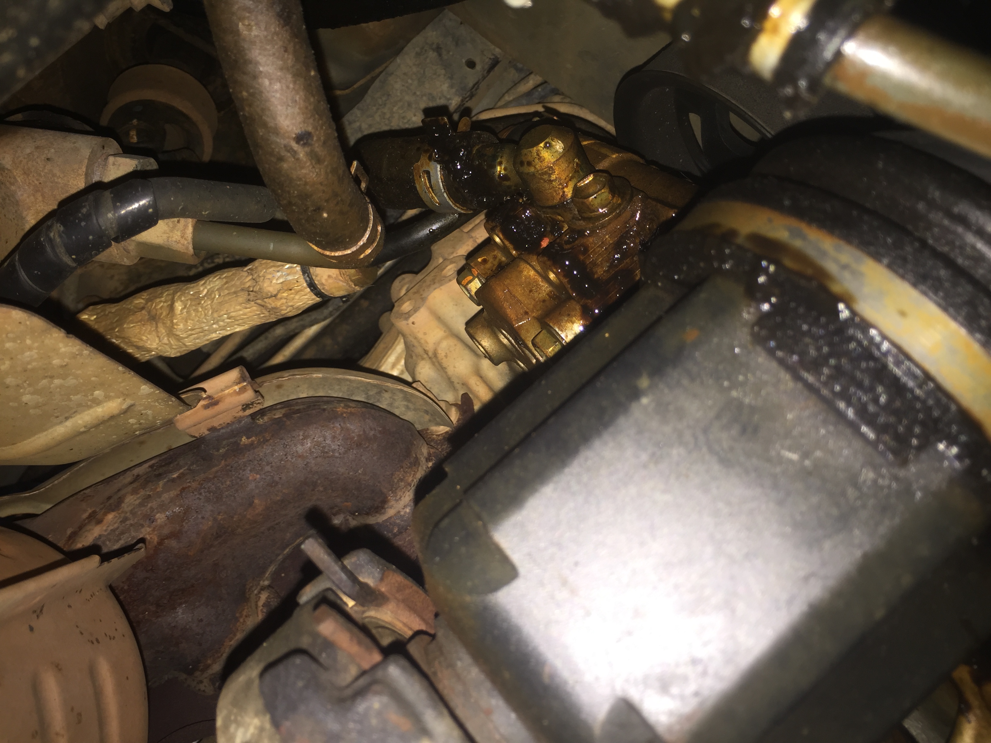

i drove off off my drive way today and saw a bit of oil on the drive way which scared me Abit , so I quickly jumped under the car and saw oil leaking from this location (I'll put up a pic) can anyone please tell me what's going on here ?
Also the car is very loud like tapping noise when I cold start it and in general sounds like a tractor plus I get this loud pig like squeezing for about 10min on a cold start (😑) pls help
The squeal is probably the belt slipping from being coated in oil.
The oil leak appears to be around the power steering pump, but could be dripping down onto it.
Does the rattle last for a few seconds then vanish? If so it is the notorious VVT-i rattle. Expensive to repair, requires engine removal.

The fix involves replacing the intake camshafts and some other components. Due to poor access to the rear cylinder bank, it requires the engine to be removed.
