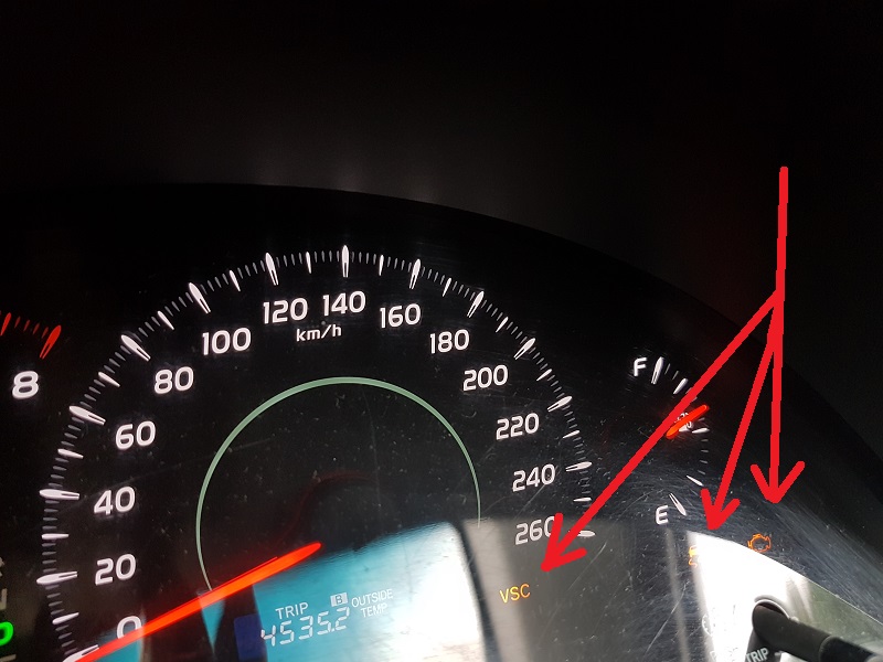

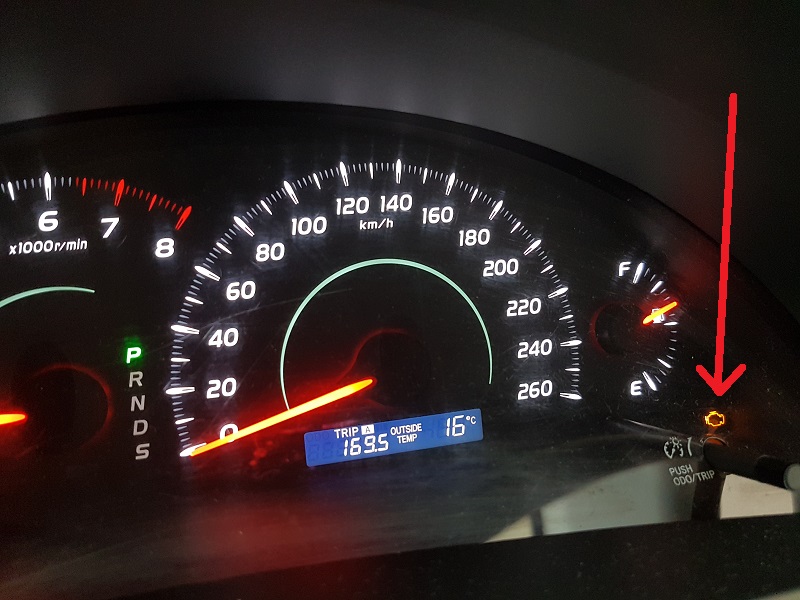

I noticed the malfunction indicator lamp (as per the manual and the attachment) was on. I stopped the engine and waited a bit and started the engine again. It came on, but it didn't go off like it should. So I shut it off.

I waited a bit longer and then started again. Same thing. This time, I let it idle for a few minutes and it never went off. I took it out the carport and drove for about 10 meters and then the VSC light and the traction control warning lights came on, without the malfunction light going off.
