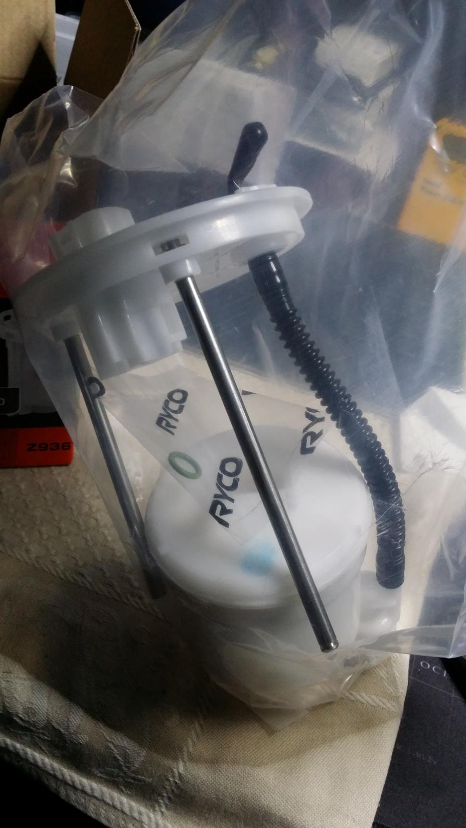

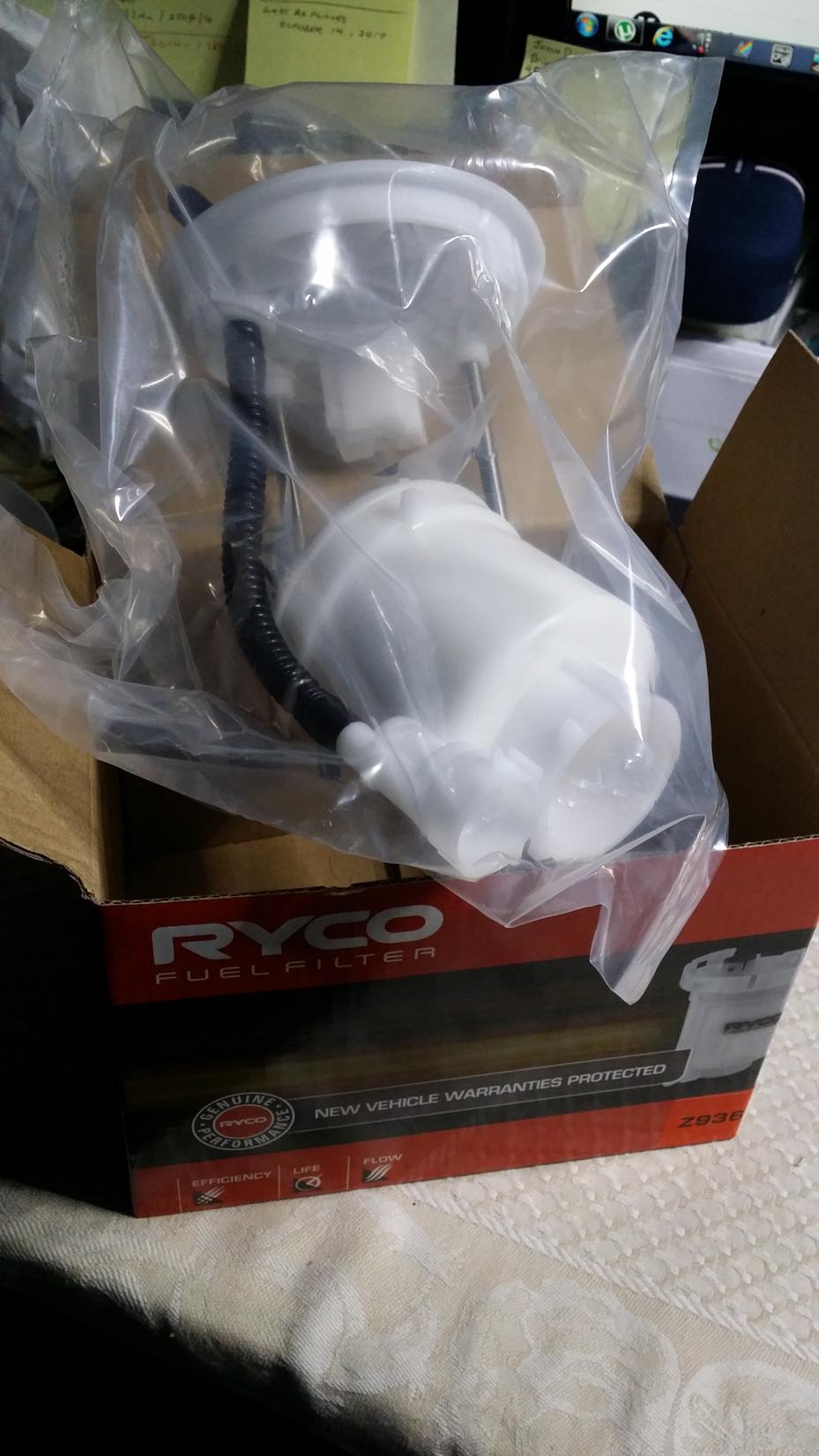

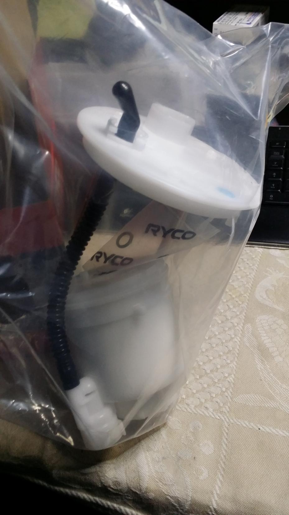

Got my Fuel Filter today. The quality looks top notch from Ryco.
Now I have to figure out how to do it lol.. Thank God for youtube :biggrin:
Does look a first rate filter set mate..thanks for the pic's..and yes now to work out how it goes in and hope it is a fairly straightforward procedure

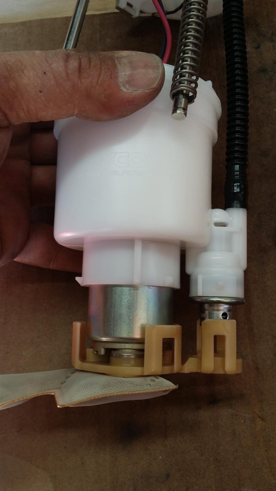

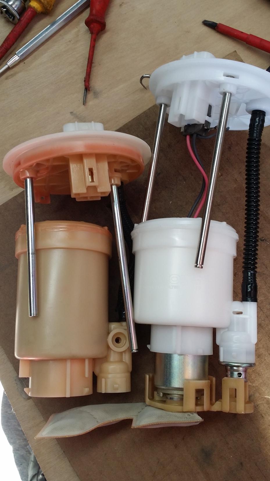

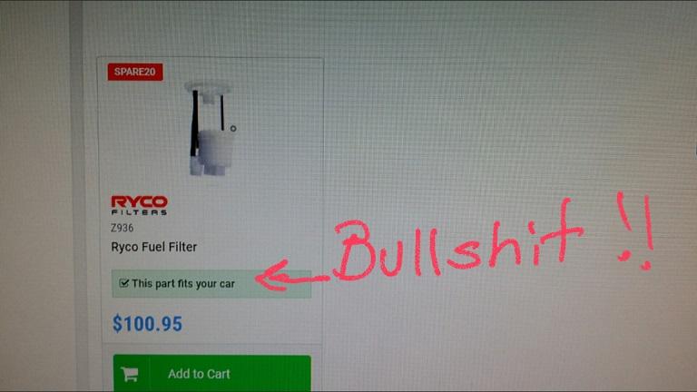

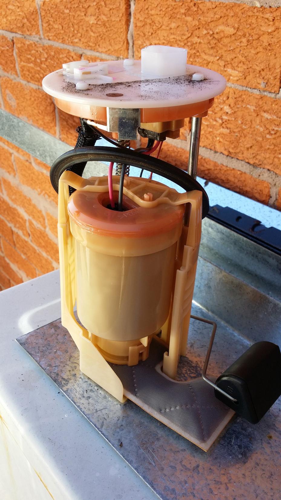

Turns out the Z936 Ryco fuel filter doesn't work with the original sender assembly for a 50 series Aurion. I had to find out the hard way unfortunately. The filter section on the Ryco is too short to allow the base clips holding the pump to actually mate up and click into each other. ARRGGHH !!!
Wasted like 2 hrs finding this out. Despite the website saying that the Z936 fits the 50 series, It's actually wrong so please whoever has a 50 series Aurion DO NOT buy a Ryco Z936 because it won't work.
If the Z936 doesn't work for my car, I wonder which car it's actually for ???
I will never trust those stupid fitment guides on websites anymore.

Damn Tony..what a lot of work for no outcome, I am sure they will refund..but yes if it doesn't fit the 50 series what does it fit??..and from the pic's it get's nowhere near clipping on the base..Let us know of any reply you get mate

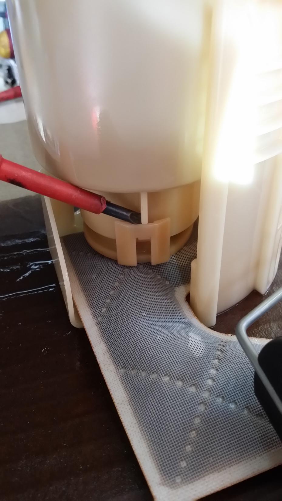

Looks like you did clean the pick up screen as shown in this YouTube video. At least the 2 hours would not have been totally wasted.

Nice pick up there Ash. The innards were black. I used brake cleaner to push all the crud out and it's as clean as I could get it. At least some of the time wasn't wasted, you're right, but a damn frustrating thing to have to go through.

Precisely Robert. It kinda looks like the Aurion assembly but the filter section is totally wrong.
If you look at the Ryco website  for Aurion "filters" selection both 40 and 50 have all their respective filters listed except for the 50's fuel filter where it's actually blank for some reason.  https://www.rycofilters.com.au/Search/SearchResult?make=TOYOTA&model=AURION&year=2012&liter=
That should've raised the alarm bell for me but never thought much of as the Genius sellers with their fancy "Fitment Guide" seem to know better.
I'm suspecting that either the Z936 belongs to another make of Toyota, perhaps Camry ??, or they just got the design horribly wrong.

That aligns with my thinking that there must have been enough feedback to Ryco that they have now changed their current fitment guide for the Aurion 50 series to blank. A lot of sellers must still be using an outdated fitment guide.
Ryco catalogue shows Z936 for the ASV50R Camry with the 2.5 litre engine. Just guessing but I would not be surprised that the fuel pump in the Aurion is larger/longer which your photos appear to indicate.
That makes sense. I will never trust so called "fitment guides" again. Better to send a message to the seller and confirm instead.

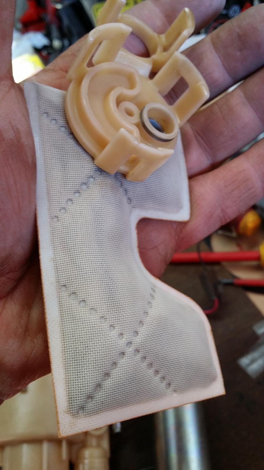

My apologies but I thought I had no before shots showing the blackened pick up screen. Had another look and here they are. Before and after shots.
Next time I have it out, I'll give the screen another hit.
