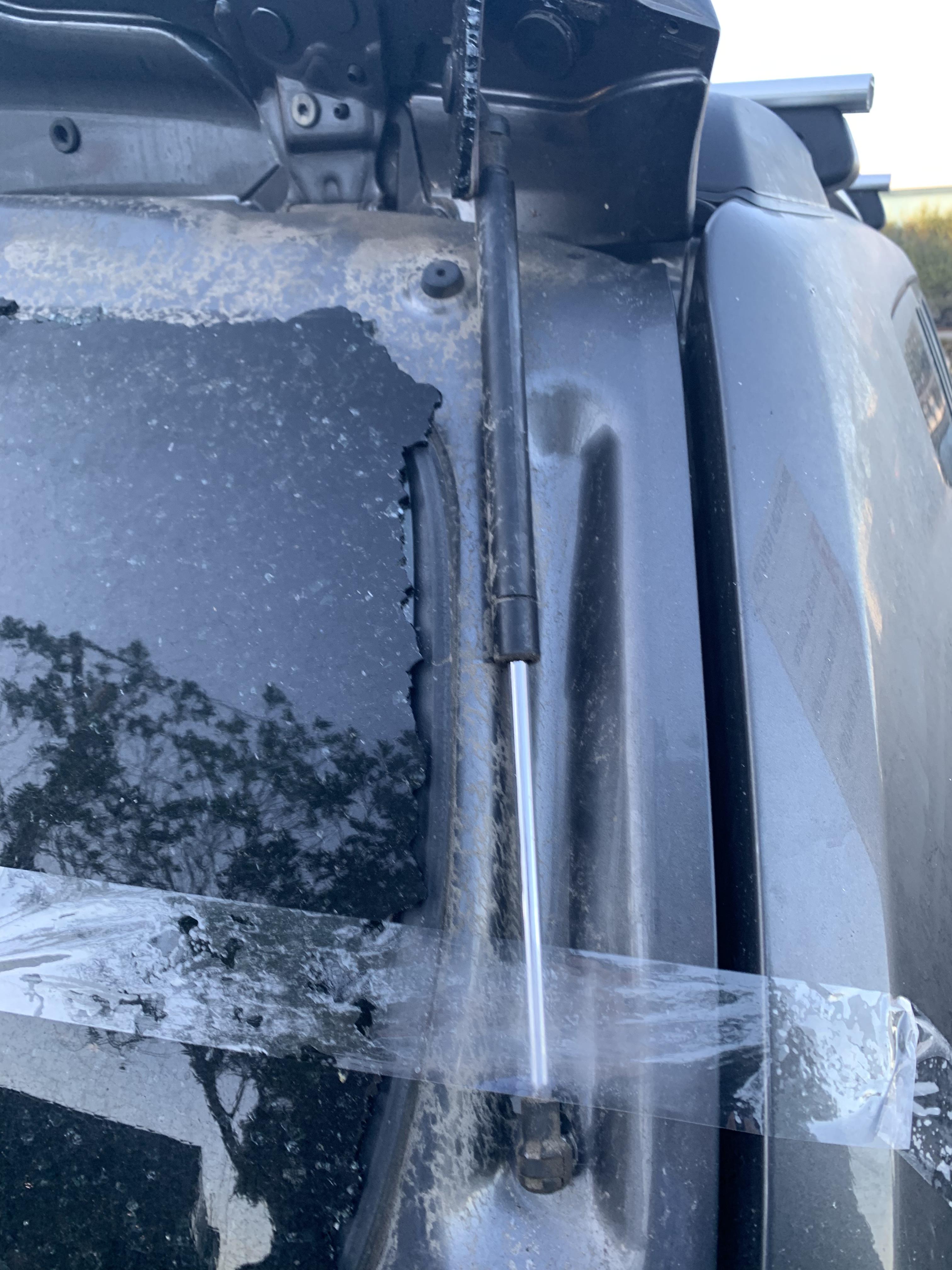

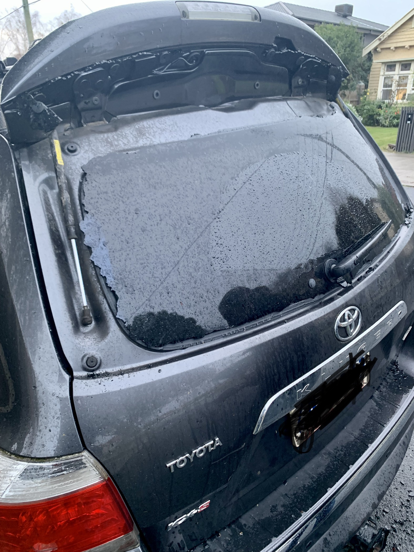

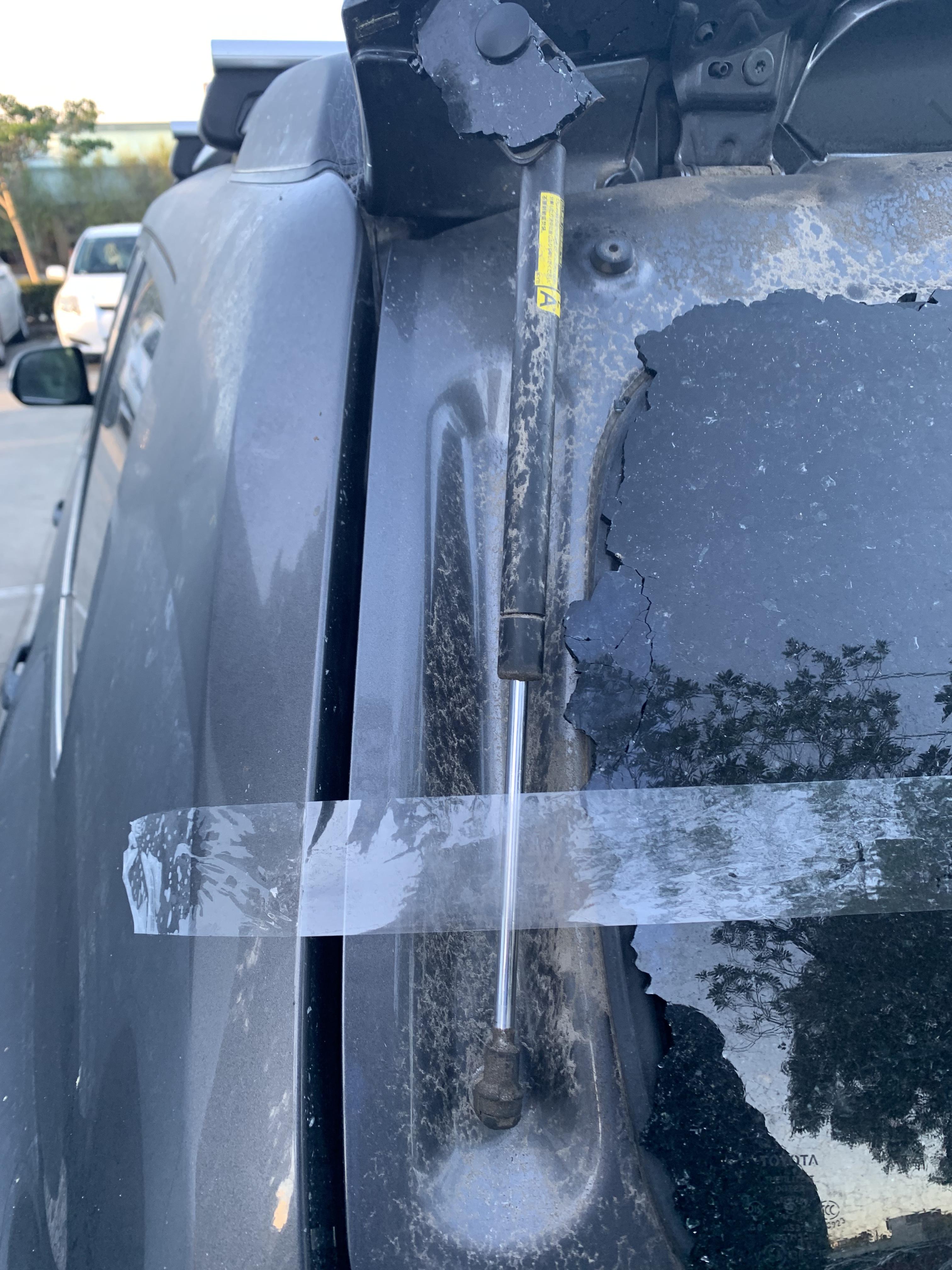

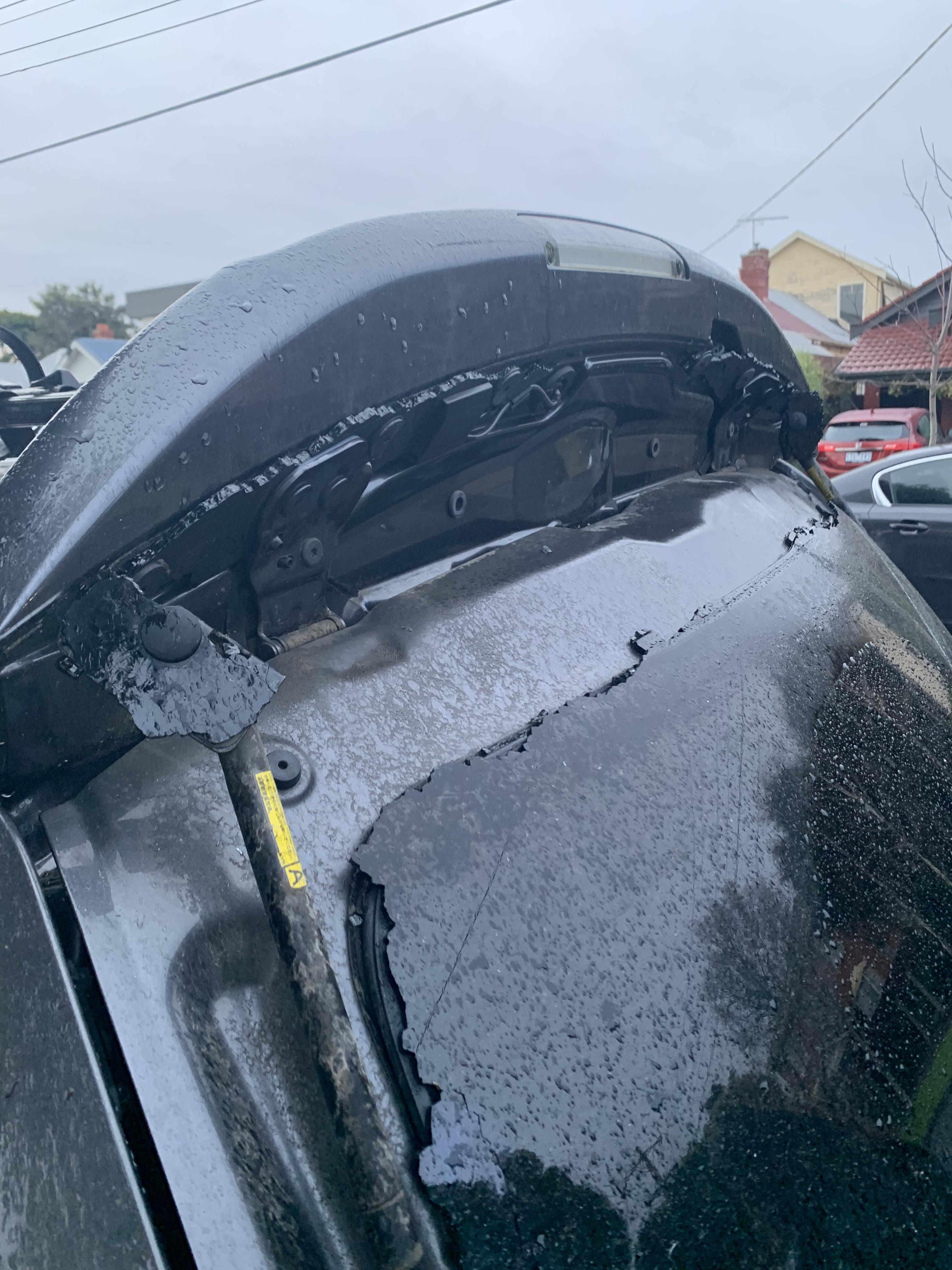

Came back to our parked Kluger yesterday to find back glass shattered and the gas struts that lift the boot in the open position.
Glass all over road, rubber seal hanging over tow bar.
It’s like the gas struts ‘triggered’ and tried to  open the back window but effectively blew out the window.
Anyone ever heard of this?
Car got towed to dealer..awaiting their views. Out of warranty of course.

Bit late to the party, but gas struts don't "trigger", they are always loaded when compressed and it is the release of the latching mechanism (on the hatch itself) which will cause it to open.  Obviously in this case the failure of the glass has disconnected the latch from the struts, which then extend out easily as they have no resistance - they are sized to the weight of the complete hatch (you'll often see this on cars which have different struts depending on whether the hatch/boot has a spoiler or windscreen wiper etc so extra weight) so the lightweight spoiler on its own is relatively nothing.
Now, the glass could have failed _because_ the struts were putting too much stress on it, but the glass would have to have been weakened by some other factor (either a defect, weather, or some kind of damage/impact/stress) in order to fail otherwise these would have been popping left right and centre from the day of manufacture (gas struts often lose their "strength" over the years too which would impart even less force as the car gets older, which leads to them getting replaced).
I concur. Given the stresses involved in holding the glass shut and the curvature of the glass I'd say that it has an inherint design flaw. Anything short of a scientific analysis we will probably never know for sure what the root cause could be. It could be come down to the quality/recepe of the glass itself perhaps.
One of the problems with glass is that it is very brittle - if it is constantly under stress then one small crack or weak point can make the whole thing fail, often instantly and catastrophically (especially safety glass).  Just look at the videos of people throwing ball-bearings at windows
Frameless rear hatches (ie with the latch, hinges and struts bonded to the glass) have been around in various cars for decades though, so I doubt there is some fundamental design flaw with Toyota's implementation in this case.  More likely either a defect or unseen damage.
