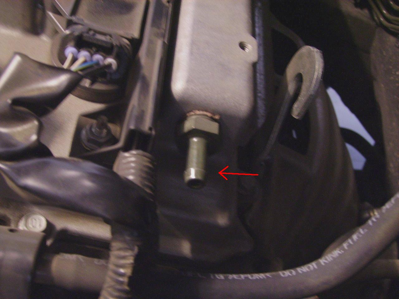

On sunday I have installed the Oil catch tank
1. Remove the hose from PCV
2. Insert a new hose to the PCV that will enter on thr OCT
3. Insert a metallic grill to withold the blow-by gas
4. Fix the OCT on the engine bay (I have fixed rear to the radiator)
Insert in enter to the OCT the hose from the PCV and in exit to the OCT the hose that re-enter on the engine. (you can re-use the original PCV hose)
Ok now your engine aspiration will be more clean, and you will not suck the blow-by gas.
