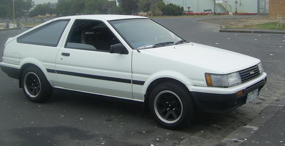

Practically all new cars these days, FWD or RWD have a high positive offset. The old rule of thumb of "Positive offset for FWD, zero or Negative for RWD" no longer applies.
Secondly, the wheels you have on the AE86 are 14" MA61 mags, with a 4x114.3 and about +8 offset, and wouldn't have a chance in hell of fitting on a +40 4x100 Corolla. And there aren't many, if any aftermarket wheels in that kind of design that would fit either.
