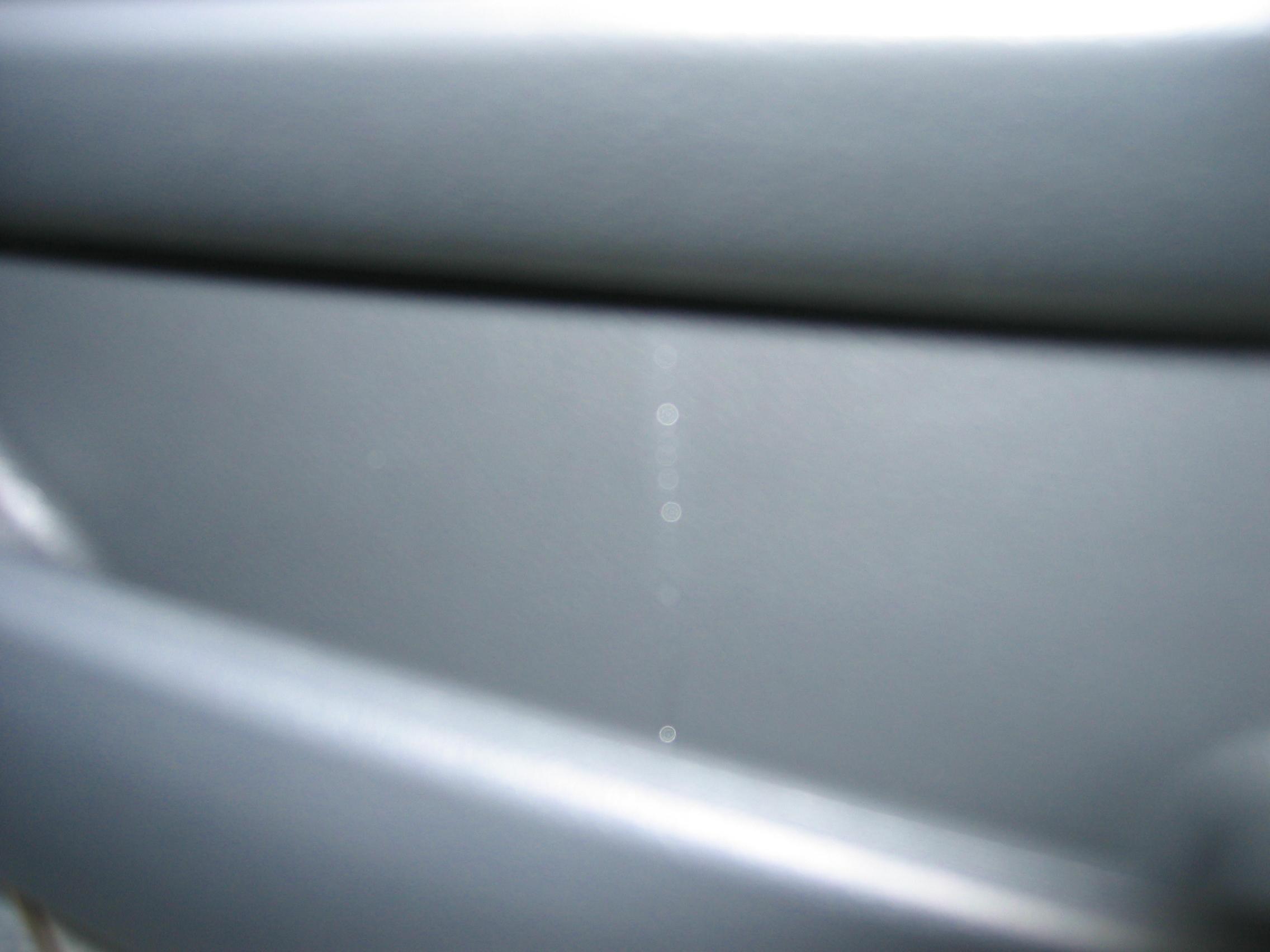

I took it to my audio installer and showed him a pic of when it was dripping. He was surprised to see it. Anyway, he opened the door trim and checked the surrounding. Everything was completely dry. The speaker looked ok and the surrounding area did not have any moisture. Mind you it's been three days since the big rain. Also reviewed the area and it looked completely sealed. He mentioned that if there have been water inside, the material in the speaker would increase in size. There was none of that. We just put it down to condensation. The speakers still work and they sound the same.

It rained heavily again in Melbourne on Saturday. Pretty much right on quue, after nearly an hour driving, I see some water dripping from below the speaker grill in both the driver's and front passenger's doors. See attachment.
Anyone else notice this? Everything else is dry. As mentioned before, if there is a big leak in the door, I would expect to see more moisture getting into the cabin.
