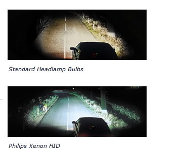

HI Also found some other info that might be useful:
http://www.lighting.philips.com.au/au/en/P...amp;div_id=cat2
this is a link to the philips Australia Auto Lighting webpage, they have a selection of different types of halogen lamps that are now much brighter and closer to that Xenon Discharge look but still street legal for you Kluger.
Also see attached photo to see the difference in the type and colour of light. (Between a standard Halogen globe, not the new full on bright ones, and the HID Xenon discharge lamps)
Hope this is helpful.
