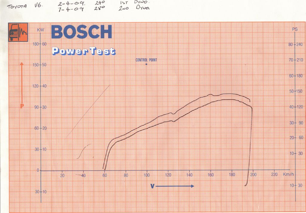

I've already put in extractors/catback + rerouted air intake with good effect (see dyno chart). I've been reading around and apparently it may damage the engine, which means I'd need to replace things within the engine which could get expensive.
