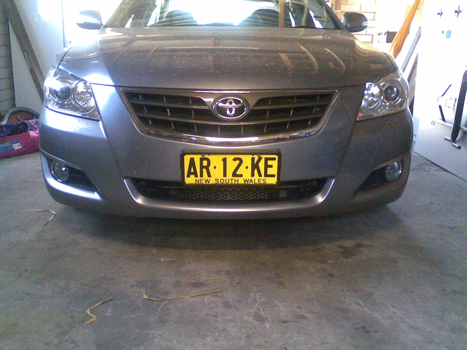

Mesh front bottom
httttt

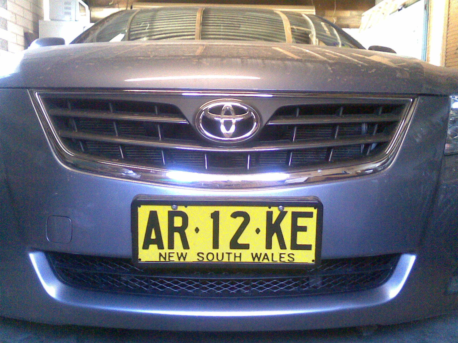

I took the entire centre grill section out, cut the mesh to a perfect size, and then drilled small holes for cable ties to go through. When it sits in it's place, you barely even notice the ties.
An example photo. Excuse the dirty car. I can't help it right now:
Done :yahoo:
This was a quick and easy mod.
A tip for others: Focus on the bottom of the grill and the placement of cable ties and where you cut the mesh because the top wont be seen.

Hi there...
stedyedy...think you are talking about the top grill.
ApBPaul...here's how I did mine.
1) Crawl underneath the car and unscrew the two plastic panels under the engine.
There's approx 5-6 screws in each and about 3-4 plastic clips which push in (use
a screwdriver to pry them out).
2) Once the guards are away, reach in and unclip the 6-8 clips holding the lower part
of the lower grill in place. They should pull straight back, but you may need a flat
bladed screwdriver for a couple of them.
3) Whilst holding the bottom section out, work out the clips on top of the lower grill.
Again you may need a flat bladed screwdriver to help you here.
4) Once all clips undone, simply lower and turn the grill to manoeuvre it out the
bottom under the front spoiler.
For meshing, I simply took my time and measured and trimmed by placing the mesh on top and working away at it. You can cable tie the mesh to the lower grill without drilling any holes and it will end up looking really neat. Any rough edges and cable ties will generally be hidden around the edge of the lower grill which gets tucked up behind the spoiler when in place.
Hope this all makes sense.
Here's what mine looked like.
Happy meshing...show us how it turns out.
Cheers Michael
