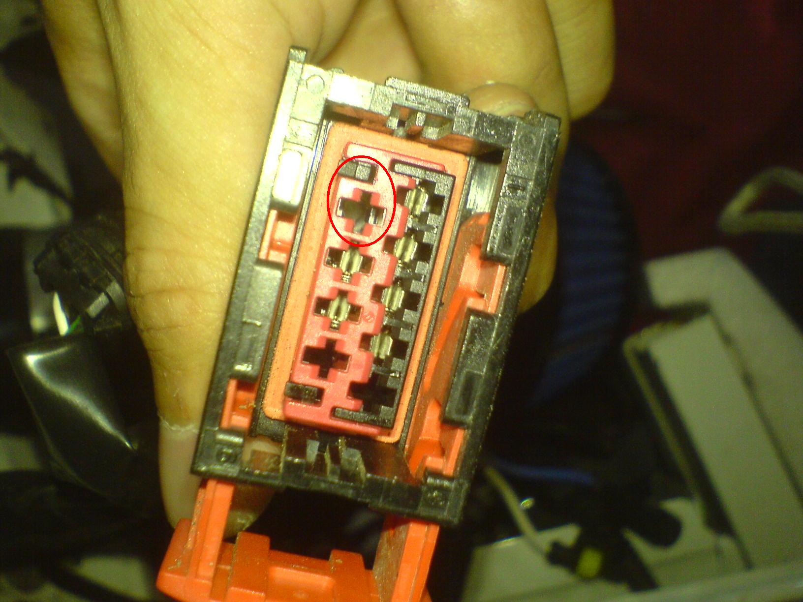

with help from TOCUK, i wired the actuators to a headlight beam control switch (GBP 5) following the electrical diagram:
my corolla was not prewired so i bought the 5 pin connector housing ($11) from toyota and made the harness.
not very exciting to watch but here is the result
Please wait a few seconds for Video to Load!
overall, didn't cost much at all (5 pounds + $11) and quite satisfying to unlock a hidden feature in the corolla. is it worth doing? probably not lol :D
sorry for no diy yet, just waiting for some crimp terminals to arrive to complete it.
i got the switch from ebay UK. its from a toyota avensis. toyota part number is 84512 12060 http://www.toyodiy.com/parts/p_J_2005_TOYO...PNK_8401.6.html
the 5pin connector housing is 90980-10789. i modified female econoseal crimp terminals to fit in the connector.
basically have one wire for each headlight and connect to this empty pin slot: (this connects to the green coloured wire inside the headlight)
connect those wires to pin 2 of the levelling switch
tap parker/taillight wire from headlight dimmer sw (pin 10) to pin 1 of levelling switch.
pin 3 is for switch illumination so connect to pin 1 for power
ground pin 4 and 5 to chassis

hmm that plug looks quite different to mine. that green wire is on the engine side? its probably to the parker light wire.
is there a green wire "inside" the headlight housing? near the low beam reflector?

green is engine side, headlight side is just yellow white black red as u can see from pic
havnt pulled headlight apart, not going to !

whats that red wire in the distance?
That connector doesn't look like it can accomodate another wire for levelling unless there are other wires elsewhere.
