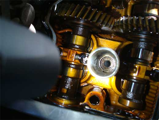

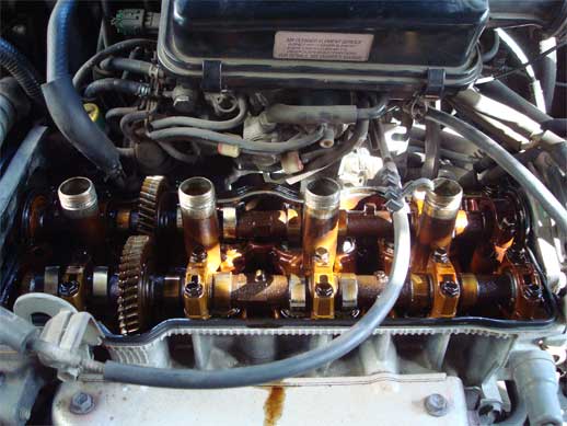

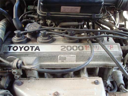

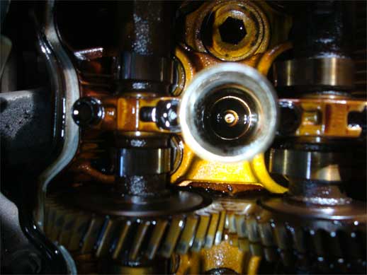

I had oil in the spark plug tubes of my '89 SV21, and I hear it happens often with all engines designed this way. I researched it and had a go at fixing it. I read a lot of posts describing the procedure but there were very few actual photos. So here are some I took. Hope they you if you are attempting this job on their own. It's not too hard.

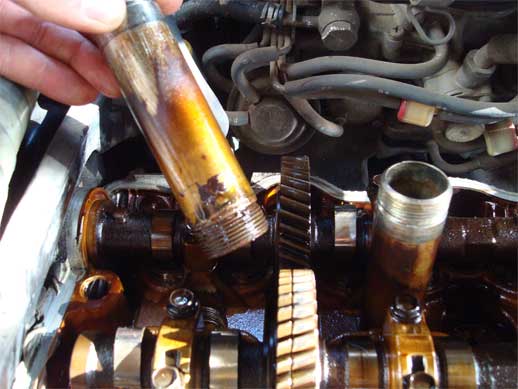

A 30mm socket is required to remove the four nuts holding the rocker cover on. Vice grips worked unscrewing the tubes.

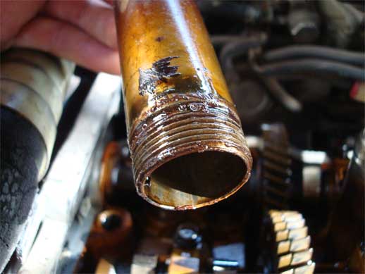

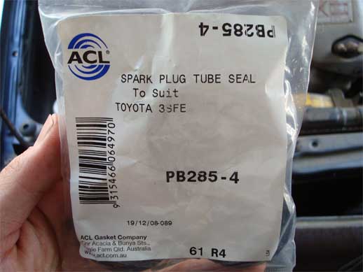

You want to clean the thread and re-seal the bottom of the tubes with a high temp sealant, and replace the seals at the top of the tubes. A set of these was $25 at Repco.

rubberowner, great post with the photos. I think I have the same problem so am probably have a go at fixing once it's all clear to me. Your photo 'tubes exposed' does not show any seals at the top of the tubes? This doesn't quite make sense to me, I thought the oil would be leaking in at the bottom of the tubes and therefore expected that this is where the seals would be. Appreciate it if you could clear this point up for me.
The top tube seals are under the 30mm nuts. It seals the gap between the underside of the valve cover and the top of the tube. When you take it off, you'll know what we're talking about.
Yes, it generally does leak in from the bottom - from the old factory 'thread' sealant wearing/degrading. You can try tightening the top valve cover nuts a little and see if the oil leak stops - if it does, then you know its the top seals. If it doesn't then it's most probably the other end but seal up both ends as safe measure. You'll be fine using RTV or the like - DO NOT use a threadlocker like loctite. Loctite doesn't seal and you you want sealant to do the sealing - so it's not by how tight you can do the tube up.
When taking the tubes out, be careful with the pipe wrench/multi grips/ vise grips; you don't want to and gouge the tube up.

I ended up using "Permatex Hi-Temp Red RTV Silicone Gasket Maker" for the bottom of the spark plug tubes and the head cover, I'm still not 100% on whether this was the right / best option...
A quick drive felt good, however I'm letting it sit overnight (to let the RTV fully set) and will have a good test drive tommorrow.
