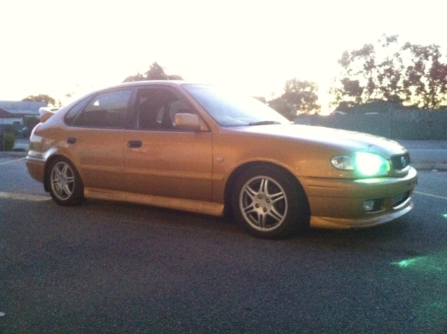

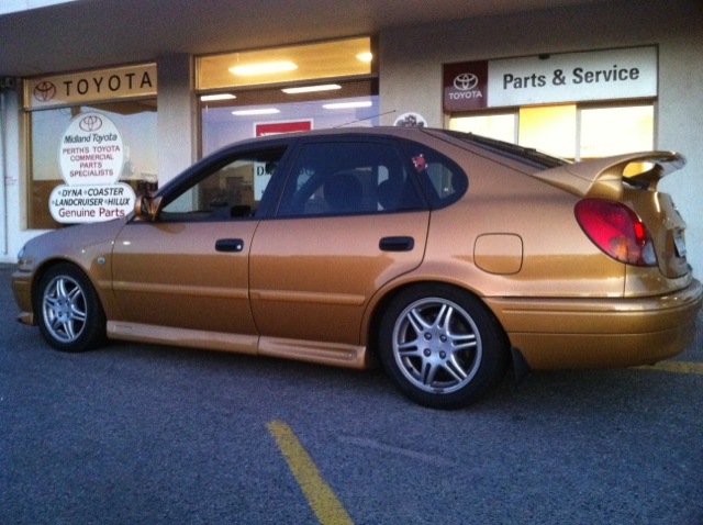

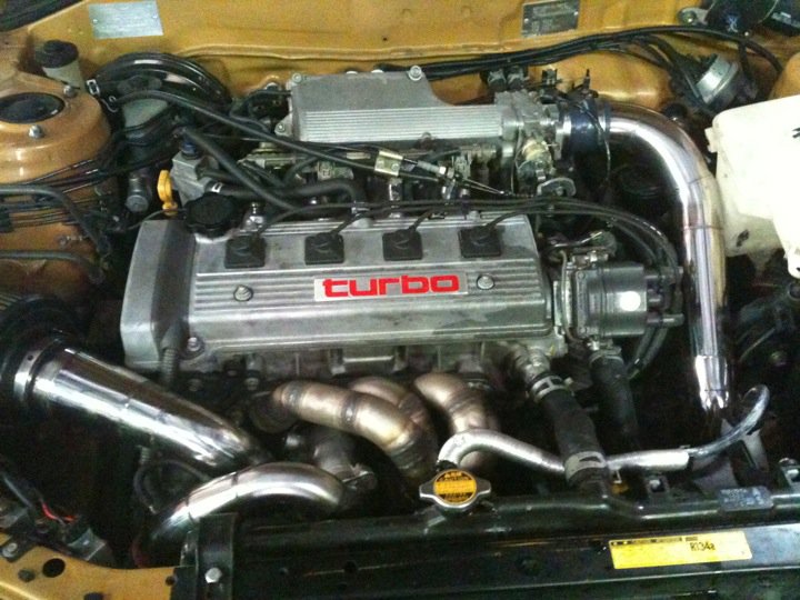

Hi all I'm Erin!
I'm new here. I am in Perth WA.
I drive a Corolla AE112 Sportivo (Limited Edition Turbo). I have owned this car for 2 years now, A little while ago the manifold split and my turbo blew up so it was time for upgrades!!!
MODS:
Coilovers
Turbo upgrade: Garrett T25/30
Custom pipe work
Custom manifold
2.5" Turbo Back Exhaust
Tint
Sound System

Howdy doo!
Well, I don't know anything about cars or car upgrades but I LIKE THE COLOUR!
Dumb question - the lights, are they green tinted, or is it just the way the picture makes them look?
And are those legal, because I thought they could get you pulled over o.o I saw a guy get pulled up for having a blue tint on his lights once. Personally, I am always momentarily blinded when someone drives past with lights like that :)

Hi Odin,
The colour is standard. All 110 Turbo Sportivo's came out only in that colour and only manual.
No the lights are not tinted green, its just the way the picture was taken. They are HID's bought off E-Bay. As to whether they are legal or not........ I haven't been pulled over yet so I dont know :)

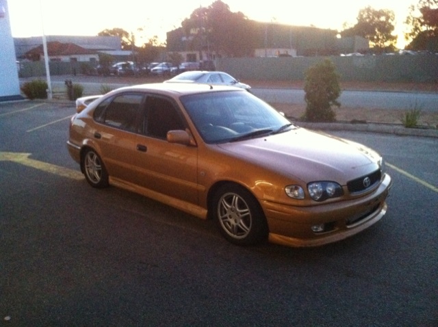

Here's another pic of the engine bay

Any ideas on the power the new turbo is putting down? Tidy piece of kit.

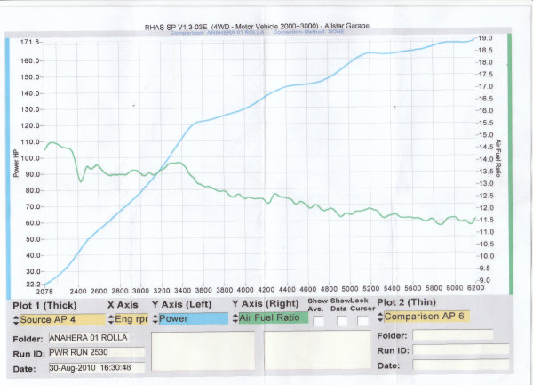

Here's the dyno chart:
I am only running the stock computer and 0.6bar
