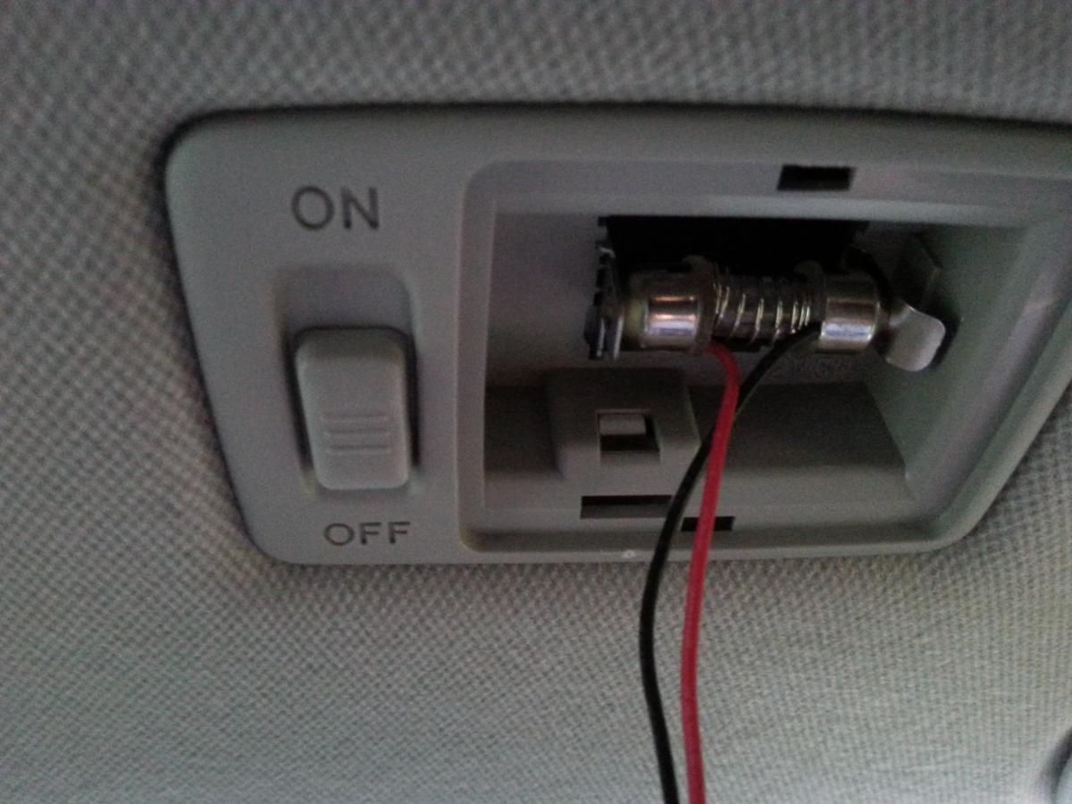

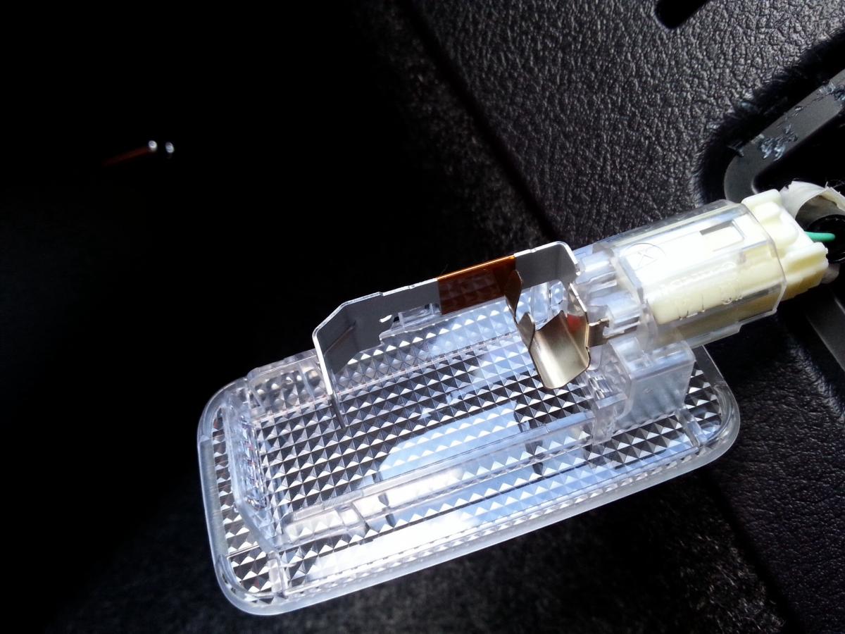

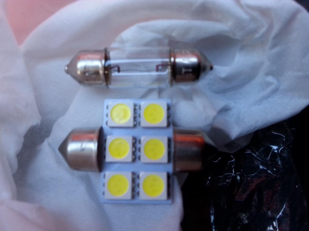

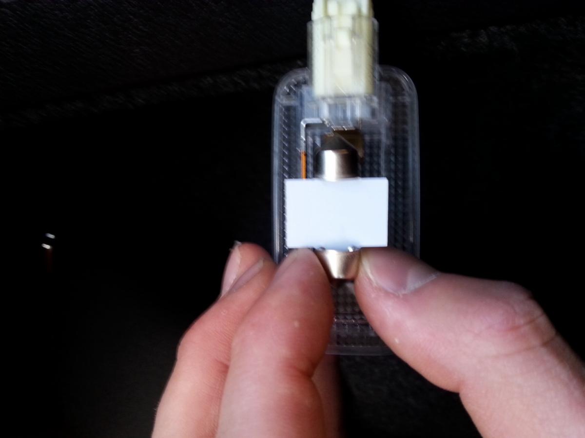

Hey Chris, apologies I haven't got back to you sooner on the interior LED kit, things have been hectic. Ive installed the number plate LEDs this morning and they fitted and work perfectly. Can't wait to see them tonight in the dark! I tried installing the cargo/boot LED but it actually does not fit. The OEM festoon is approx. 28mm long whereas the LED is approx 31mm long. The length probably isn't the problem that is preventing it from going in, rather the diameter of the end contacts are reasonably bigger than OEM which prevents it from fitting in. The square LED panel also clashes on the metal plate that runs alongside the festoon clamps. I tried installing the LED panel on an angle but it wouldn't go in. Have you got a similar LED except with a slimline LED panel which also has slightly smaller diameter tips and is slightly shorter? I've attached a few pics to help explain what I mean (sorry some might not be the best photos). I will try install the other interior LEDs next weekend, but looking at them I think they should fit no dramas. Looking fwd to getting them all installed :) will keep u posted and will put final pics up once I get them all in. Thanks again mate!
post-35721-0-72665500-1408854166_thumb.j
post-35721-0-23536300-1408854184_thumb.j
post-35721-0-04446900-1408854199_thumb.j
Thanks Craig,
exactly the information I needed. It's a SV7-8 festoon, didn't know that, and quite limited space around it for alternatives.
I'll talk to a few suppliers, but I may have to get this manufactured specifically.
Chris.

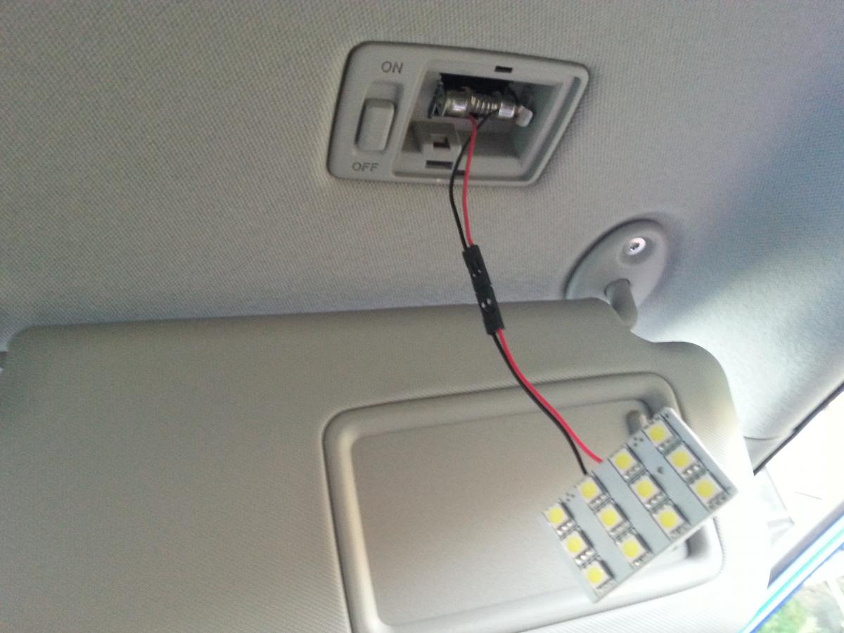

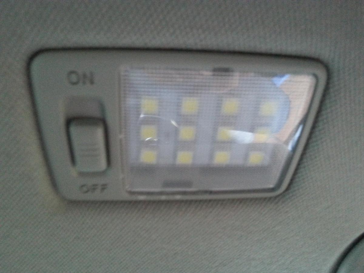

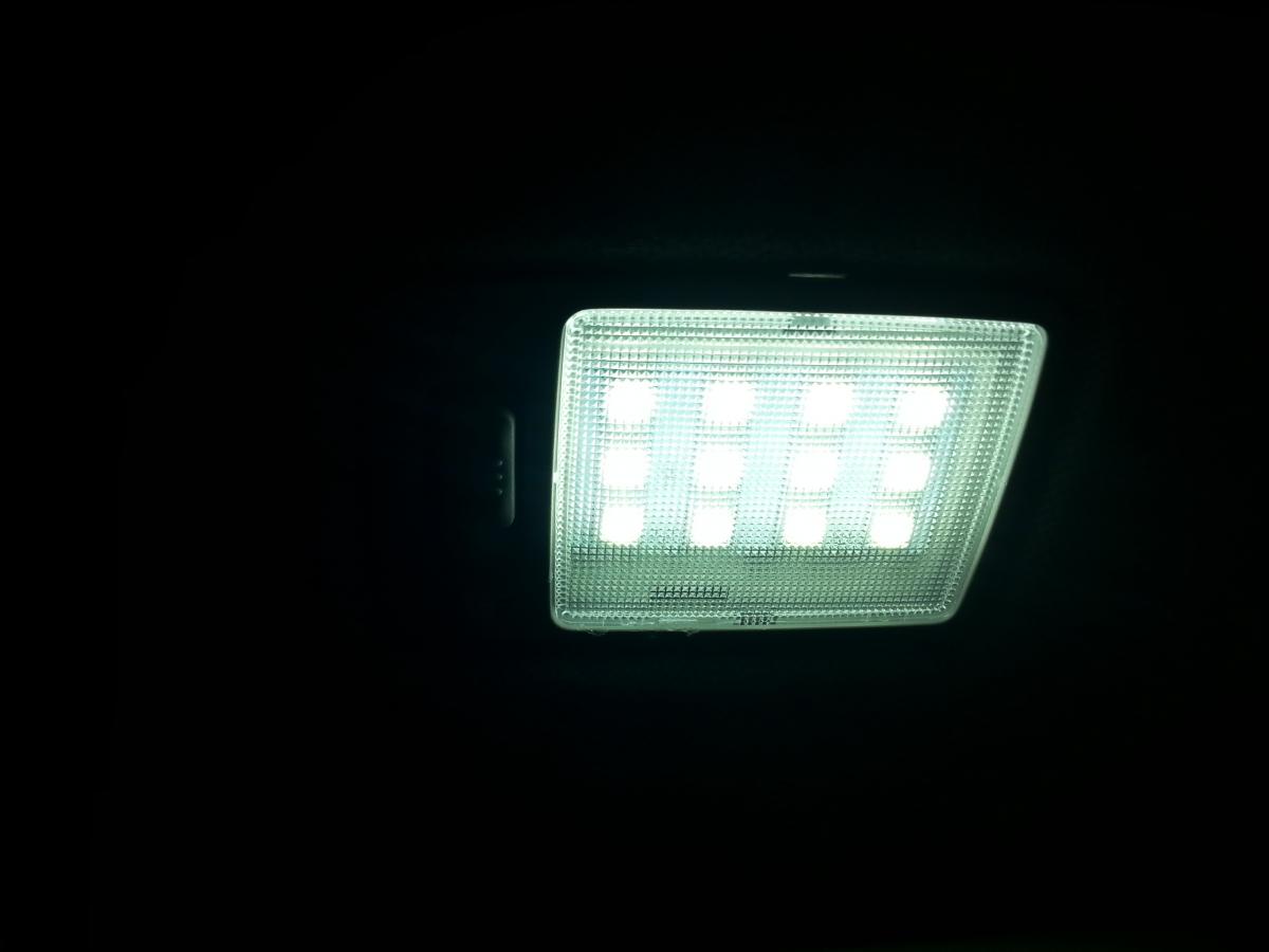

Ok I've finally got around to finishing off installing the interior light kit. They all fit and work perfectly (with exception of the boot light as mentioned above), thanks so much Chris!
My only comments on the vanity/sun-visor lights are that it is super bright for a light that you are almost looking directly at when looking in the mirror. It is also a pretty tight fit to get the panel in there, but it does fit :) I will post up a few photos of the vanity/sun-visor LED panel.
The dome interior lights are awesome! It is amazing how much brighter they are compared to OEM. It's like daytime when the interior LEDs are switched on at night.
