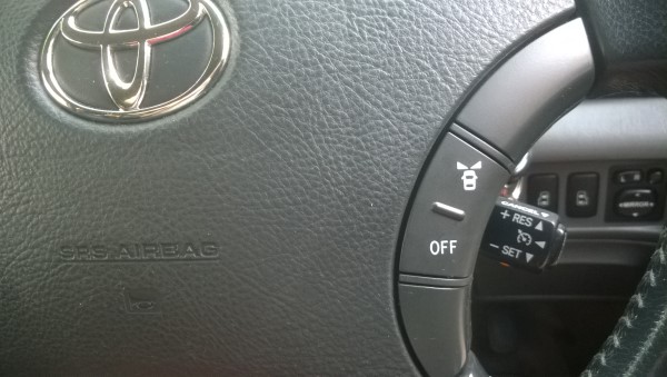

Hi there,
Just bought a 2004 Toyota Estima. Can anyone explain what the button on the right side of the steering wheel means? It has a picture of the car with two arrows pointing inwards at the front of the car. Also, are the manuals from www.jpnz.co.nz any good? Just checked and price is $62 incl p&h.
Thanks
That's for your front camera. When the button is pressed the camera should come on when you are in D and not going faster than about 20 Km/H. I got this feature on mine but it doesn't work for some reason. Still trying to figure out what's wrong.

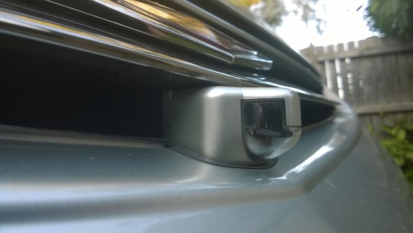

Well, there you go. Mine still has the original Japanese unit so it is nicely integrated with all the car's features. I'm leaning towards keeping it the way it is as it suits my needs quite well. A project for the future is to trace the fault of the front camera not working. All the equipment is there but it looks like there may be a bad connection somewhere.

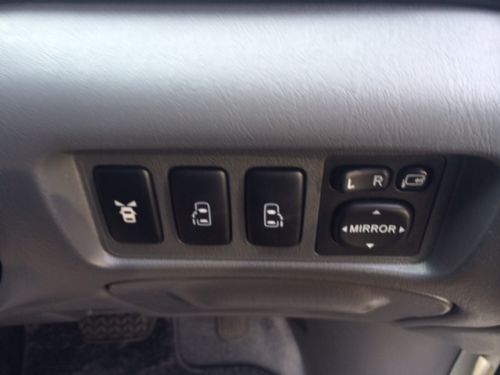

On the Japanese import Estima the button is typically located near the driver's right knee rather than on the steering wheel, next to the powerslide door and side mirror controls. I've attached a pic.
The front and rear cameras work well with the factory screen and just operate automatically at low speeds in forward and reverse, so it is a shame yours had had the head unit swapped as it's a very nice feature. I had a 2002 Caldina GT-4 with the same system, very handy for parking and at intersections with limited visibility.

Thanks for the response. I guess I have some kind of upgrade on my Estima as the button near the power door buttons is blanked off and instead I have the steering wheel buttons. I’m still working through the wiring to see if there is a loose contact somewhere. Everything behind the Head Unit seems OK. My bet is in the possibility that the front bumper has been removed at some stage and the wires to the camera have not been reconnected. Still investigating as time allows.
