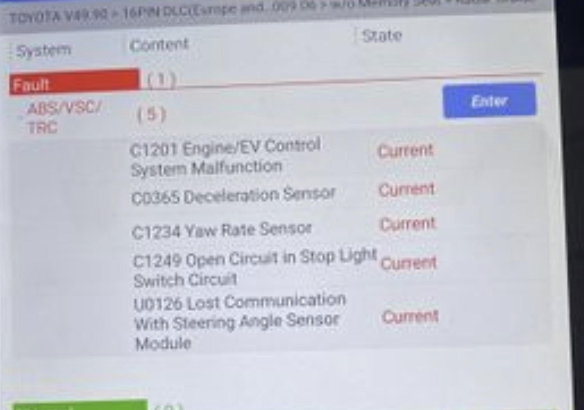

I've got a similar issue. The check engine light isn't on but running an obd2 sensor revealed the following codes. I did a google search but I'm fairly new to cars and just ended up being confused. It's also averaging 14L/100km which seems like a bit much. Also, does anyone know a reputable mechanic is Sydney?
